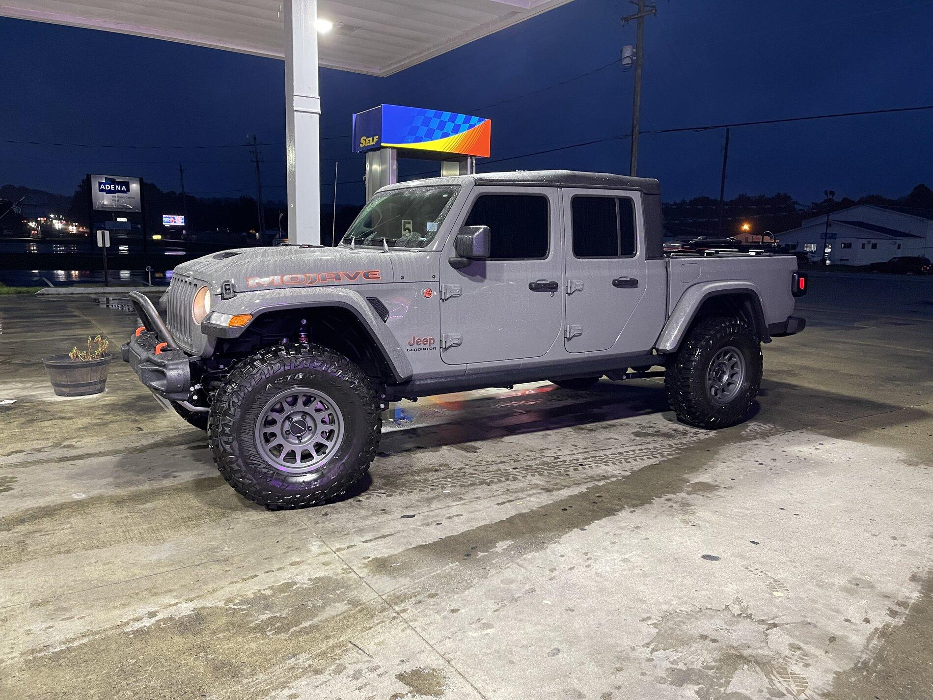

Just finished mine
37s with 2” AEV spacer lift
Holy hell that’s so good. What is your height to the top of the hardtop with this setup?! I’m guessing it’s about 4.5” of lift so around 77”?
