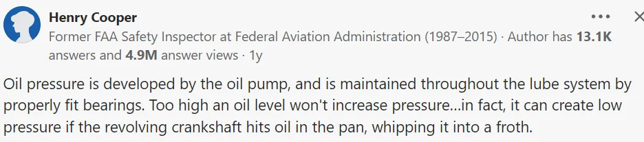

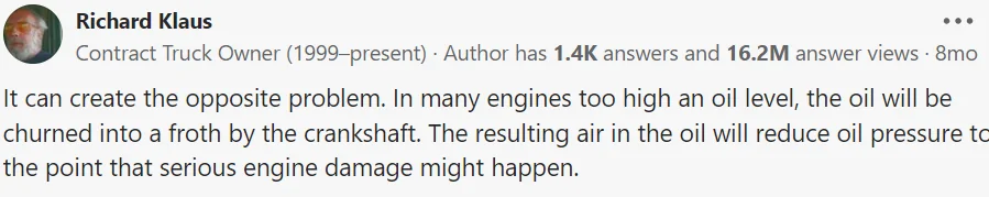

It's half wrong. You get LOWER oil pressure. The oil is aerated, the air is compressed, and pressure is LOWERED. So you have a lower volume of oil flowing through the galleries to the bearings, cam bearings, less to lube the followers (rockers) and so on.

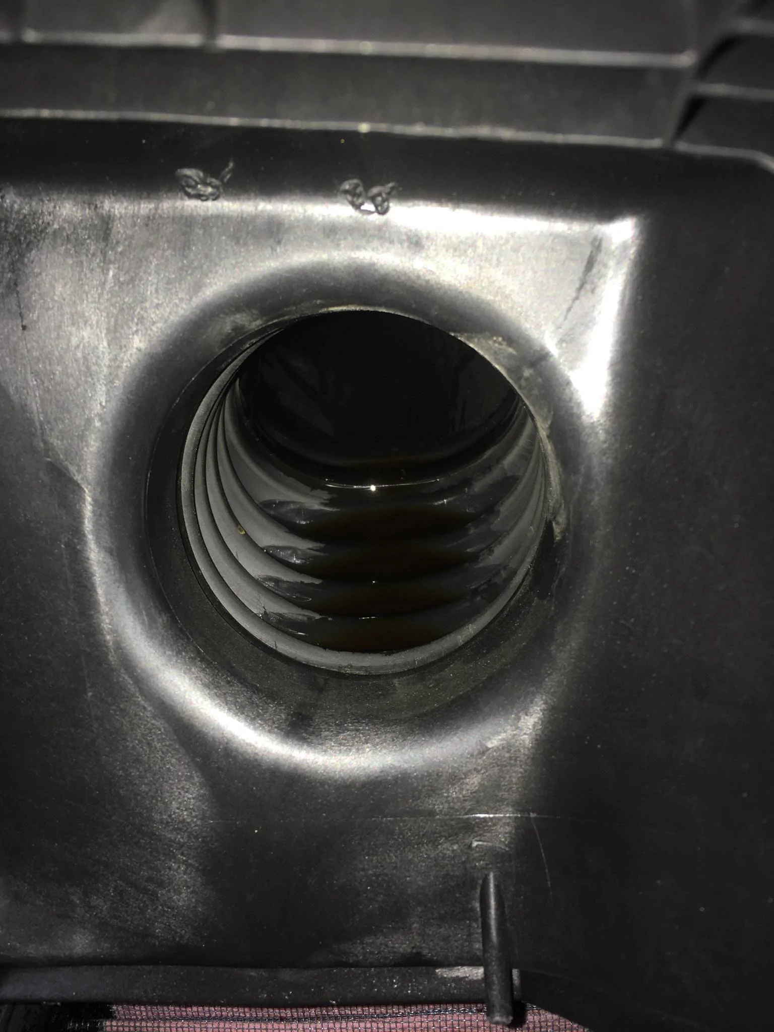

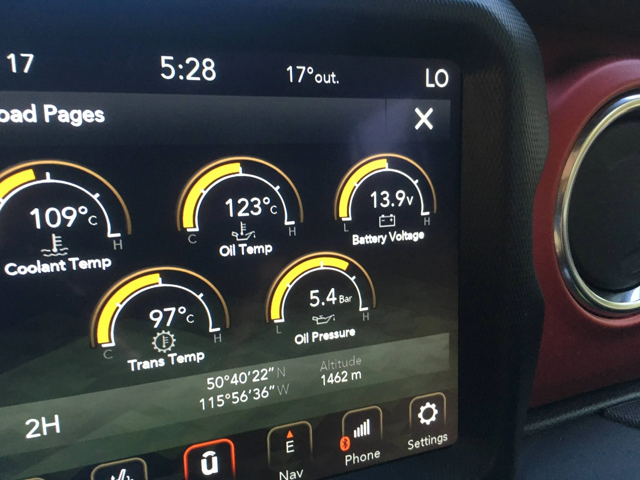

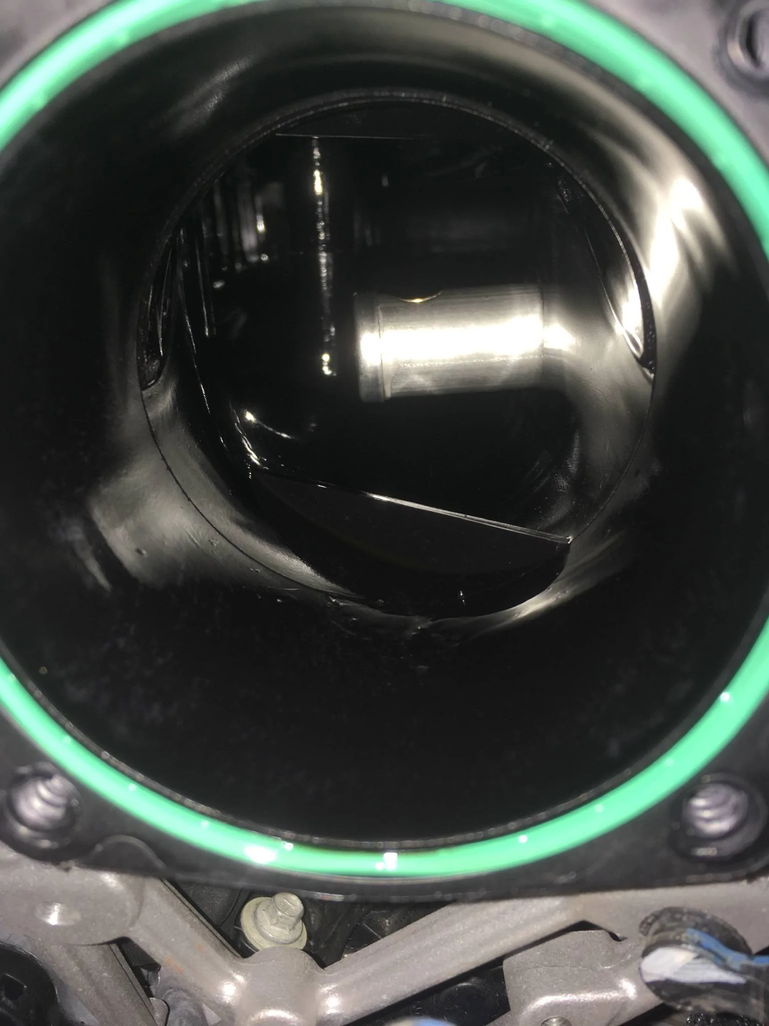

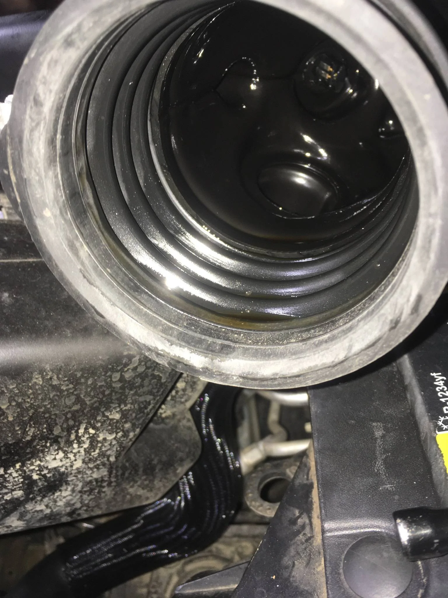

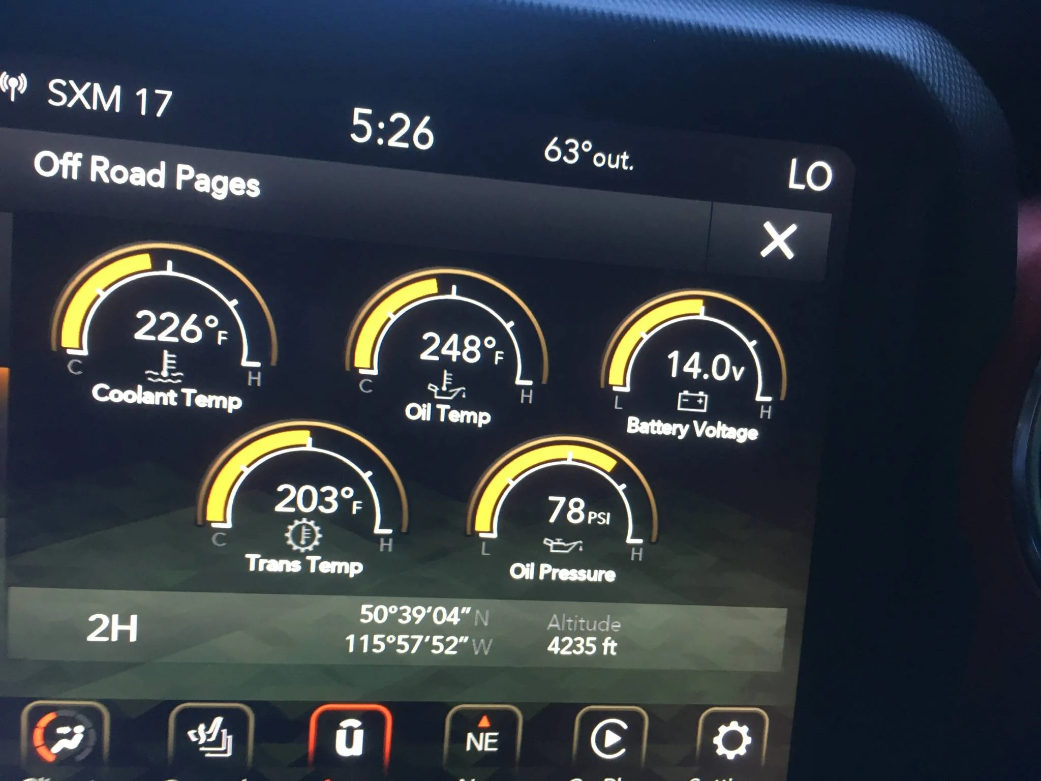

May I step in here to provide real world experience and photos of my new (2nd) engine and transmission I had installed end of November 2022. Engine was over filled and had 12 quarts in it and was then immediately put on the highway to BC and back to Calgary. I had to get out to the mine for one last weekend before season shut down.
The install was done over 3 days and work was checked by shop Forman and service manager.
The trip was around 1900k kms, summiting several mountain passes there and back and when I got home I did an oil change and sample for the lab. As some of you know, my first engine was consuming 10-12 ounces of coolant in 10k km period and FCA engineer, NORM had no problem with this, “it’s normal” I’m told.
Anyway, I’m coming back from BC and the engine is just running hotter than I’ve been used to and I call the service manager to inform him of the temps I’m seeing. Temps are high to me, pressure is strong. ??IDK, no alarm bells went off for the service manager and I kept my eye on it. It did feel under powered too.
I was burning no oil. Engine ran smooth and quiet.

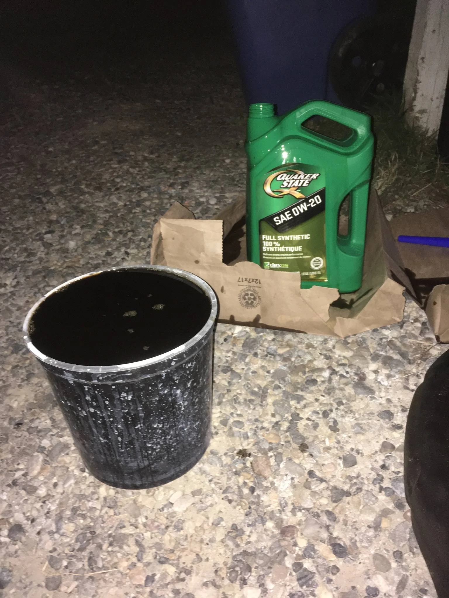

Then I got home, drained the oil and shit my pants! The oil just kept pouring out!! WHAT THE F@$k!!!?? The catch pan almost overfilled!
I poured out 12 quarts and called the service manager at home and showed him photos.

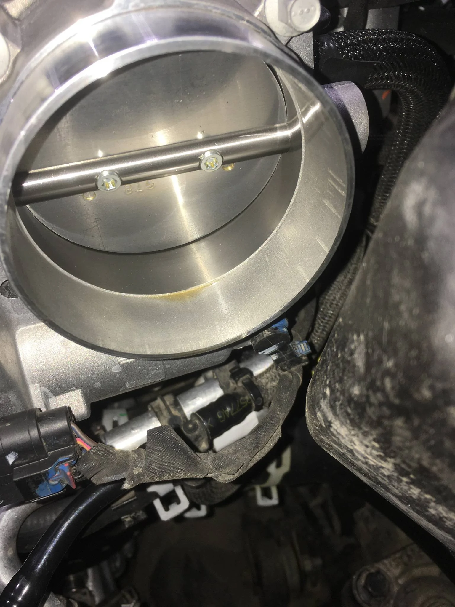

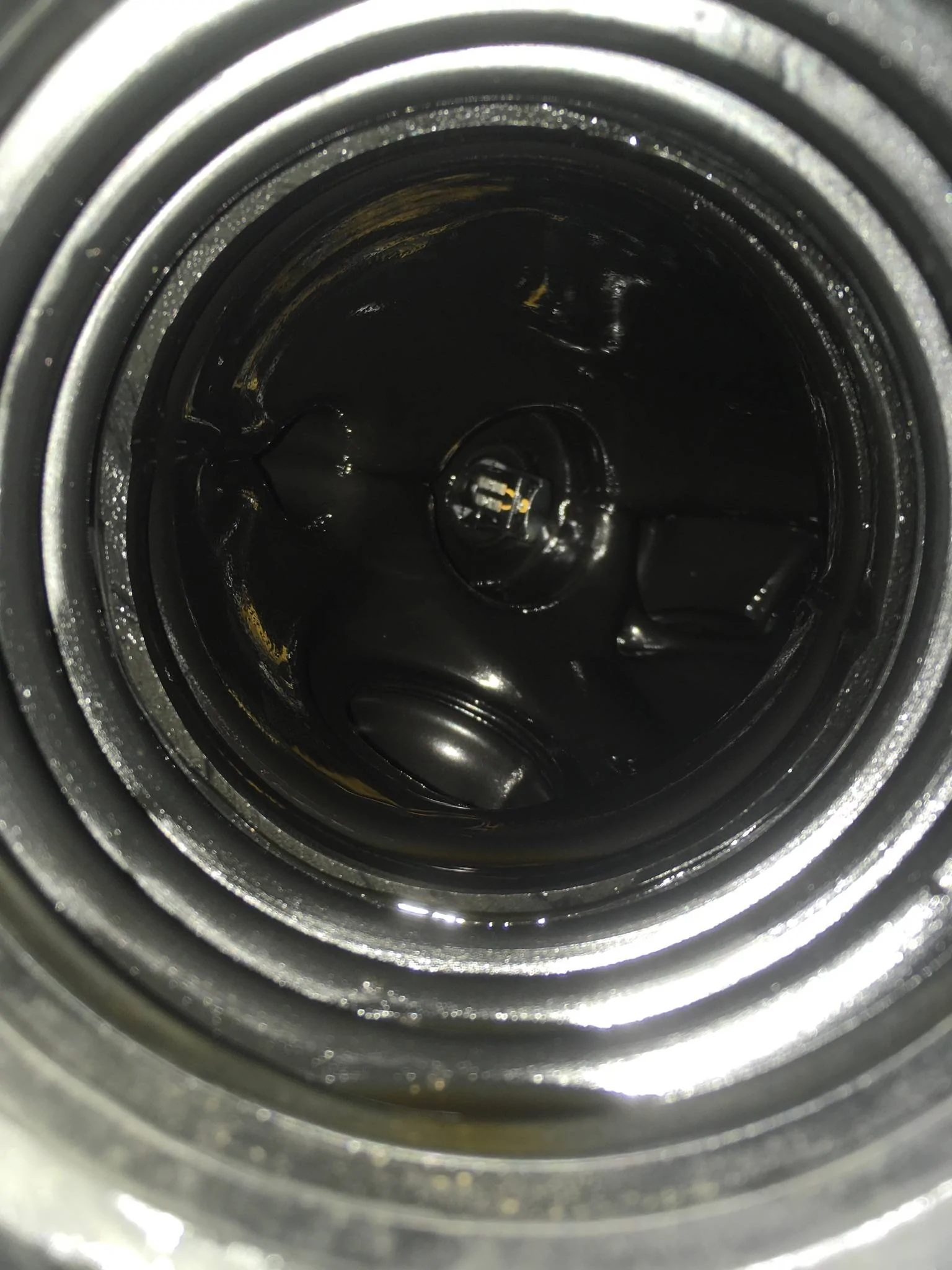

I took off the air box and air tube to the throttle body and took photos. Everything was swimming in oil. MAF sensor soaked. I was devastated and truck went in the next morning and had the intake, coils, plugs taken off and cleaned or replaced.
Tech made the error of assuming the crate engine was dry. It actually came filled, too full I assuming- 6 quarts from the assembly plant. Tech and assembly plant can argue who put in what but 12 came out. Tech said the stick looked good when he filled it. ??? Lots of questions ….
The gauge photo is during the trip coming home heading up a steep mountain pass at Radium, BC.
I’ve put on 12k kms since the install. For the next 10k that followed, I changed the oil every 1600-1800k and had lab samples done. I cut open all my oil filters and examined. Engine is great. Lab samples are great. This has been the best running engine I’ve had in a very long time.
Does this case win a prize?

I had stopped the oil flowing toward the intake runners just in time. Like i said, it wasn’t burning oil that I saw or smelled. Heres to doing an early first oil change. I normally do that at 1000k km but the trip extended that to 1900 k
One more point to make. I also have no Blowby. Engine running cold or hot, pull oil cap and no air blow out. Did I stumble on to something good from this experience?
I remember that - mine still hasn't budged since the initial drop in the first month or so. It's now settled to the point it's not dropping visibly. almost 9,000 miles and it's gone down maybe 2 or 3 ounces or so since I first saw the truck.
My 2020 went through 8 ounces from the time it was brand new to 27,000 miles. Most of that was in the first few thousand.
The coolant temp doesn't bother me a bit - I see that even on cooler days. It's almost as if it's trying to balance something out and now and then runs over 220, then drops back down to the 190s. My coolant temps bounce around a lot. 195 to 220 even a bit higher.
I don't care for your oil temperatures if that's not a hot day and you aren't towing.
Oil in the intake of course as you know - when it's too full oil is flung around everywhere and now you have air in the crankcase that's like someone took a sprayer and kept spraying oil mist into the air. The PCV tries to evacuate the air and gets all that oil with it. To me that's one if the bigger nasty side effects of WAY too much oil (talking more than a quart over-full) - all of the oil mist ni the air in the crankcase. It's going to get into the intake via the PCV. I bet you'd have filled a catch can in a few hundred miles - or less!
Not sure what RPM you were running at to see the OP over 70. Mine will run over 70 a lot around here when it's cool or cold and I'm on the highway (because mine will run 3,000 rpm or more around here in the hills, the wind, and cold weather) so I see pressures up there.

Underpowered I can see for sure - you have that crankshaft having to whip through oil and not air. Imagine rowing a boat - the deeper your oars are in the water, the harder you work. Pull them up half out of the water, a lot easier.
