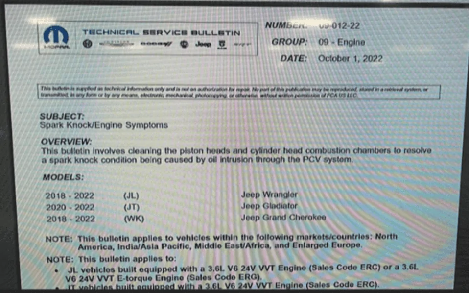

Here's the full TSB -

Huh, that's an interesting tsb. Probably the one the service writer told me the tech found about my El knocko, of course this doesn't address metal shavings visibly present ? in the oil. Still quite interesting that the pcv system would allow oil injestion
Yeah, obviously yours is unrelated.
Luckily the PCV on this is normally quite good.
But these are only as good as those who work on them..........

Tell them to check the PCV system -
It may be CONSUMING it, not leaking it.
