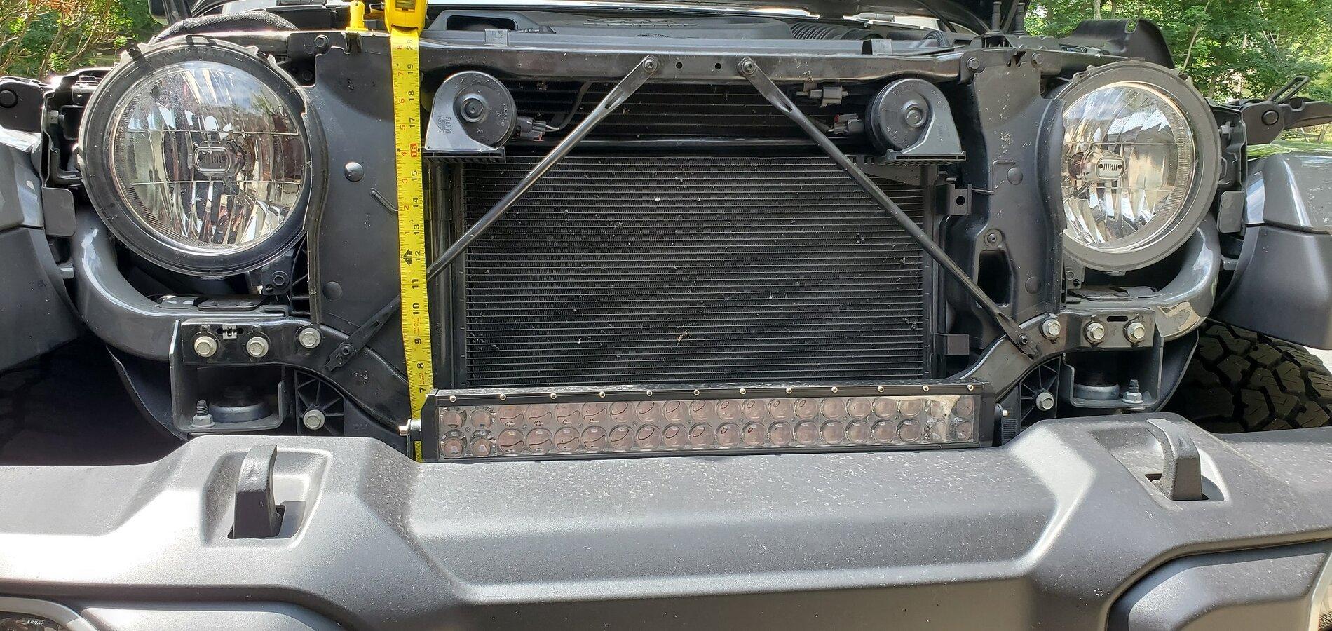

I looked at those but went with this.

Would definitely like to have this type of set up. Planning to tow some with mine.
Wonder if this would fit in or under the factory bumper

Glad_he_ate

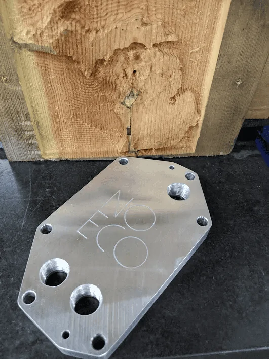

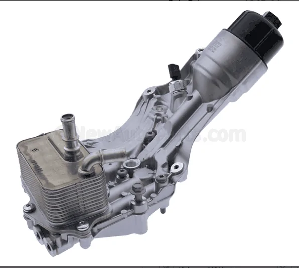

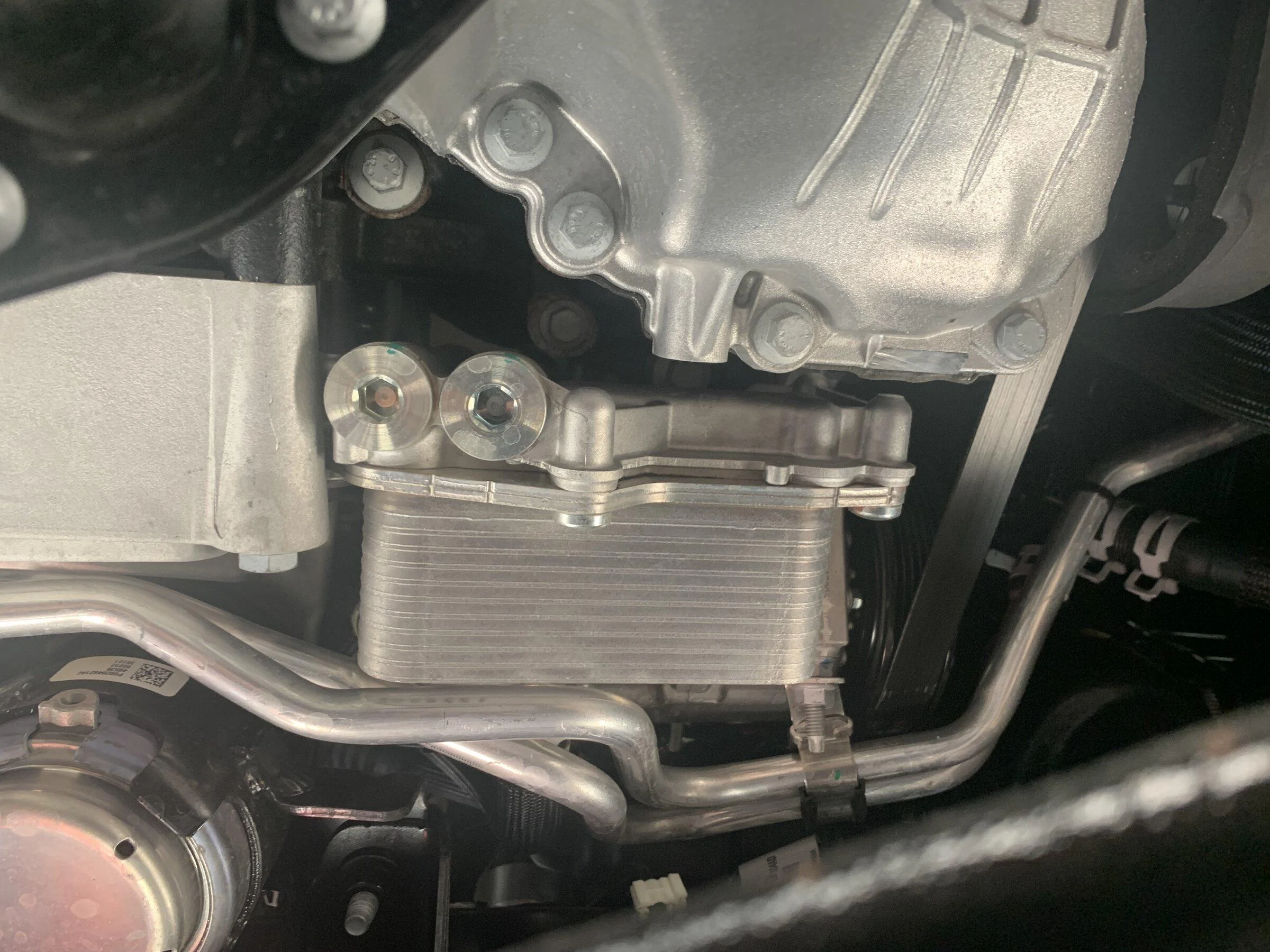

Was looking under the JT and see the two bungs that are at the bottom of the oil filter/cooler assembly. Think someone asked this question somewhere in the 30+ pages, but can those be used to run the external cooler like @Glad_he_ate did, but without using the insane diesel bypass set up?
From the part pic it looks like the bungs align to the oil line channels in the body. Might buy the whole assembly and look at what is going on there.
Not my expertise so maybe an engineer on her can weigh in if it might be possible.
Engine Oil Filter Housing - Mopar (68566093AA)

Would you still need the plate?
That adapter plate replaces the factory water to oil cooler. The 2 big holes are oil out and oil in. The smaller hole, I don't know yet.

I agree with this 100 percent. If I were actually having derate issues I’d me mad. Really mad. Don’t get me wrong I put probably 1500 into solving an issue that should not have been an issue and actually for me was not a real issue. For what it’s worth my cooling setup worked as well as I could hope. However I might down the line still add a cerc pump tapped off the pan. I can guarantee that if I draw oil from the pan cool it and return it to the filler neck I can keep the oil at or below 215. But I didn’t get above 240 in my trip from ny to sc. and didn’t have any issues holding speed. Still this could and should have been addressed in preproduction r&d idk why they went with that oil to coolant system instead of an air oil cooler. I would imagine that one more small radiator would have been cheaper and more efficient at cooling the oil. There is room for one obviously as I installed one lol. However I still am not done. My install guy should have flipped the cooler. He has it sucking from the bottom and blowing toward the trim piece behind the bumper. I would have preferred to have it pull air down from behind the bumper after removing trim piece. And when I have more time that’s probably how it’ll end up. If I decide to add a cerc pump I’ll post that up in my bypass filter thread.
