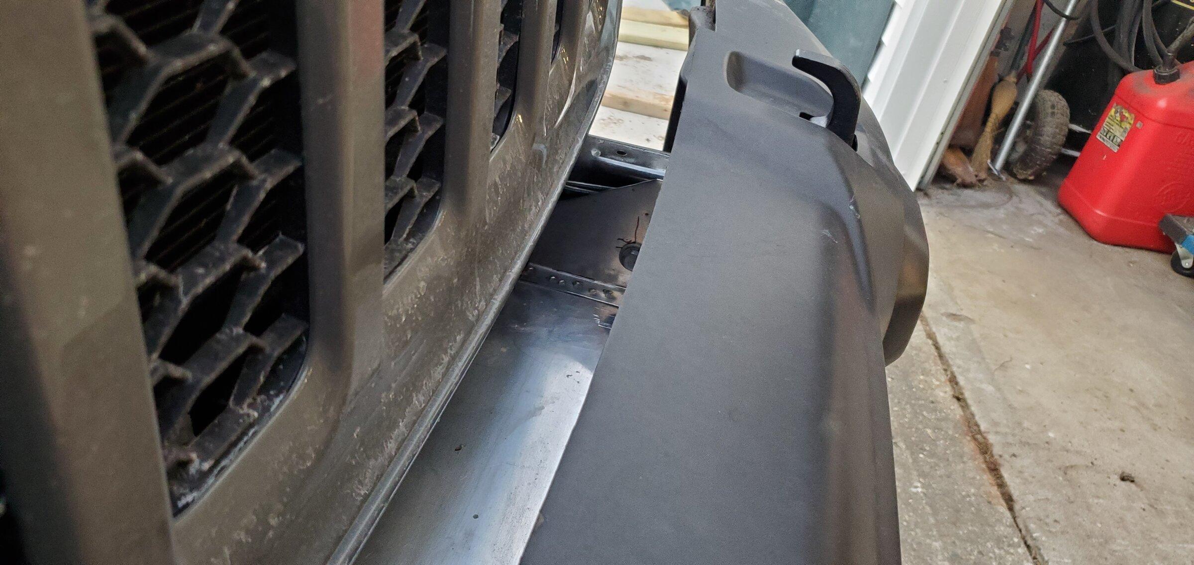

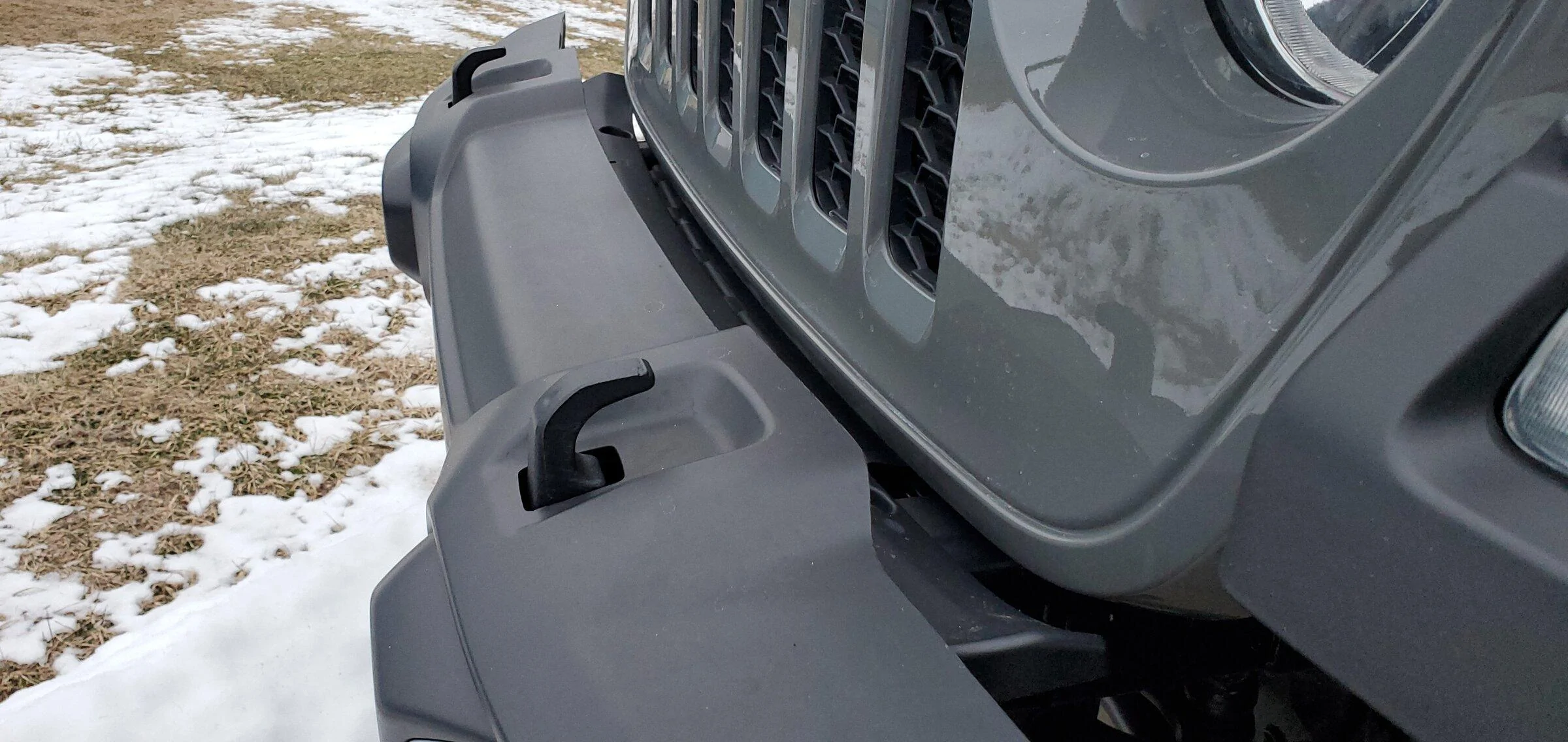

Yes. I trimmed mine as pictured, along with the mentioned SB scoops:
i did about 3/4, left the flap towards the front, to deflect any heavy rain potential intrusion when driving

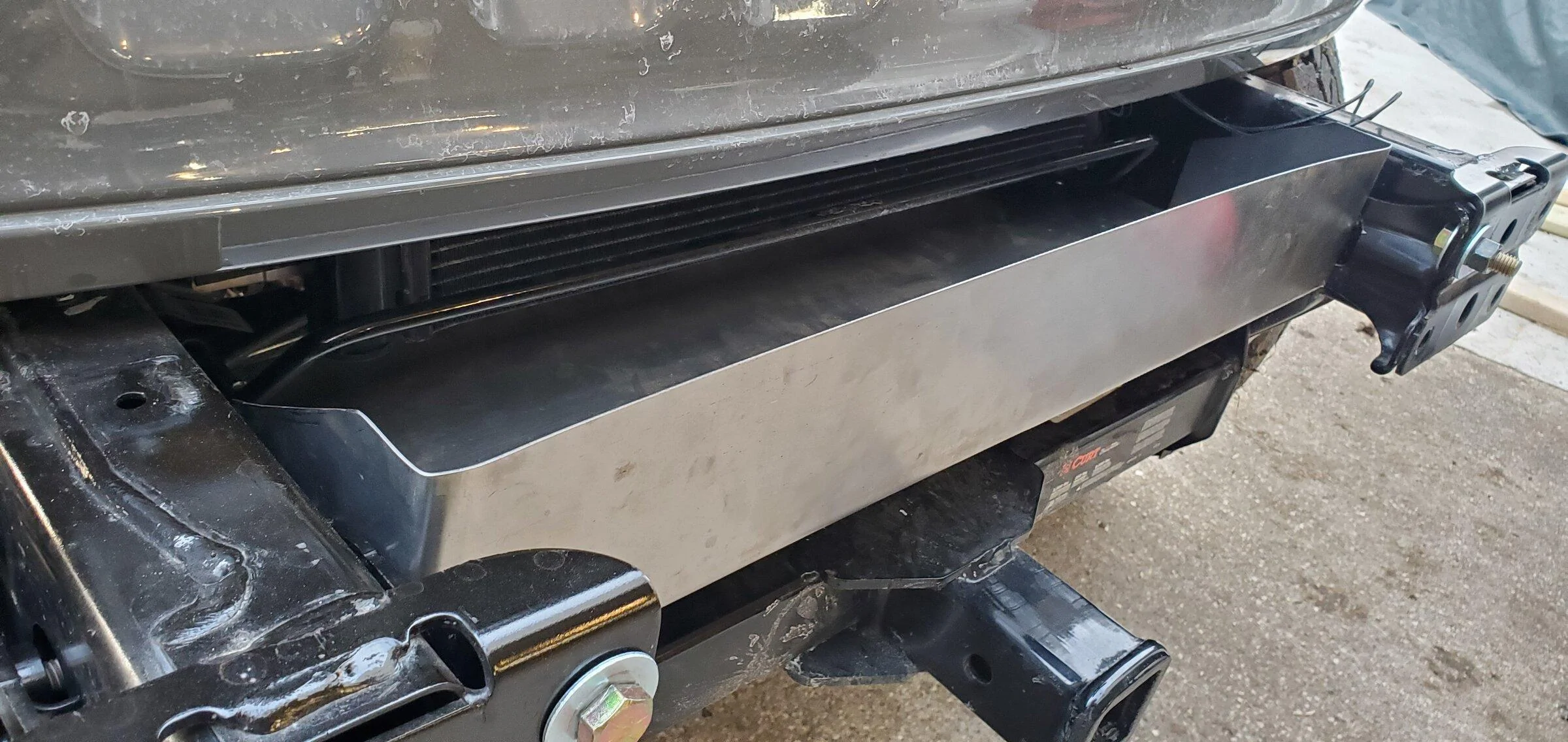

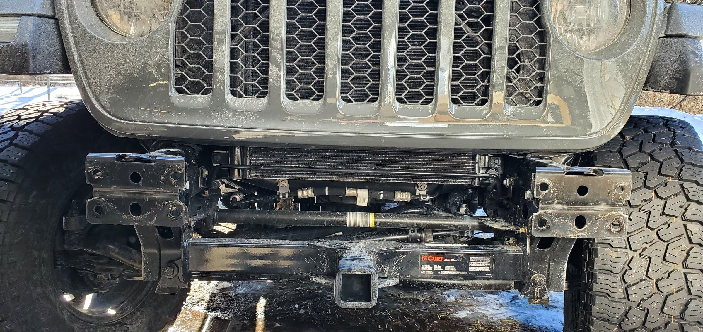

Good news, I found some more radiator! LoL
Tucked nicely behind the bumper and blocked from any path of flow. I removed the plastic trim behind the bumper and I am adding a metal pan that will allow the air pressure/flow in front of the grill to also hit this hidden section of radiator. I will be testing the temp of the this lower radiator section with thermocouples to verify any improvements.
Updated: I installed the diverter pan and my quick and dirty test showed it lowered engine coolant temp by 8 ish degrees and engine oil temp by nothing while towing my enclosed trailer at 70mph. I still need to add a thermocouple to the lower section and test with and without the air flow to check the temperature differential.
