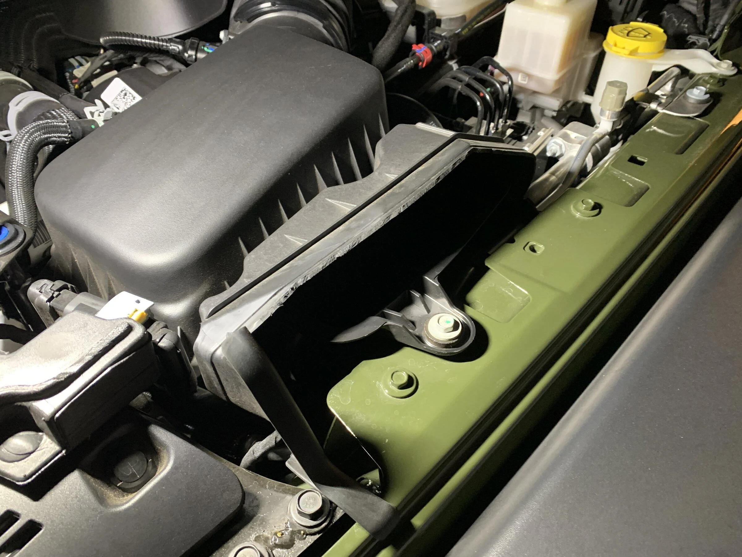

Yes. I trimmed mine as pictured, along with the mentioned SB scoops:
Doesn't make nuch sense to suck through that tiny hole lower in the airbox when they have this massive availability.

Hi Guys, I just noticed 1979Wagoneers post on his intake boot mod. I have done the same thing but for a different reason, same result though. My airbox was filling up with ice and snow during snow storms. Happened driving and also if the truck was parked into the wind. You notice a significant decrease in power. I pulled mine into the garage and low and behold the lower air box FULL of snow and Ice!! Cut the tube that pulls air from the right hand grill and then removed material from top inlet. You can feel the engine breath better and yesterday and today in huge snowstorm no snow and ice in the lower airbox. FCA Engineers, I thought you had severe weather tested our trucks. Cold is not severe weather, cold and wind and blowing snow is. NUFF Said!

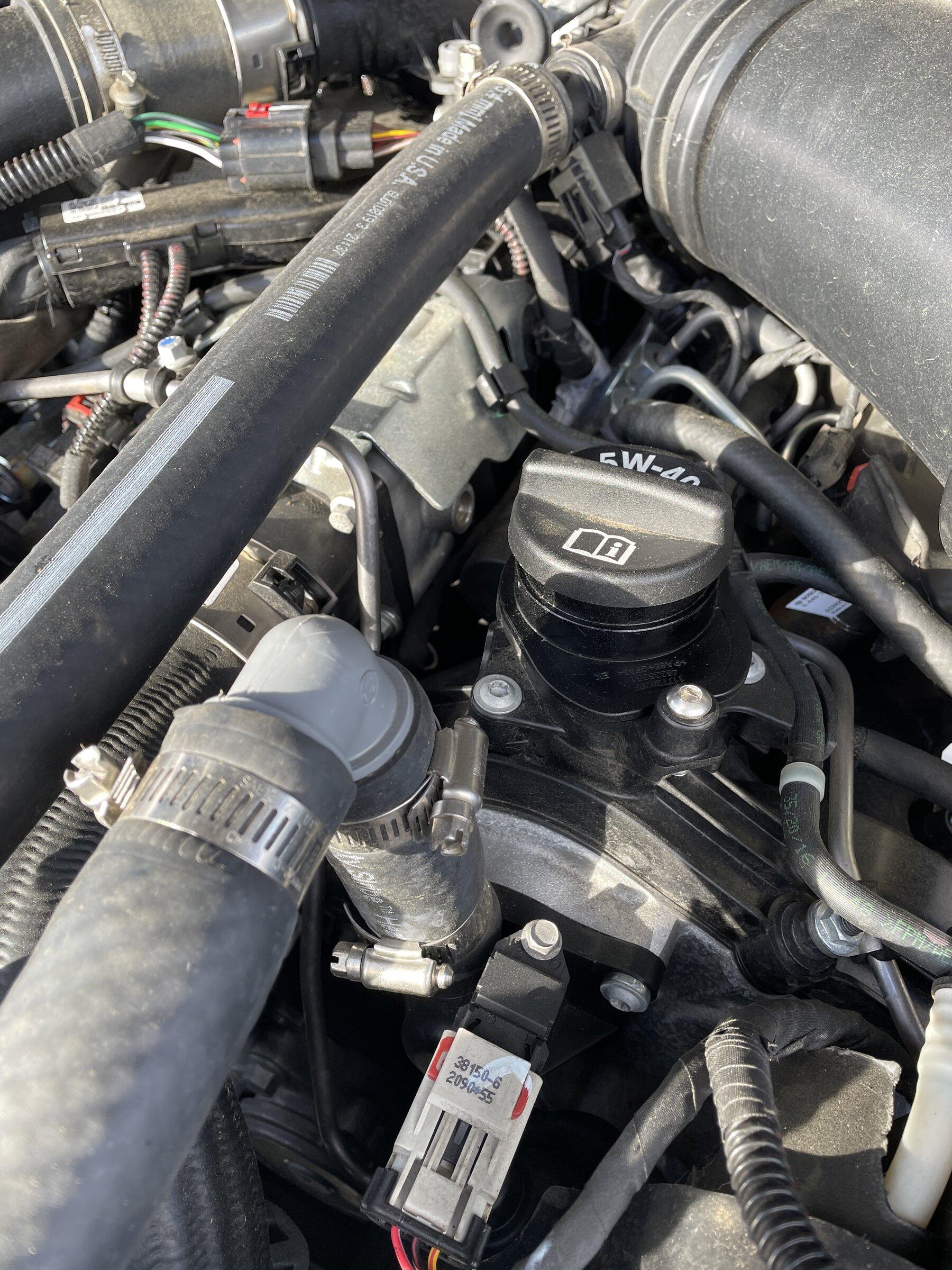

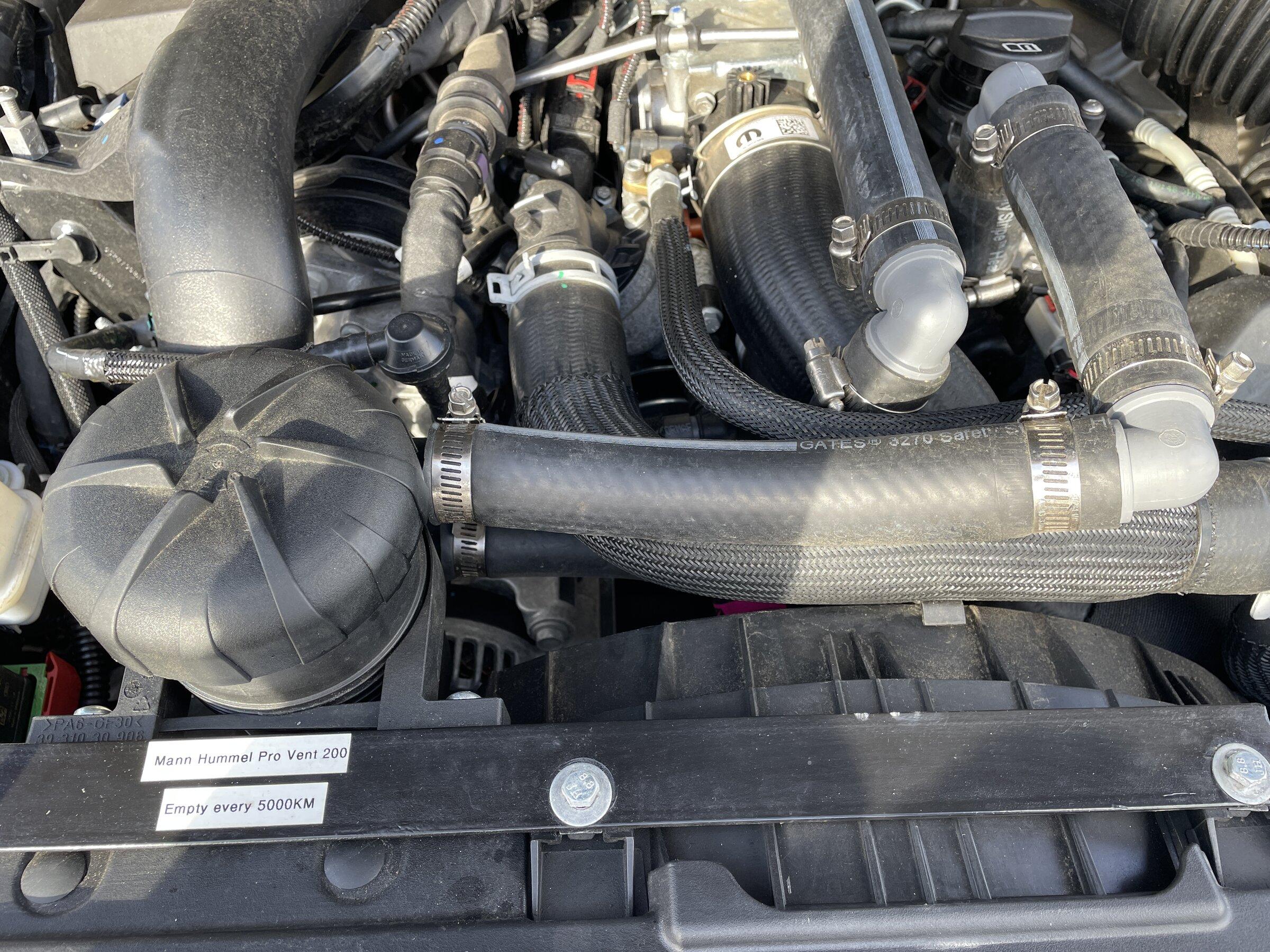

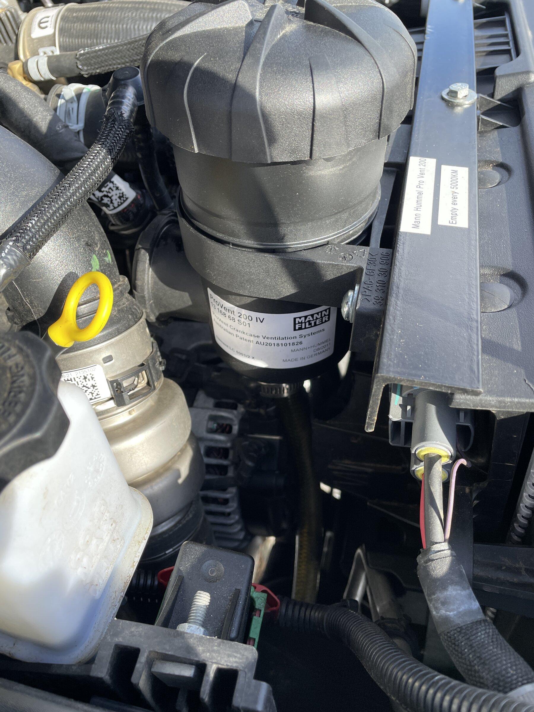

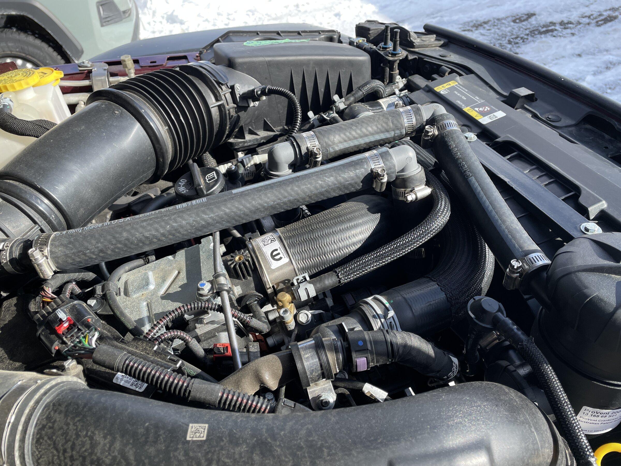

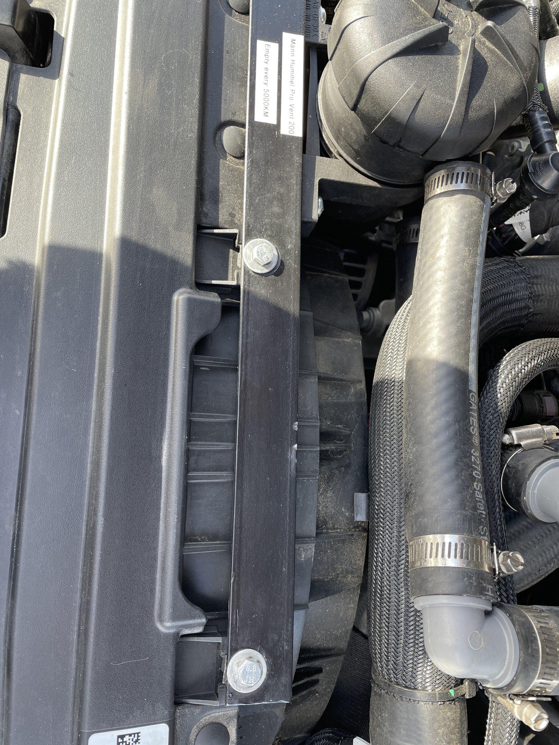

Hi guys, today is cold and clear so I took a few photos of the Pro-Vent Catch Can installation. And on the same topic about MIL's. Yes the truck runs most of the time with a MIL on. I run a Blue Driver through my phone and iPad and monitor my trucks vitals. With the Pro-Vent system the engine thinks its CCV is either disconnected or blowing to atmosphere. Have spoken the techs and they won't do anything, said they cannot "modify FCA parameters".Very odd that the computer will not reset itself seeing that the CCV is a closed loop from the Centrifical Oil Separator to the intake pipe. So I and they clear the MIL and I drive for 500km and the MIL comes back on. I would rather catch the crud than worry about a MIL on the dash. I will one day include a picture of my "jar of crud" that did not enter my intake system, turbo, and manifold, and combustion chambers.

The tubing is 1 inch I/D automotive hose. The elbows and straights are 1 inch PVC fittings and the clamps are clamps. The drain out the bottom of the Pro-Vent is 1/2 inch reinforced clear hose with a valve 10 inches from the bottom and then another dangling below it. I just crawl under and drain into a glass jar.

I used existing bolts on the top of the rad that were not used by Jeep for some reason, very convienient for us. The Pro-Vent is mounted on a piece of 1 inch by 1 inch "L" angle. The piece of angle over the rad has an ARCH cut/ground into the bottom to match the shape of the top of the rad shroud. Drill holes into the other side of the angle to mount the Pro-Vent clamp. be aware of the height of your hood. I kept the top tubes out of the Pro-Vent on the same plane as the one that comes off the engine. The tube to remove is the one from the front of the right hand cylinder head with the Centrifical Oil Seperater and it runs about 14 inches to the intake pipe.
