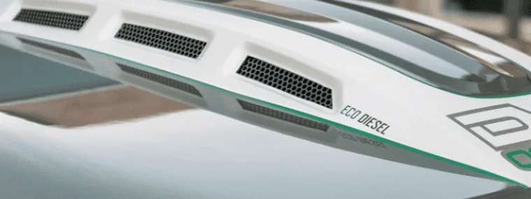

Anyone try this...?
https://dv8offroad.com/collections/jeep-jt-hoods/products/dv8-heat-hood-jeep-jl-hdmjl-01
Site says compatible with JT.
Says not compatible with Mojave or 392 models, but doesn't specifically exclude ecodiesel.
Would like to see someone in a hot, hilly climate (anyone in AZ ?) try it out and give us some real world results.
If anything might provide an expanded spot for the guys looking to place a secondary oil cooler.
And it does look pretty bad a$$. I've seen one on a JL gasser in a San Diego dealership. Also on SEMA videos.

Looks like it should work on the diesel. Might make room for an oil cooler or something up top with that extra rise in the hood.

I'm not too interested in changing my hood out, BUT like PJZ mentioned.....that could give us a potential mounting location that wont get hit by rocks! Of course some people might lose their shit having to leave the engine cover off? ?
Wont' fit 392 or Mojave because they have a taller cowl than the rest of us do.

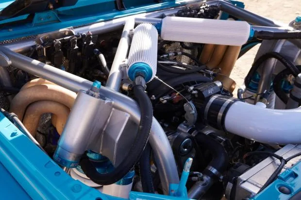

I was thinking going this route once my b2b warranty is up. Would install some of these oil coolers maybe with fans, if needed....
Jeep Gladiator Diesel cooling options and ideas 34CC9917-3827-405F-8037-5F5A4DBF3954
11,442
30,503
Ahhhhhhhh............those are remote reservoirs for King shocks.
My bad on that, but there are coolers shaped that way and that’s the only pic I could find quickly
You're thinking about a heat sink style.
