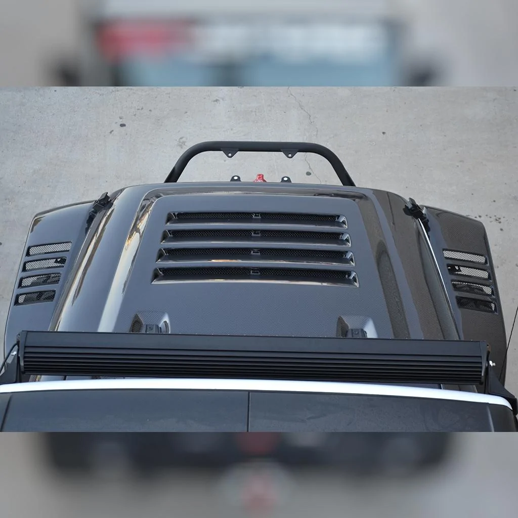

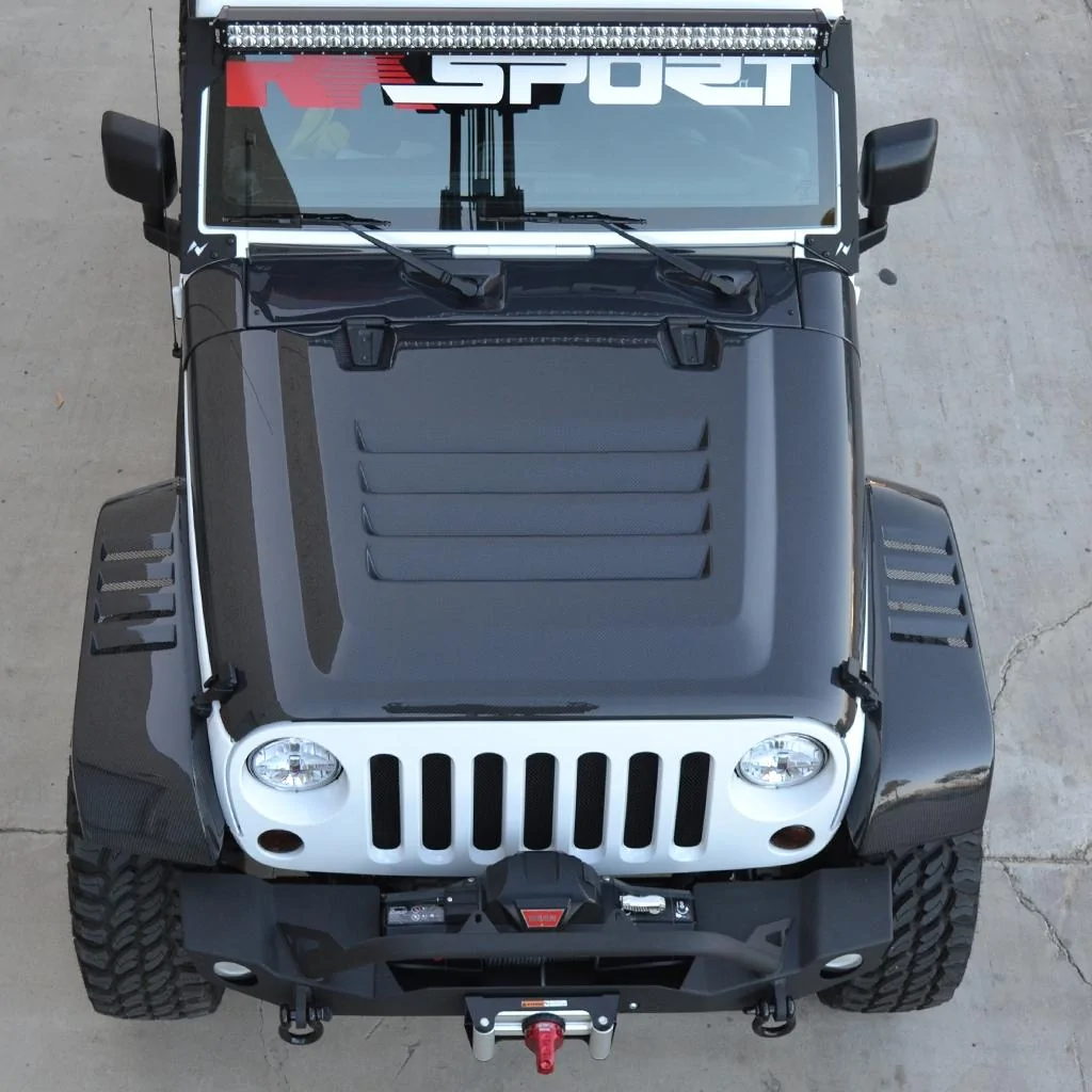

I'm not feeling the love for it.
Yea I'm curious about the thermals in this. I can get over the ugliness if it's functional.
11,346
30,237
I liked the first posted better.
