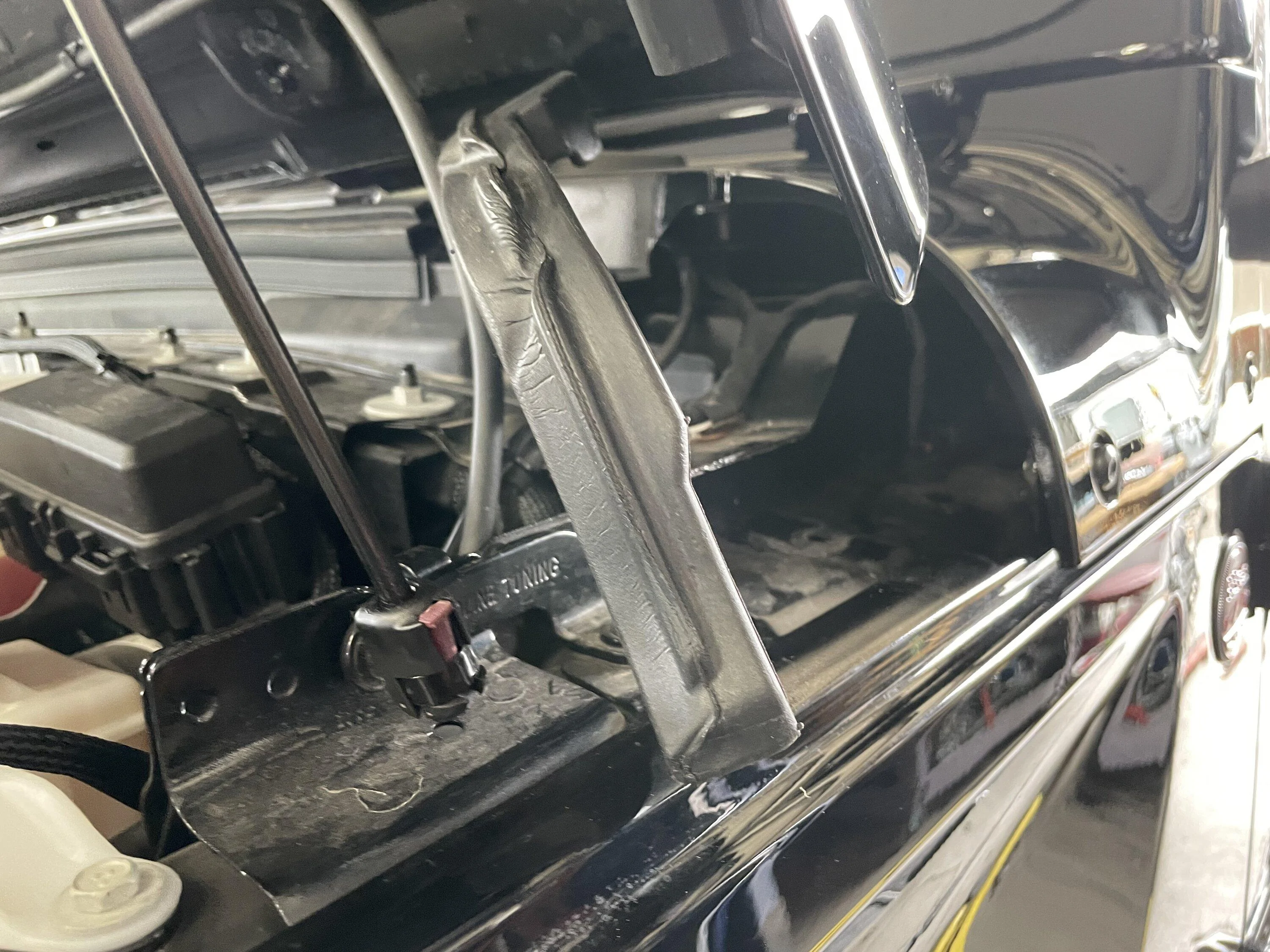

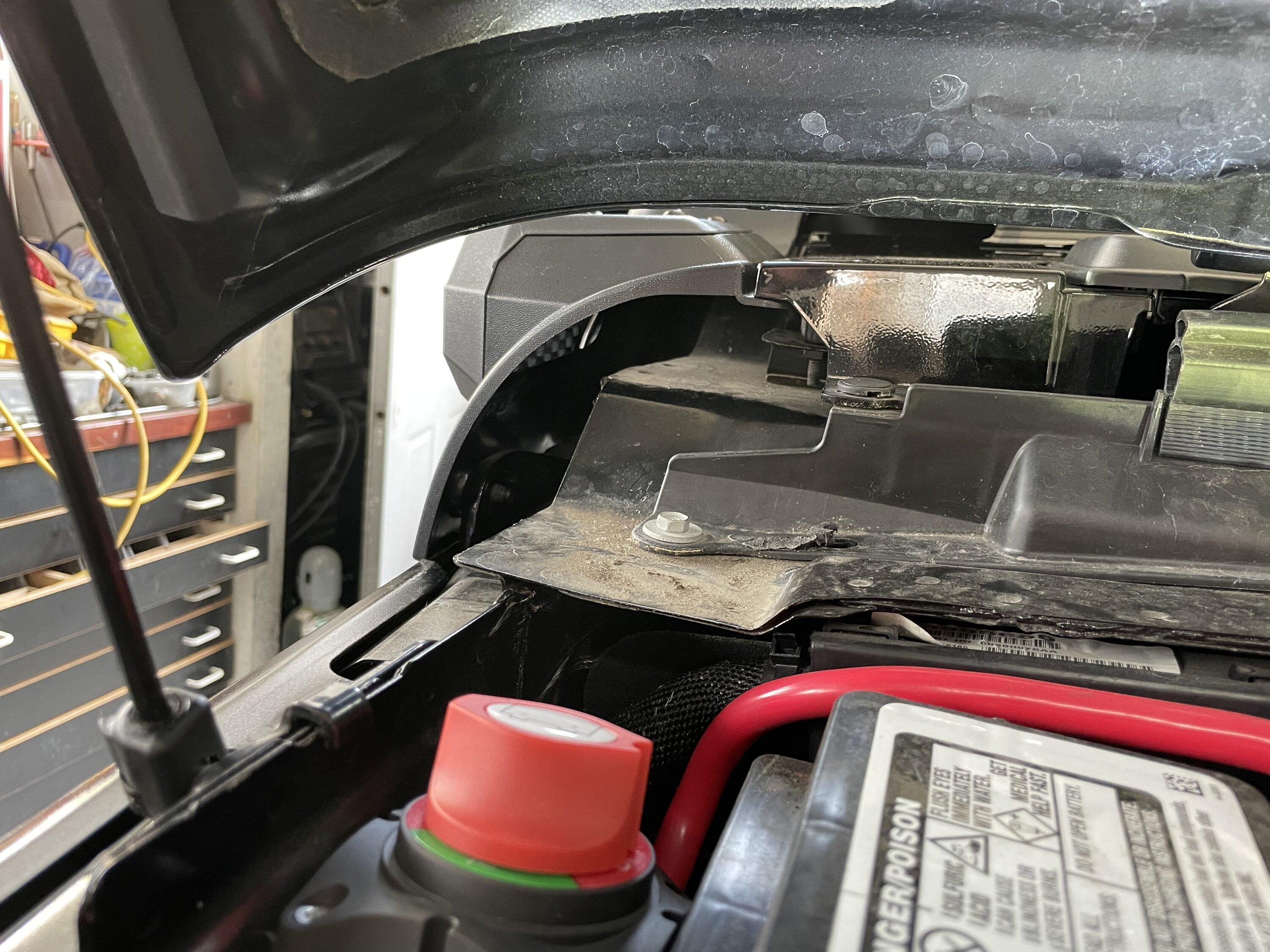

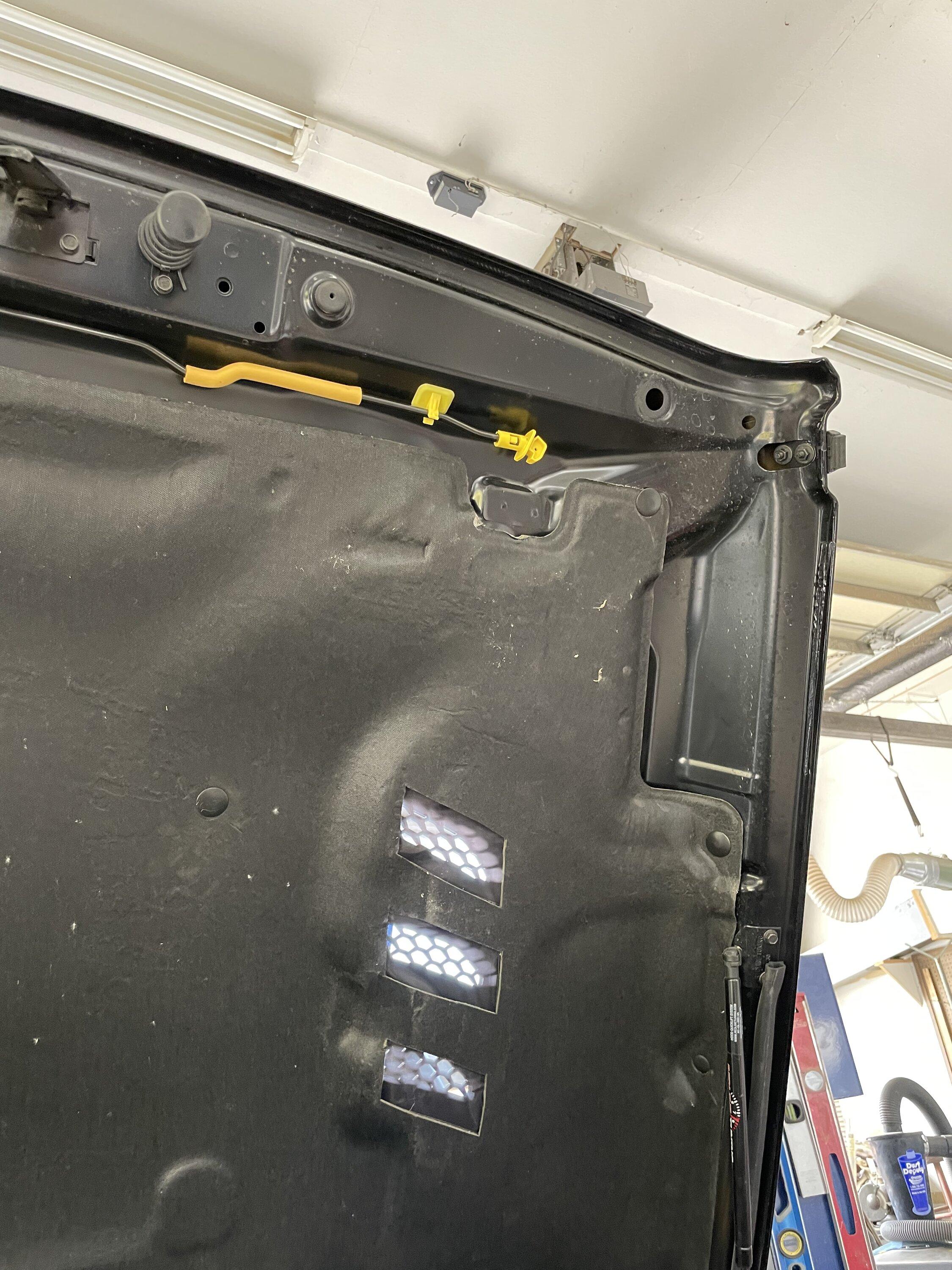

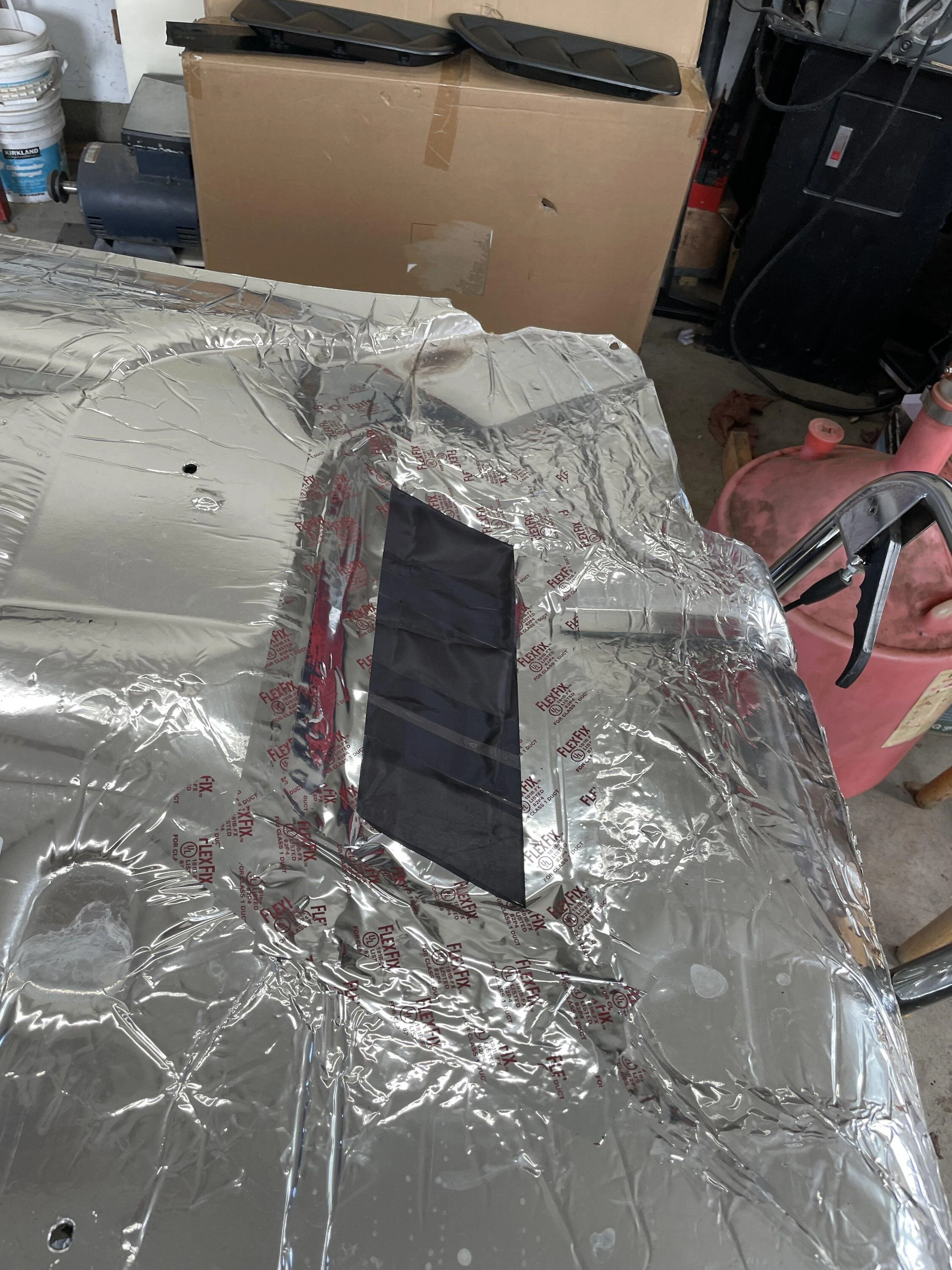

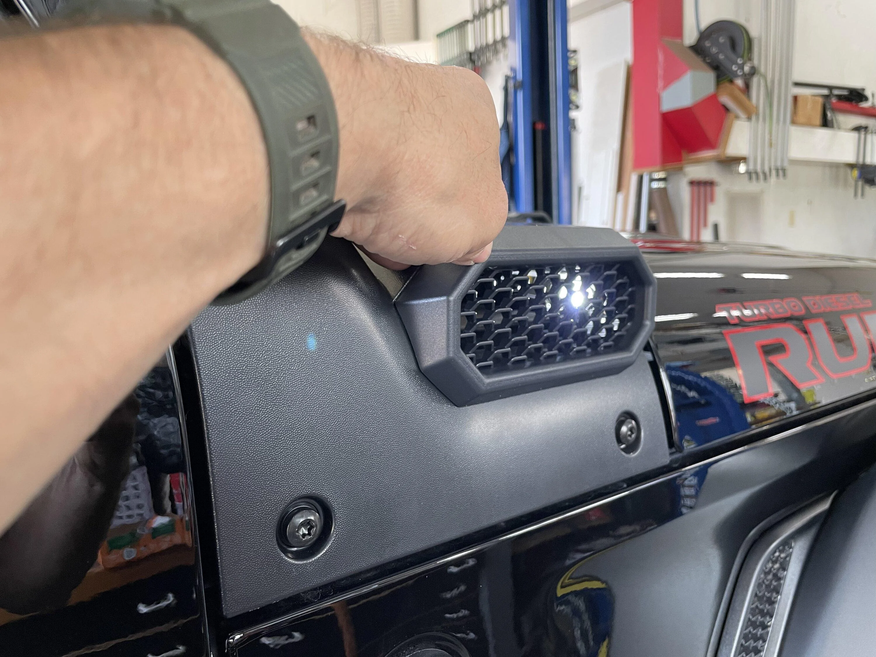

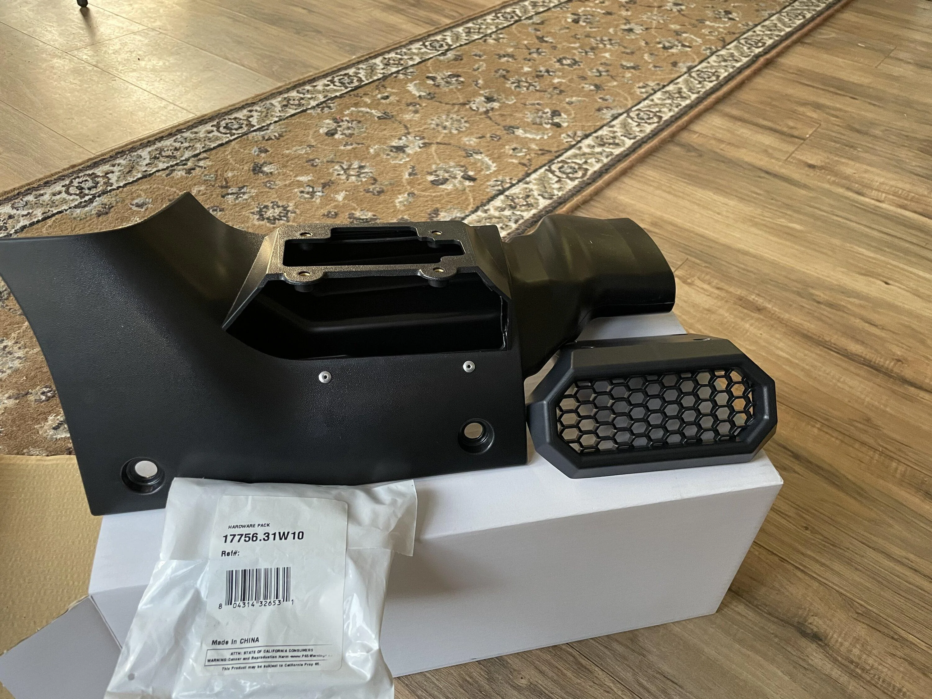

Next idea is going to be to try to get underhood air out of the cowl. Maybe remove the side foam pieces at the back of the cowl and vent the cowl end pieces somehow?
This is where I’m headed now, in a quest to relieve under hood pressure I opened the rubicon hood vents and used filter outerwear to keep water from draining onto everything under the vents (rains 9 months out of the years in the pacific NWet) At the same time I removed the side foam pieces at each cowl corner. Took it for a drive to get things warmed up,, turned the fan on manually (tazer) almost no hot air was making out through the opened rubicon vents (filter outerwear probably blocking air flow, may be better off with a tray with a drain under the vents) but an incredible amount of hot air was blowing out through the 1/2” crack between the end of the hood and the cowl corners where the foam pieces were. There was also hot air blowing from the fender vents. Started looking at options to vent the corner cowl, would want matching R/L sides. Some sort of louvers to create a low pressure vent, the 4xe cowl would work for the L side, the RR Amfib low mount snorkel would work for the R side but wouldn’t match each other. Searched to see if there was a 4xe RHD with the charge port on the R side but no luck. So as a long shot I called RR support to see if they would sell a couple of the Amfib lower cowl snorkel inlets and the low mount covers. Surprisingly the answer was yes and the order completed within an hour (great Customer Service) and they arrived within 1 week. I also ordered a left side oem cowl so hopefully I can combine that and the Amfib corner to make a Left side cowl vent to match the R. I should get the R side done today and maybe do some data logging pulls with our trailer up a steep hill in mid 90s heat. If it doesn’t improve cooling I’ll have the parts needed to start making a cowl drawn CAI or snorkel if I cared to.
Jeep Gladiator Diesel cooling options and ideas 152143EB-3FE9-4279-8320-DB0EC5C94A43
4xe cowl
Jeep Gladiator Diesel cooling options and ideas 4195013D-CC14-4759-A256-A098A919DC3A
Jeep Gladiator Diesel cooling options and ideas 8396B8A9-7B62-4C2F-BAD8-1E178E726036
Jeep Gladiator Diesel cooling options and ideas 14A9D307-7341-4684-8C6E-45922E317807
Jeep Gladiator Diesel cooling options and ideas B5A87C73-3E0B-48BE-81CF-9B00111FDC74

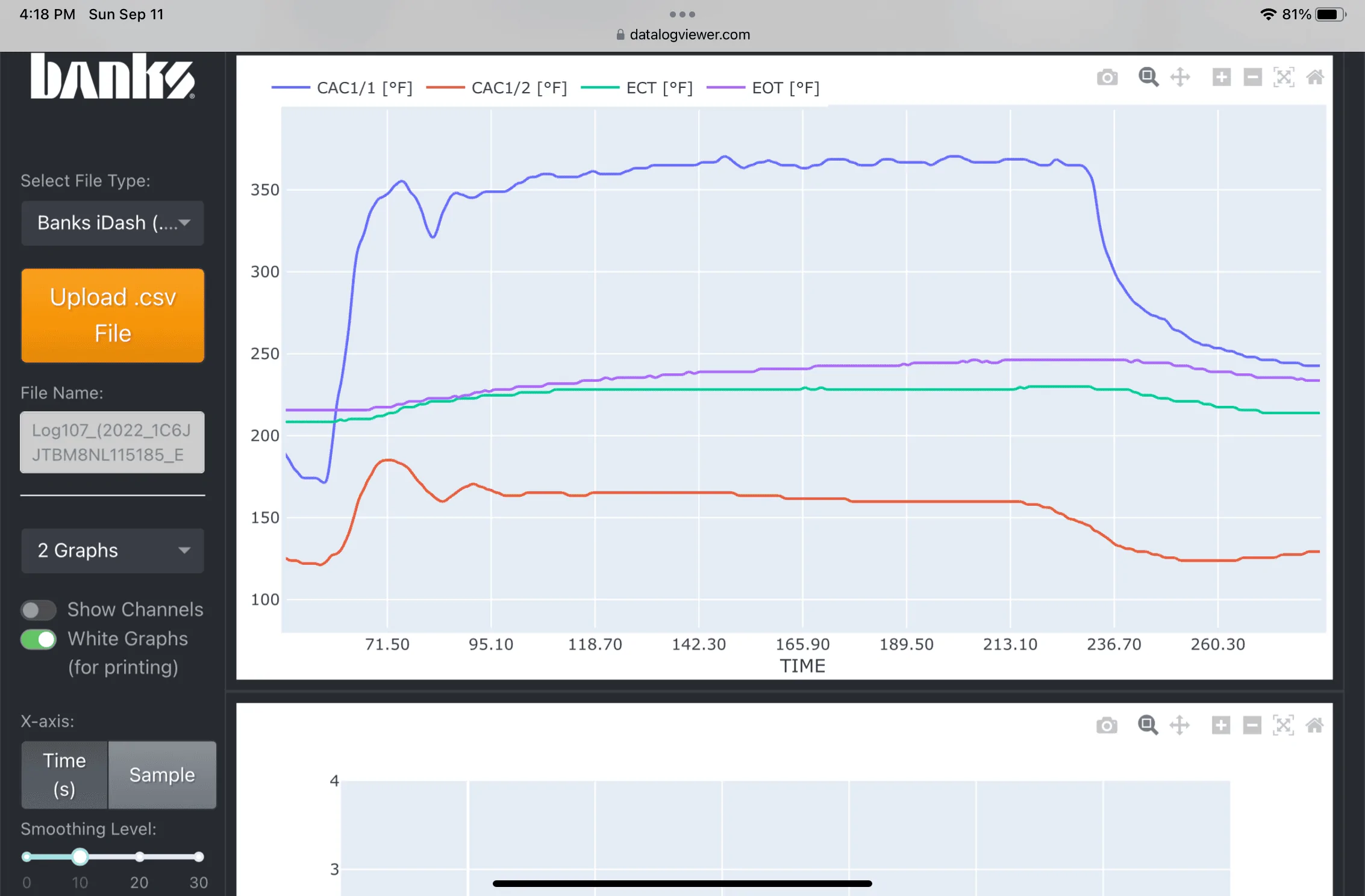

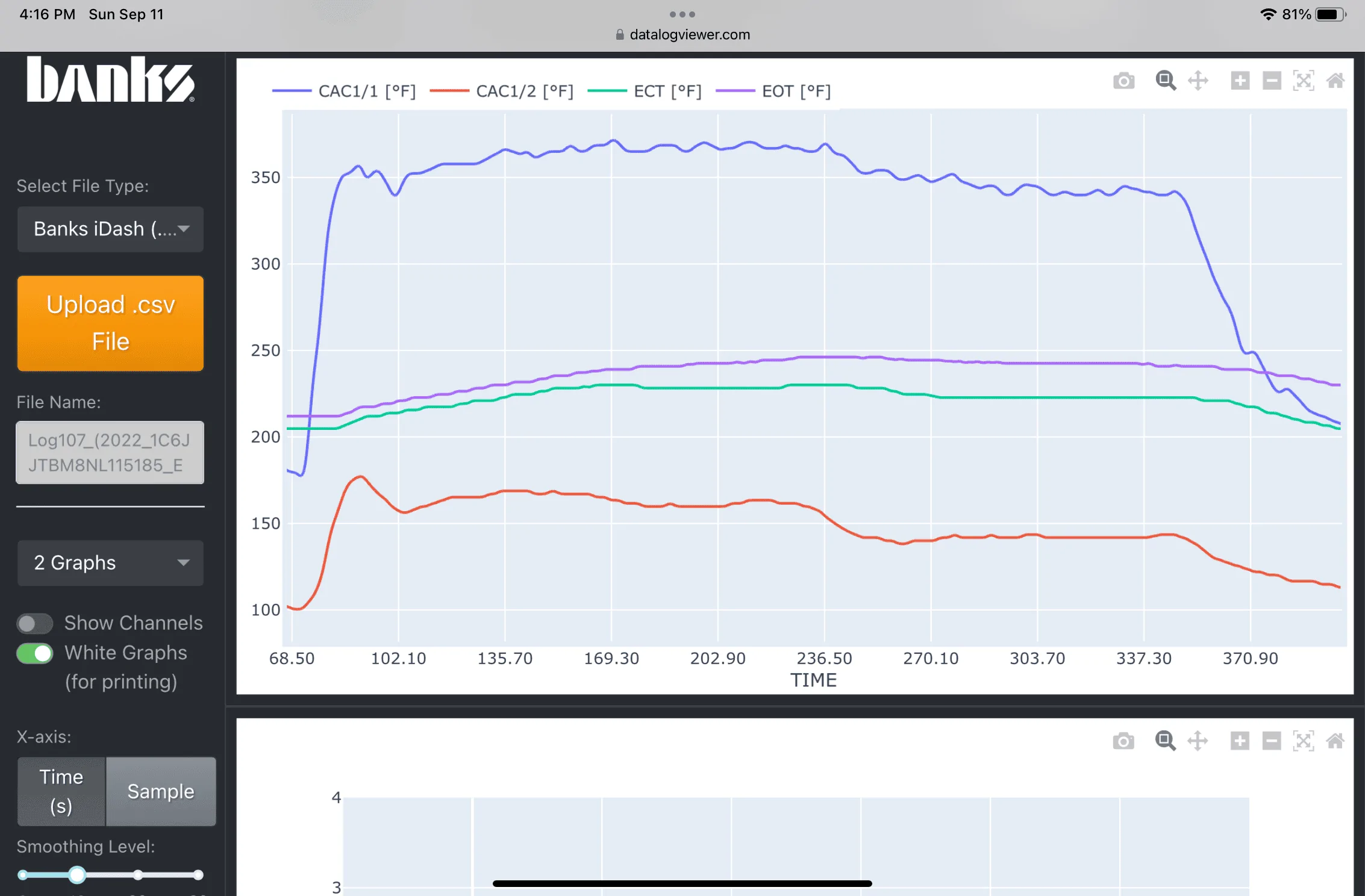

So that was a bust. Yesterday I did over 100 miles of data logging, both with and without the rubicon vents open and the cowl foam removed with the Amfib low mount cowl as a vent. All pulling our NOBO 10.5, truck and trailer weighing in at 9000 lb gross wt with driver.
Jeep Gladiator Diesel cooling options and ideas 7964A3D6-64A1-4667-9B75-6292CD5E9AE7
Jeep Gladiator Diesel cooling options and ideas 239FFABB-4046-48D3-995E-2084E4F17FAE
The ambient temps only reached 80 instead of the forecast mid 90s and the longest hill nearby is 6 percent for 2.5 miles so I did 9 60mph pulls and the temps were nearly identical for all pulls whether all extra venting was open or closed like oem. The pulls and outside temps weren’t high or long enough to get the system to exceed the cooling systems capacity. I looked at ECT, EOT CAC in and CAC out to try to find any variations. Every parameter for every pull was nearly identical. Maybe the extra air flow could help when conditions are met to exceed the cooling capacity but otherwise there appears to be no benefit to opening the vents.
All vents open;
Jeep Gladiator Diesel cooling options and ideas 067C4C08-1824-4EA2-8A82-4B5368D3422F
All vents as OEM
Jeep Gladiator Diesel cooling options and ideas AF75DE5A-3605-4EEB-A819-C21D080FB022
I have separate datalog files for each pull each with about 60 different parameters logged if anyone wants to examine them more closely.
All vents open;
All vents as OEM
Thanks for that data.....Falls right in where I suspected it would.
Now we need to make it a sticky at the top of this cooling and my derating thread with an with an acknowledgment and a short test before anyone can post. Maybe this way it would keep the repetitive hood venting suggestions from clogging up the discussion. Maybe even block "venting" from the post vocabulary? :)

Agreed, especially so with those designed like the PS ones. Properly designed vents/louvers are designed to be effective at speed by creating a low pressure area at the opening which causes the higher pressure under hood air to be vacuumed out. The heat extraction hood that AEV designed for the jk was designed like this to address the overheating while under load of their hemi swaps. And it worked well.
Since this thread is all about exploring cooling options to keep our engines from going into derate mode when under heavy load I was hoping to provide data helping to prove/disprove whether opening the rubicon vents and/or opening a cowl side vent could provide some similar heat extraction. I think I proved that I wasted my time, but at least I have the data to know that for sure.
