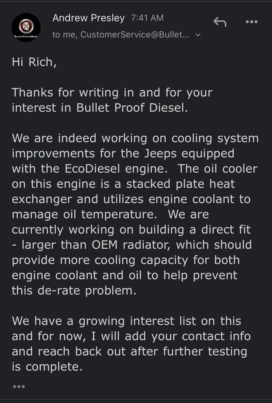

i see that they offer a new option ( tee fiting)
  • Owners of 2020-Newer models now have the option to select the tee fitting pressure port, which gains access to the oil pressure supply through your vehicle's oil pressure sensor.
I was going through their instructions for the Dodge Ram (nothing on the Jeep-same motor so same applies).
I don’t see anything in place that really regulates the volume of oil that pass’ through their bypass filter setup (when using the t fitting).
Without seeing a diagram I can only comment on speculation. However, if installing this setup utilizing the T fitting, and installing a cooler along with the T- what keeps the oil distribution system in check?
Any engineers on the forum?
Fluid flow and pressure. How does it react when met with resistance. This system allows for flow through the factory oil filter, but in addition T’s the oil system at the oil pressure sensor location to feed a full flow filter, and then dump back into the motor via oil fill cap.
I’m assuming the bypass filter (full flow) is more restrictive, and there for by design allowing oil to push through the factory filter.
However, with the resistance values unknown this would leave the quantity of oil passing through factory vs full flow unknown.
There are obviously folks out there running these setups with success.
However my thoughts were to duplicate the design (utilize a T ) and install an oil cooler. Though with zero resistance with just a cooler, I wouldn’t do this for fear of starving the rest of the system.

It looks like you're right about the radiators being the same. For the 2.0T I see a Mopar radiator part number 68314786AA, for the 3.6 gas I see several part numbers (68272749AC, 68272750AC, 68314786AA) though obviously one DOES match the 2.0T part, and finally the EcoDiesel I see two part numbers (the same 68314786AA and 68263398AF). So, it looks like at least the 68314786AA number is common across all 3, so I would *expect* dimensions, mounting systems, and inlet/outlets to be the same for all 3 engines. As such, you're totally right that Cold Case has this radiator: https://www.coldcaseradiators.com/product/18-20-jeep-wrangler-jl-aluminum-performance-radiator
It says 2018-2020 models, Im assuming the rad stayed the same up through the 2022 models. I would be interested myself. Look forward to your results posted up
I think with this radiator if you went with a lower temprature thermostat and programming that would lower your overall operating temps and the starting point of the oil temprature spike will be lower buying us time?
Im concerned with the paralell setup off the factor housing oil ports....your cooling oil through a cooler then its getting directly mixed with the hot oil that is going through the factory cooler....what good will that do? We determined the factory cooler can only keep it down around 250-260. So why are we cooling to 190-200 and then mixing it with 250 degree oil?
Seems like that is not the way to go.....

Need to bypass the coolant to oil filter, either a plate or plug the coolant side
dcmdon
Mar 31, 2021
60
3,656
4,427
It will do a lot. The oil cooled from the bypass cooler mixes with the warmer oil from the factory cooler and the temp averages based on the volume flowing through each cooler.
Further, since there is less flow through the factory cooler, the oil is in teh cooler for longer and has more chance to cool down.
In fact, its nearly as good as running all the oil through the extra cooler. Because the oil running through the extra cooler is moving slower it too gets cooled more than if it were full flow.
