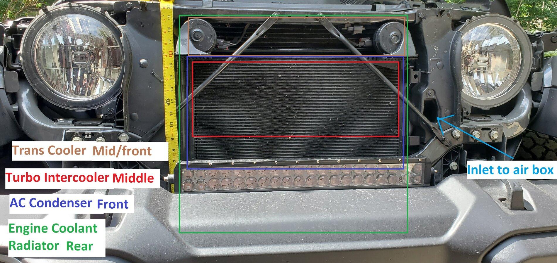

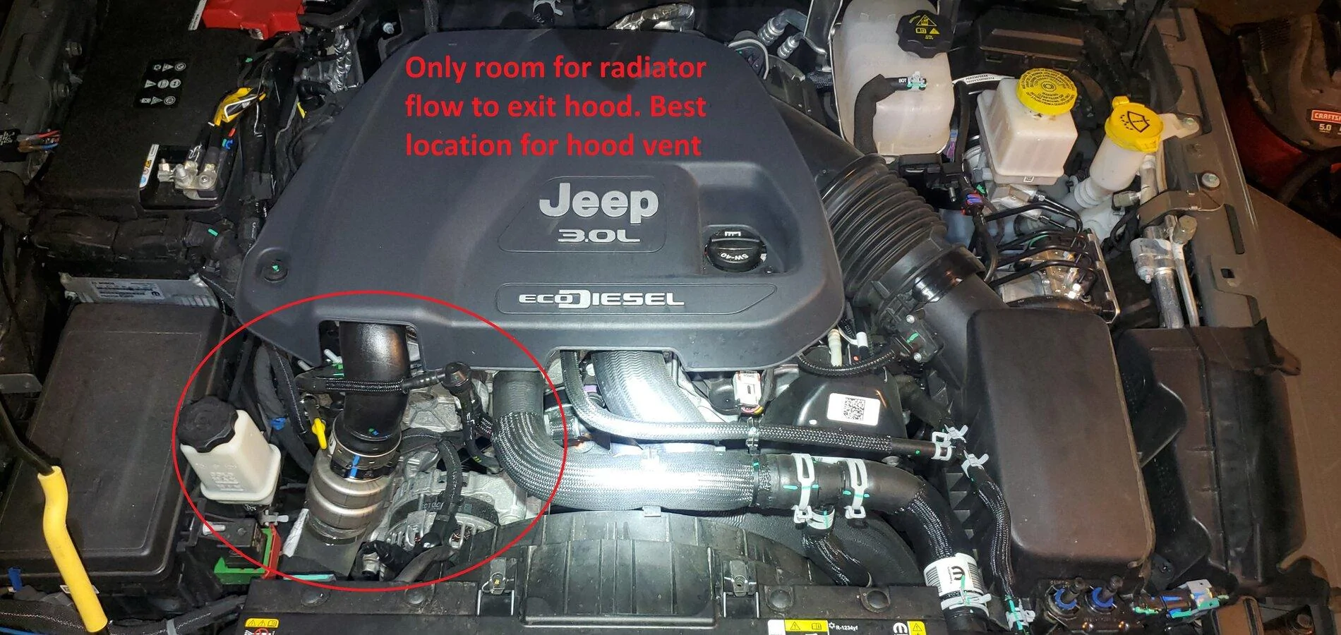

To the best of my knowledge this is where the radiator components sit.
Jeep Gladiator Diesel cooling options and ideas layout
From the top there is very little room to let radiator flow pass.
Jeep Gladiator Diesel cooling options and ideas engine flo
I take back what I said about the horns - your diagrams are great! Kudos for really getting down and dirty and detailed with this.
I do have to ask, though - aren't those lights having some impact if you look at those as something that's going to disrupt the air and cause turbulence that may actually divert air up and away instead is leaving the light and going directly into the radiator? IT's not going to flow smoothly over them and right back in.
I am 100% dumping that light bar. That was the best picture I had on hand to write up.

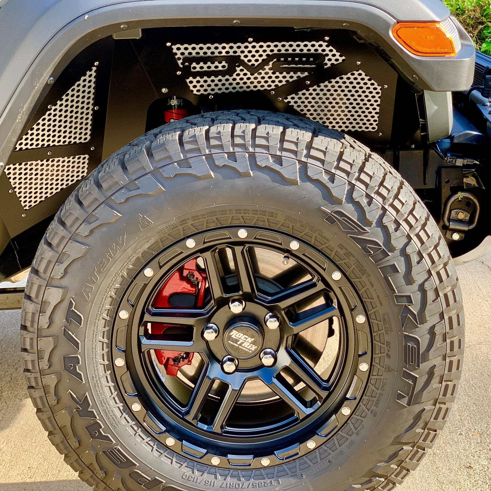

Jeep Gladiator Diesel cooling options and ideas IMG_4038a
I put these on recently; I honestly don't know if they do anything to lower temps in the engine compartment, but they looked pretty cool. I put the rears on also and they aren't vented, just solid aluminum, so that makes me think the mesh is for air flow.
Was this on a diesel? I know the Diesel has a washer tank that interferes and some work and some dont and can be complicated to install. I have been looking at getting these or the smittybuilt.
