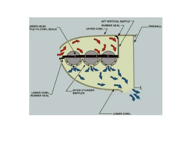

What do you guys think about adding a 2-3 inch lip on the top of the grill going forward to trap pressure? Almost a hood extension ish. I know a few post mentioned the idea but I may add that to the test list because the fabrication would be simple.
I think you are going in the wrong direction. Rather than extend a lip in front of the grill so it scoops more air, it would be more effective extend something BEHIND the grill to seal the pressure between the grill and the radiator.
This would ensure that the minimum amount of air went through the radiator rather than around it.
Like I said, on our road race bikes, the gaps between the inlet and the radiator were always sealed for just this purpose. The gaps are also sealed on (air cooled) aircraft engines. The air comes in through relatively small intakes and into a rather large plenum that then forces air down through the fins.
It is already sealed well between the grill and the radiator. Many cars they are not but Gladiators are.
Bottom line is pressure differential creates flow so it should help with either increasing pressure in
front of the radiator or better venting in the hood, fenders, or down.

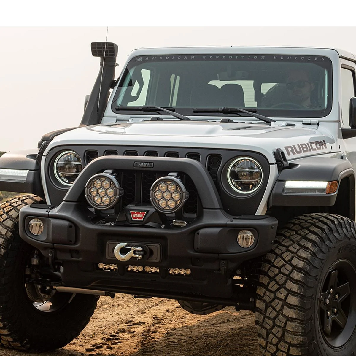

With regard to cooling, is it fair to say that the lights on the AEV front bumper are a terrible idea for a diesel owner?
Gee, maybe, just maybe, you are onto something??
Bar, winch, lights, all seem to be in the grill
Naw, can't have any impact, naw.
