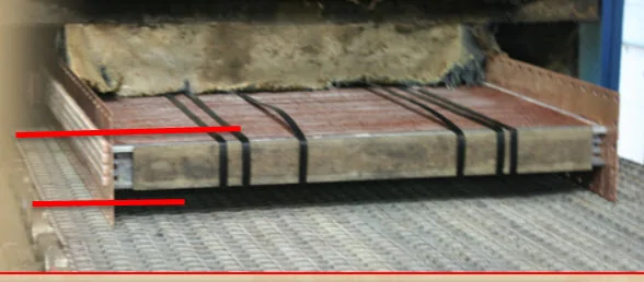

For instance here is a place that makes custom radiators:
https://detroitradiatorcorp.com/drc/page/manufacturing_capabilities
Have the core made thicker (deeper)

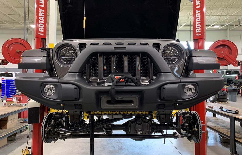

This is the OP's Bumper who started this thread: There is room to fit the thicker core in the driving direction , the front bracket will need to be moved out and that flap cut but there is lots of space like this:

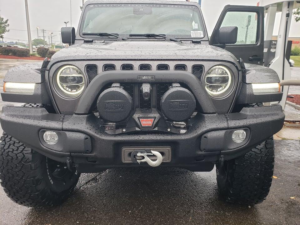

Here is my serial number 1 new bumper after installation, I have the winch buried inside it and the ends come off if I want it to be a stubby. (This bumper has low profile winch inside bumper and fog lights under radiator bottom of bumper). Notice below at bottom picture when lights added it interferes with air flow. I'm thinking of designing a ram tube for air flow behind the lights to reduce the pressure drop.

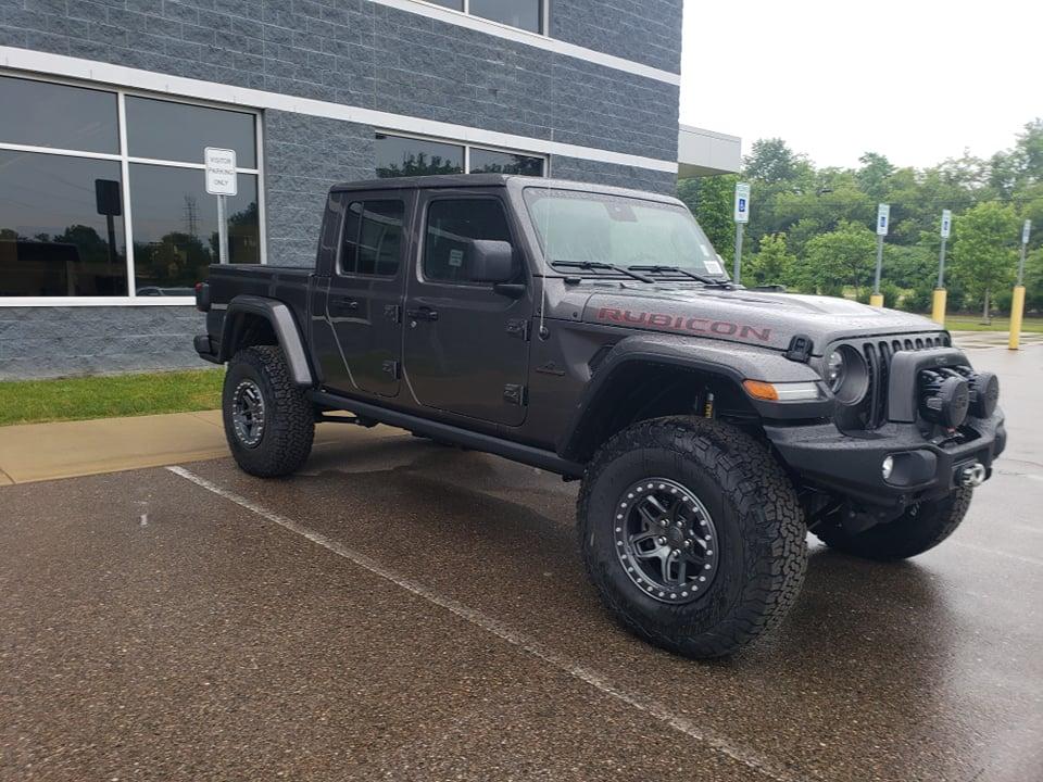

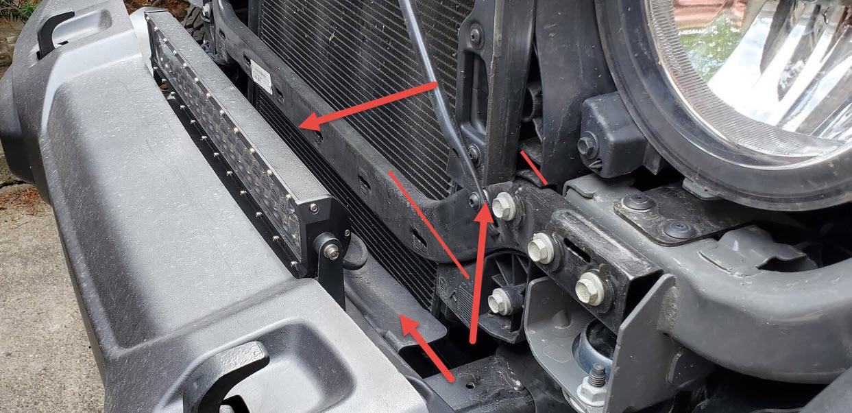

I'm now concerned about my off road lights restricting air flow. Notice the lights restrict air flow; I'm thinking of designing a ram tube for air flow behind the lights to reduce the pressure drop. My manometer will measure if it's (lights) restricting air flow for air to water heat transfer, see picture below.?
glad pic in front of AEV 205516862_1484672865213982_394635747709688818_n.jpg
I need to reduce the pressure drop behind the lights, I'm going to take a manometer and measure the pressure drop behind the lights to assess if I have a high delta P. If the drop is high then I will design a ram to eliminate the pressure drop or move the lights.
