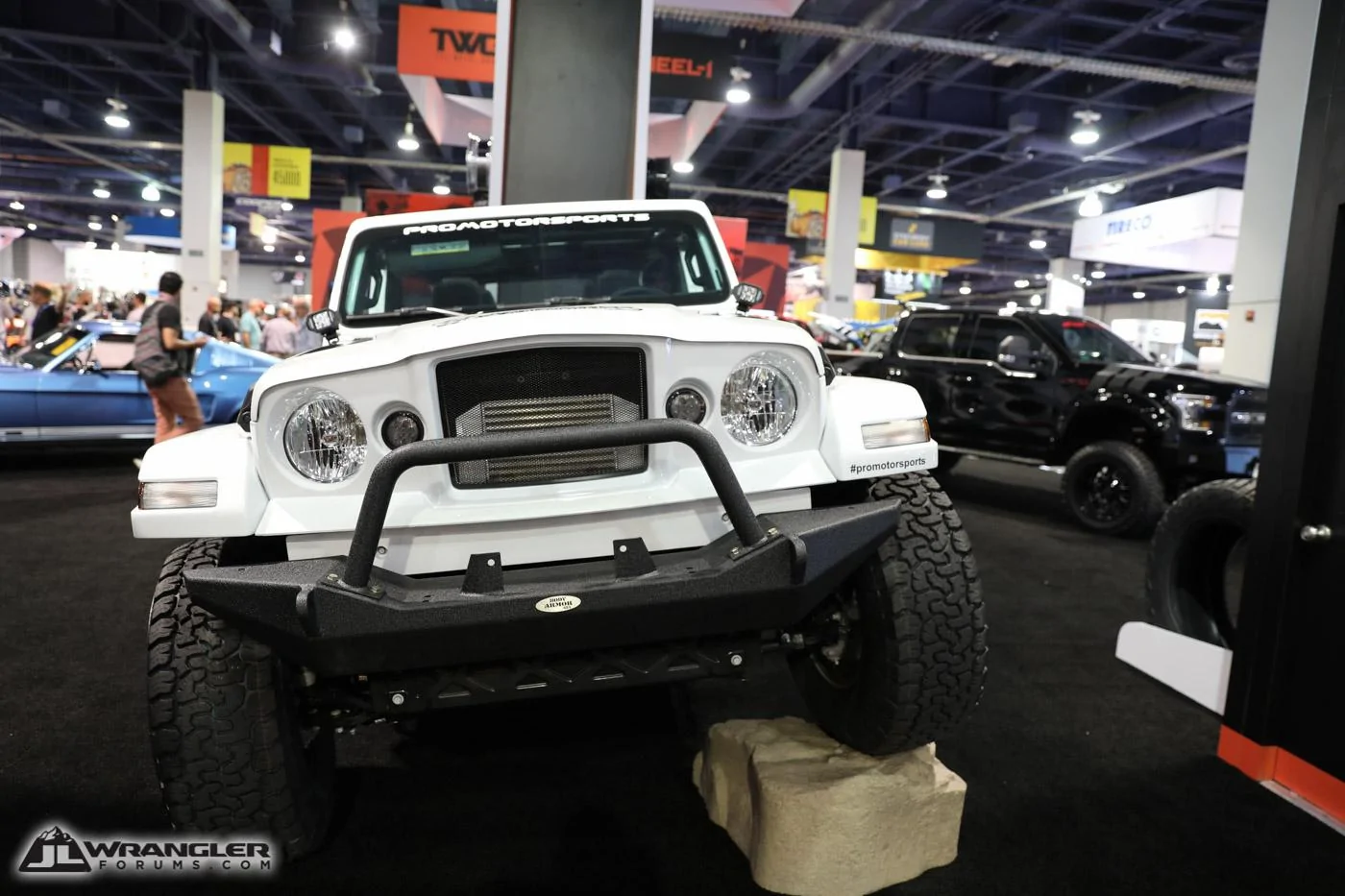

Perhaps a body kit as such would give better cooling? Not for me though. I'm waiting out for aftermarket intercooler and radiator.
Jeep Gladiator Diesel cooling options and ideas JL-Gladiator-Promotorsports-JL-Jeep-Wrangler-SEMA-2018-A33A0084

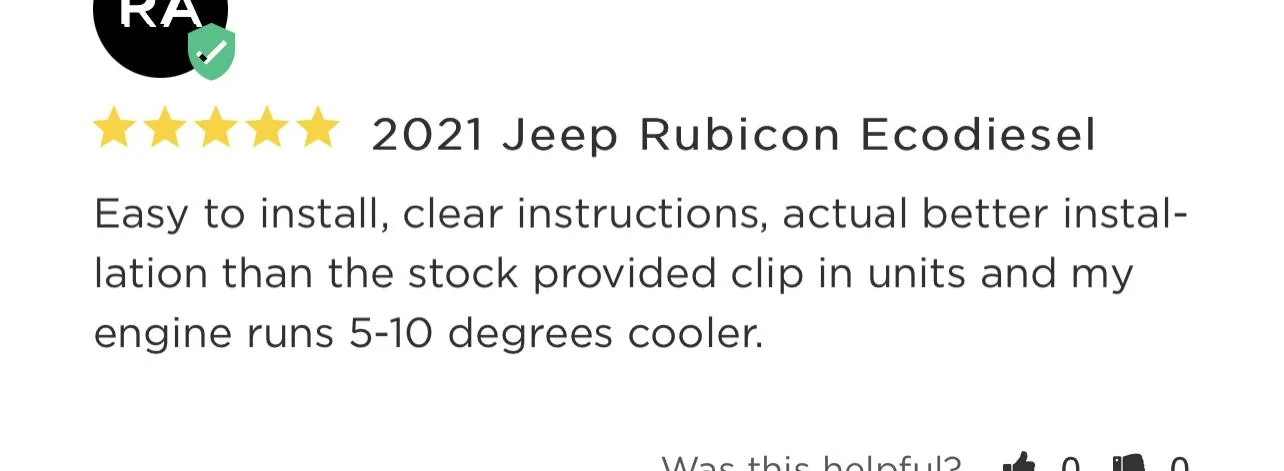

I just ordered these. They are on backorder.
One guy left this feedback.
Interesting. I wonder how scientific that person's testing was? I would have thought you want to be pulling air up and out of the under-hood area, vs. forcing air in. But, results are results...
Probably not very….I’ll try it out. I have a 650mi road trip coming up, so I’ll monitor temps on that. After install, I’ll see what I get over time for temps…not going full on replacement of the cold intake.

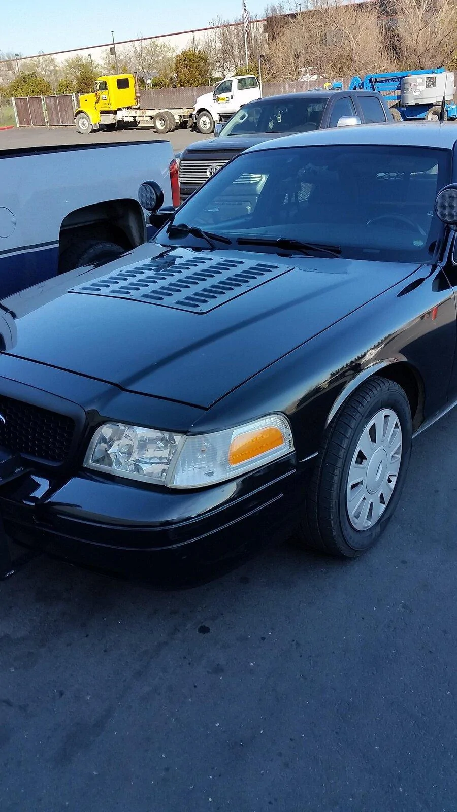

7) work to maximize air extraction from the engine bay - flow through the radiator is a function of the pressure differential between the front of the radiator and the rear. If you open up vents and build a plenum you will maximize pressure at the front.
Now you need to think about evacuating the air from the rear of the engine compartment behind the radiator. I don't know, it may be well vented as is. But I think someone mentioned making the fender vents functional. One other option is an extractor vent at the back end of the hood. Like the old hot rods had.
Louvers like this will reduce the pressure under the hood. Though I think a couple of large ones at the rear of the hood will look better on a jeep.
