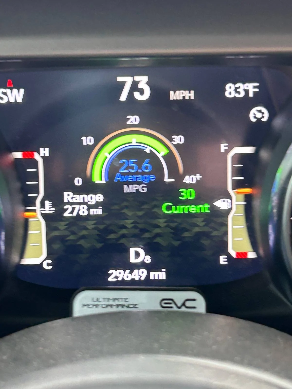

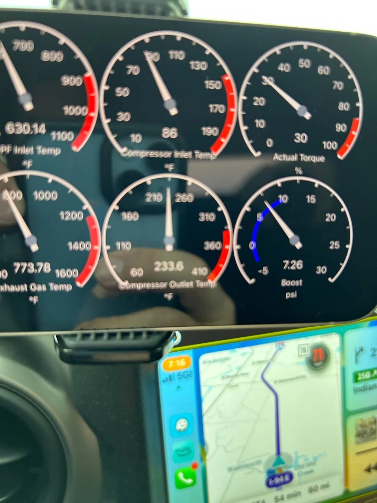

I have the AFE intake and based on my Banks Idash my intake temps are usually only 10 to 15 degrees about outside ambient temp which I think is pretty good.

I have the stock intake and inlet temps are typically +3 to 5 degrees above ambient when going down the road. I don’t think any intake is going to help temps much vs stock without a bigger external inlet up front and even then it won’t help much. The AFE does look cool though👍
