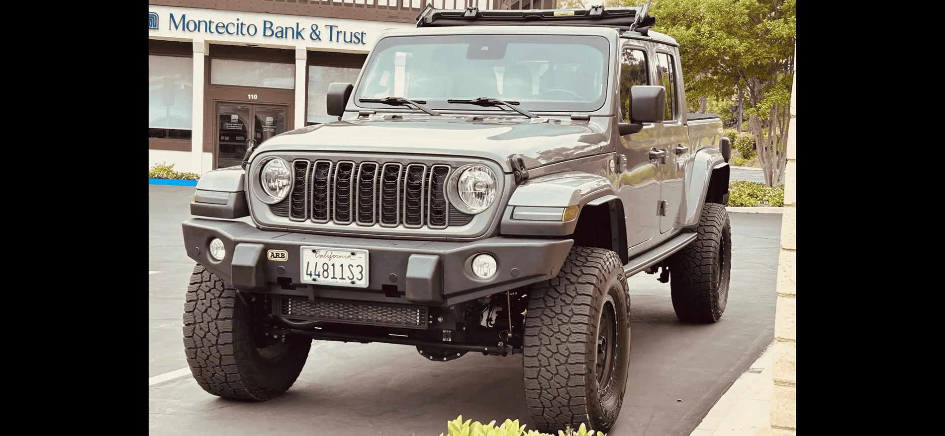

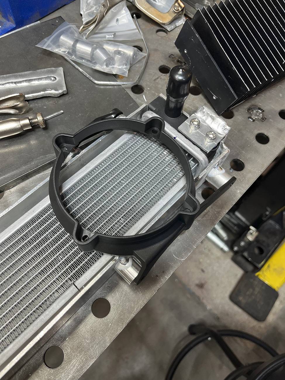

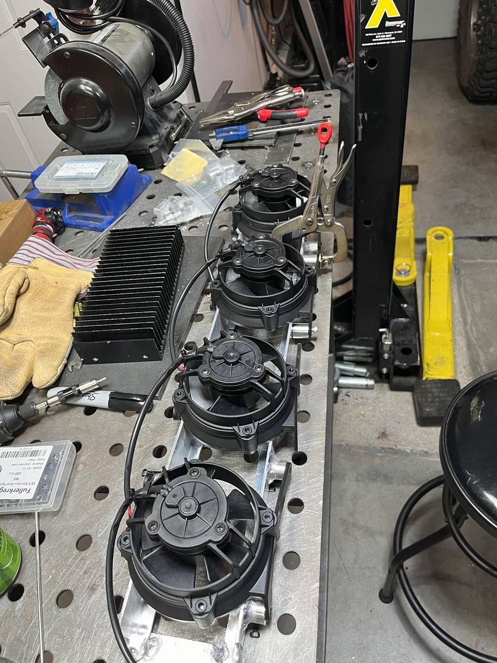

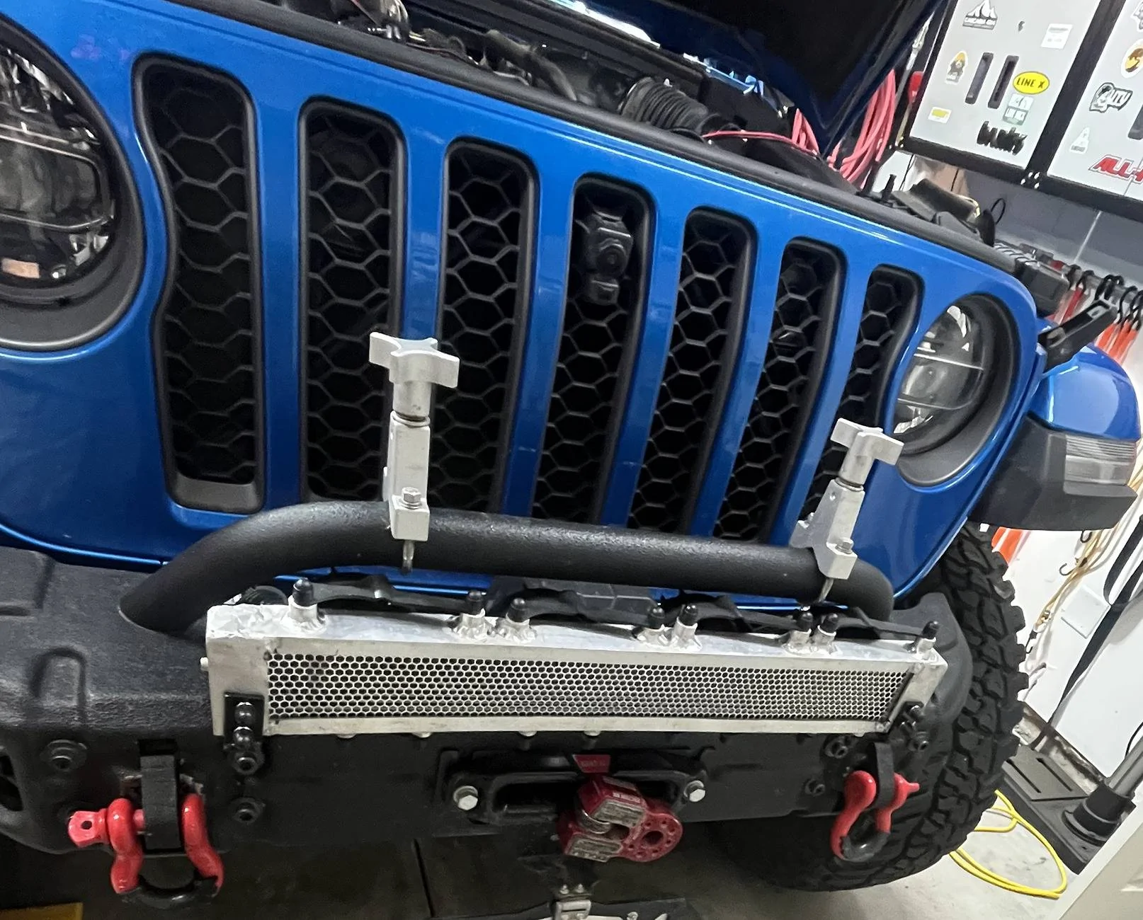

After combing through this thread I settled for building my own and stuffing it on my front bumper as I use my Jeep for rock crawling and off-road only. I threw 4 fans on the back as well. This solved my de-rating issues going up I-70 and other passes when towing. I also had issues de-rating when cruising (no tow) at outside temps above 100F. I am on 37"'s with factory gears.

The fans operate turn on/off via one aux switch. The fans dissipate more heat at lower speeds which help going up long hills. I have seen coolant temperatures reduced by >10F and held steady on long pulls. I have data logged the temp differences of 238F coolant to 260F oil at 65mph on aggressive (my foot) long pulls and became limited by turbo temps of 1600F constant at which point I had to back off.
All four fans are Spal 30103018 4" mounted to husqvarna KTM fan brackets P/N 79635943000.

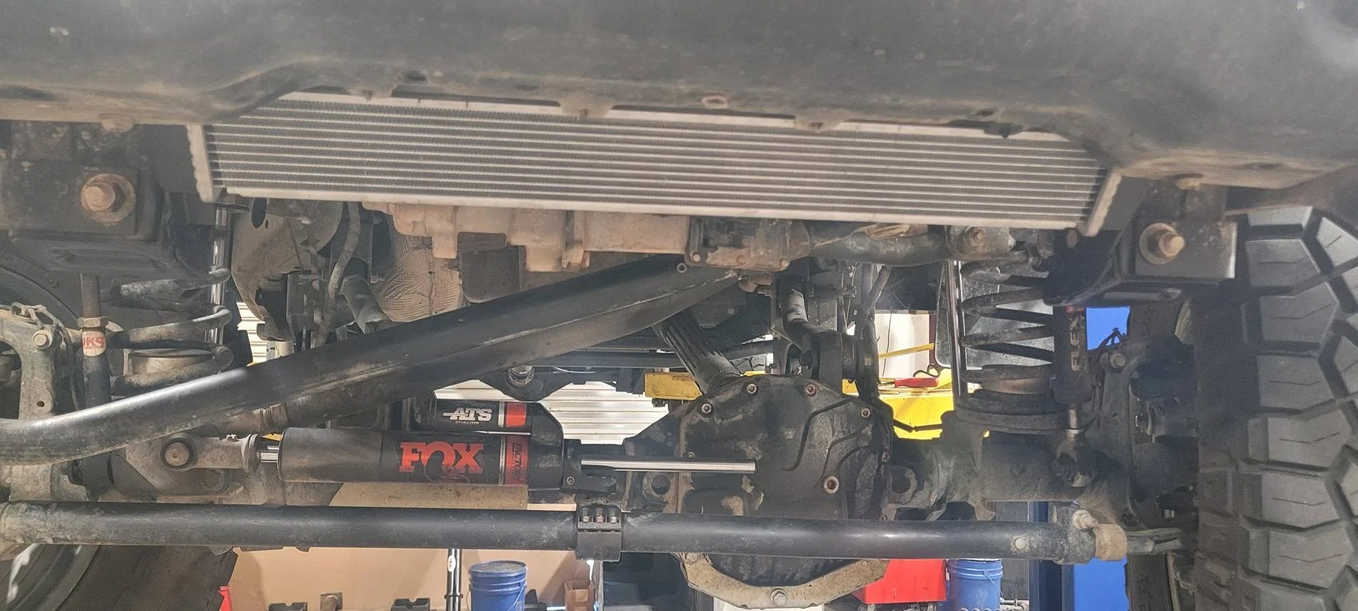

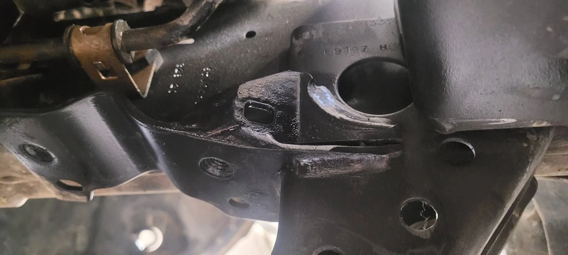

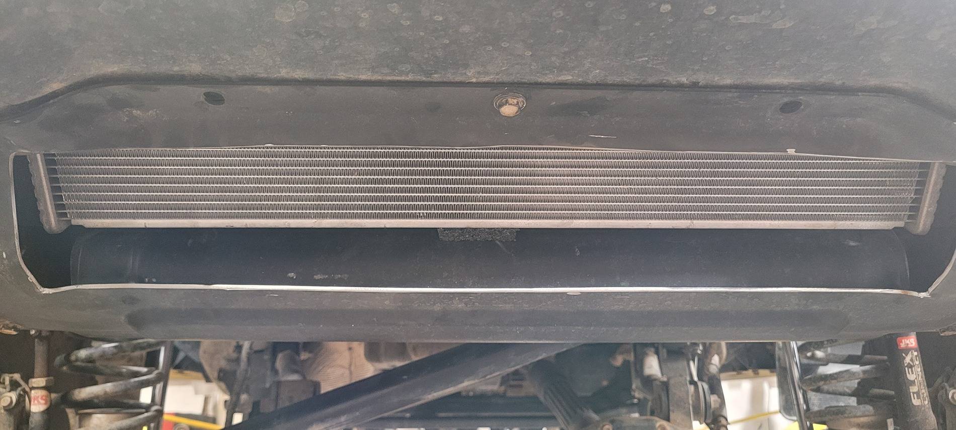

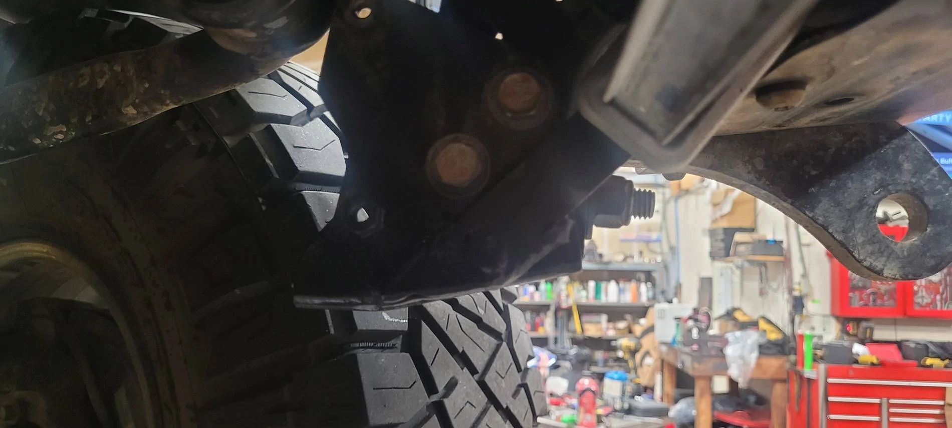

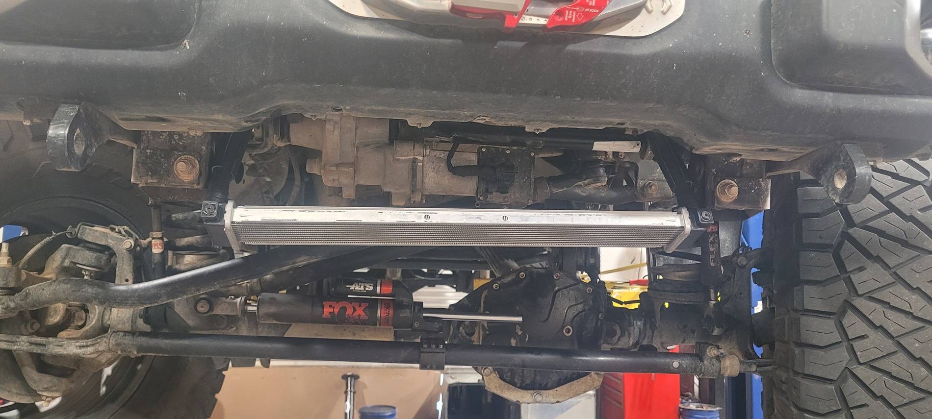

I got it all mounted and plumbed today.!
Had to do a little trimming on the corner frame brackets to make room for the hoses. I welded the supplied brackets to the skid plate brackets since that was the easiest. You can still get the bolts out of the radiator and/or drop the whole thing as an assembly.
Obviously I need to cut a slot in the skid plate still, but I want to see about some expanded metal with a tighter pattern or just install a bug screen inside. I also plan to fab a box on the inside surrounding the radiator and seal it with foam so any possible vacuum behind it can be utilized for extra air volume.

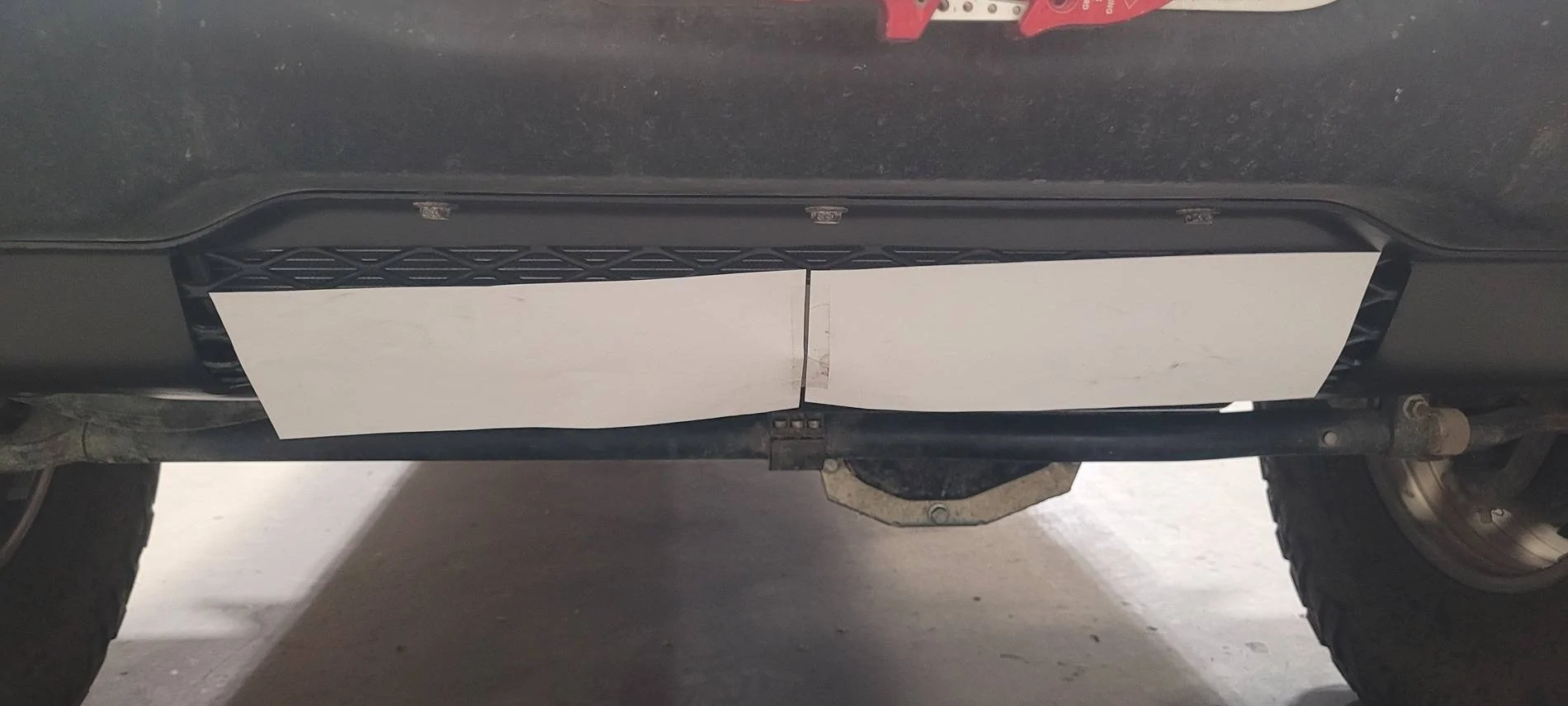

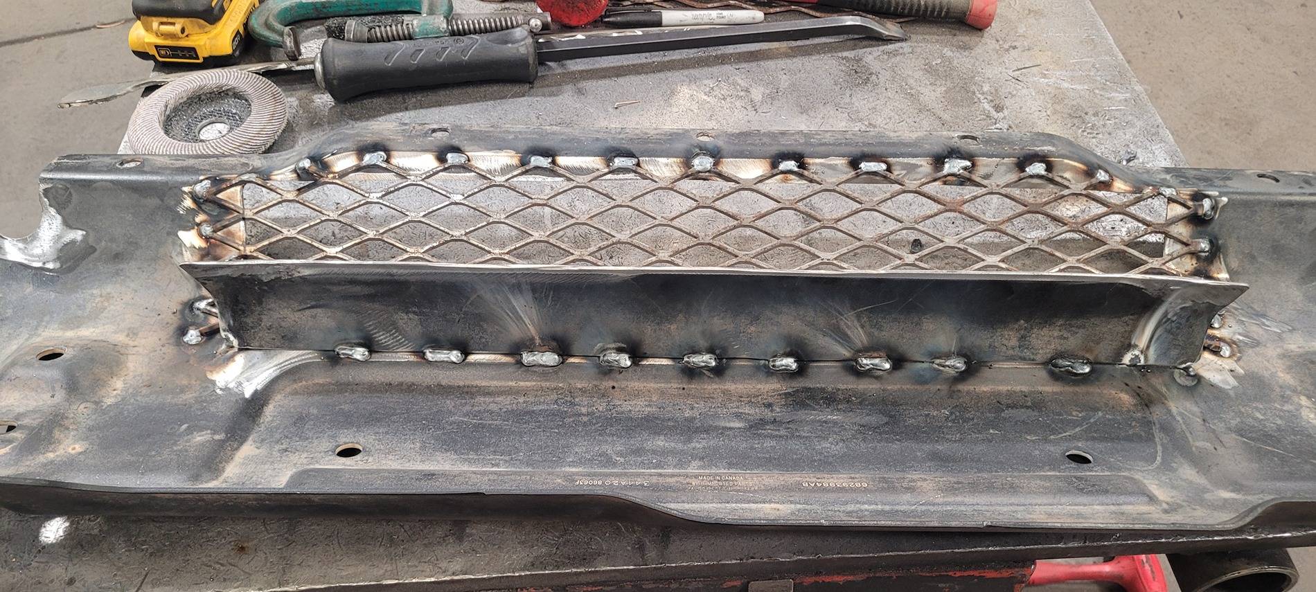

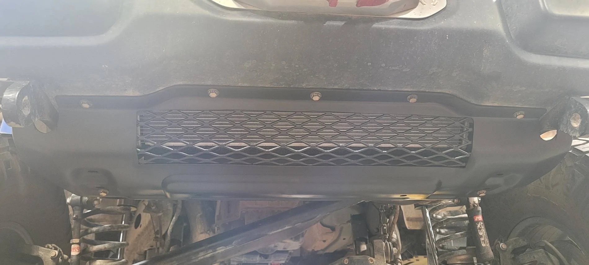

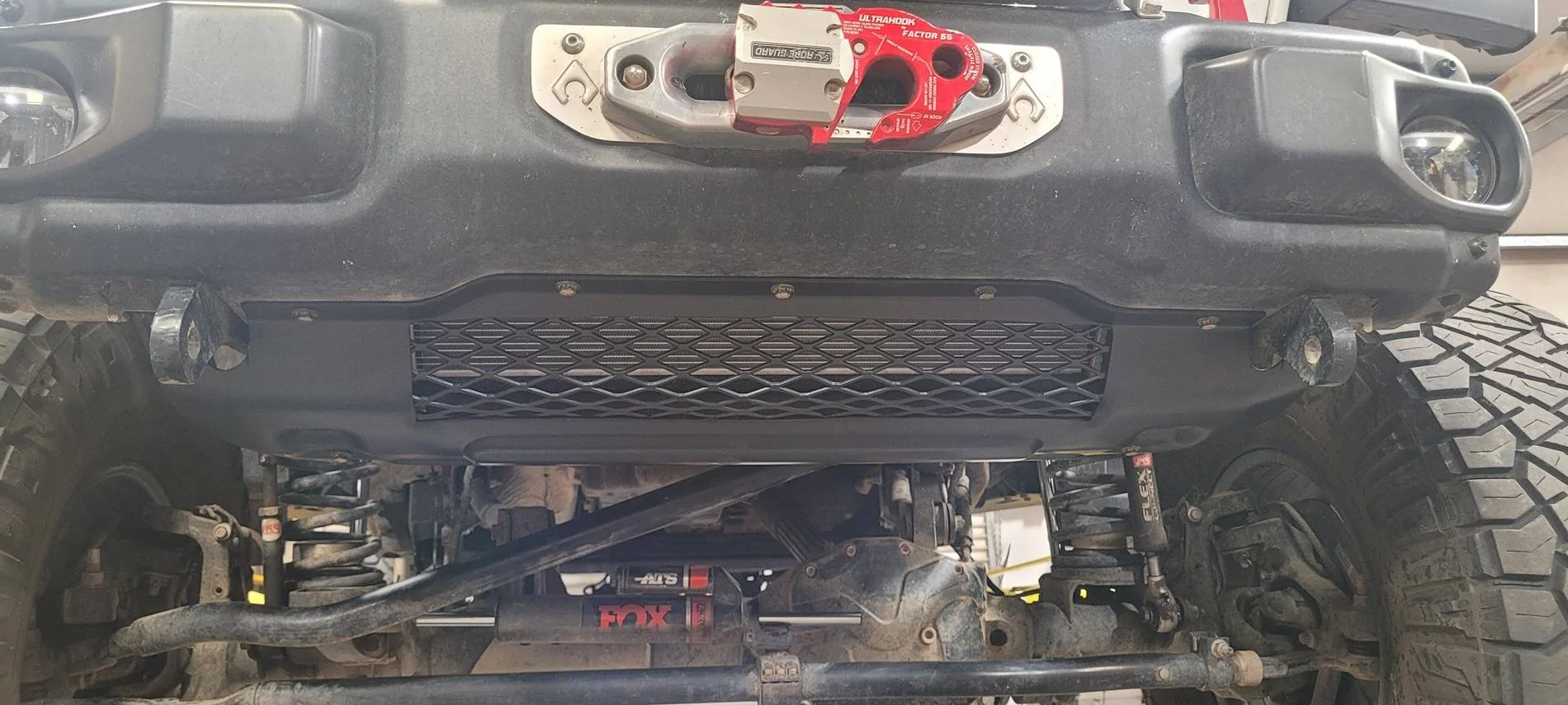

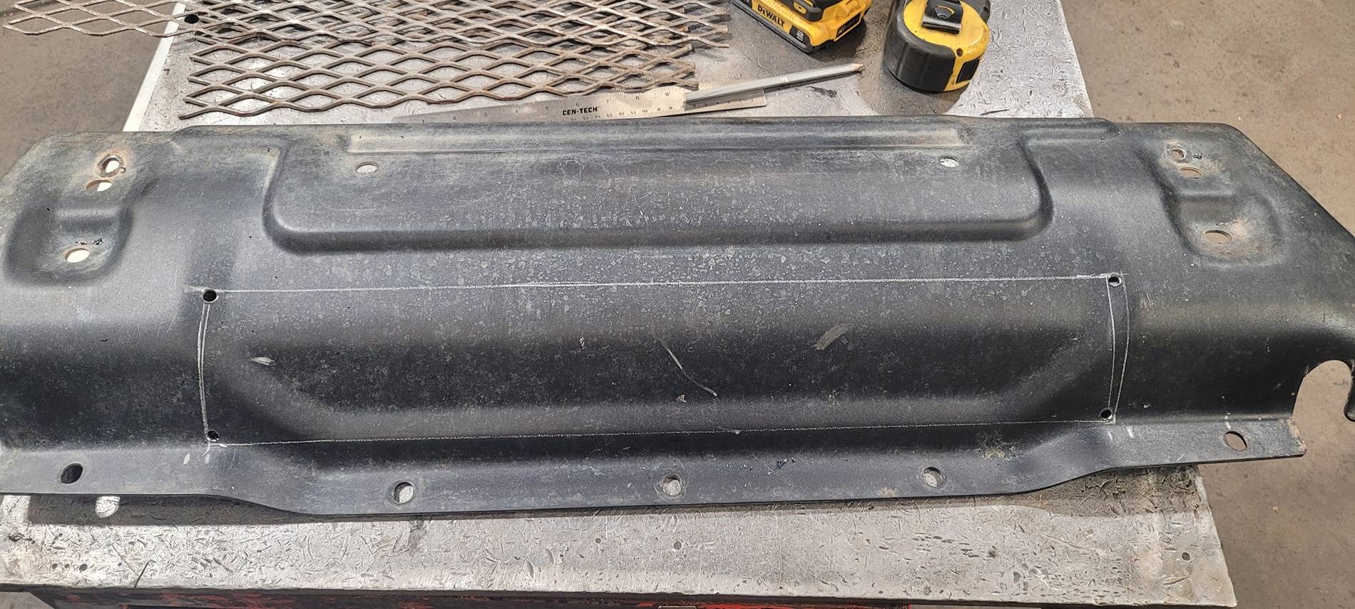

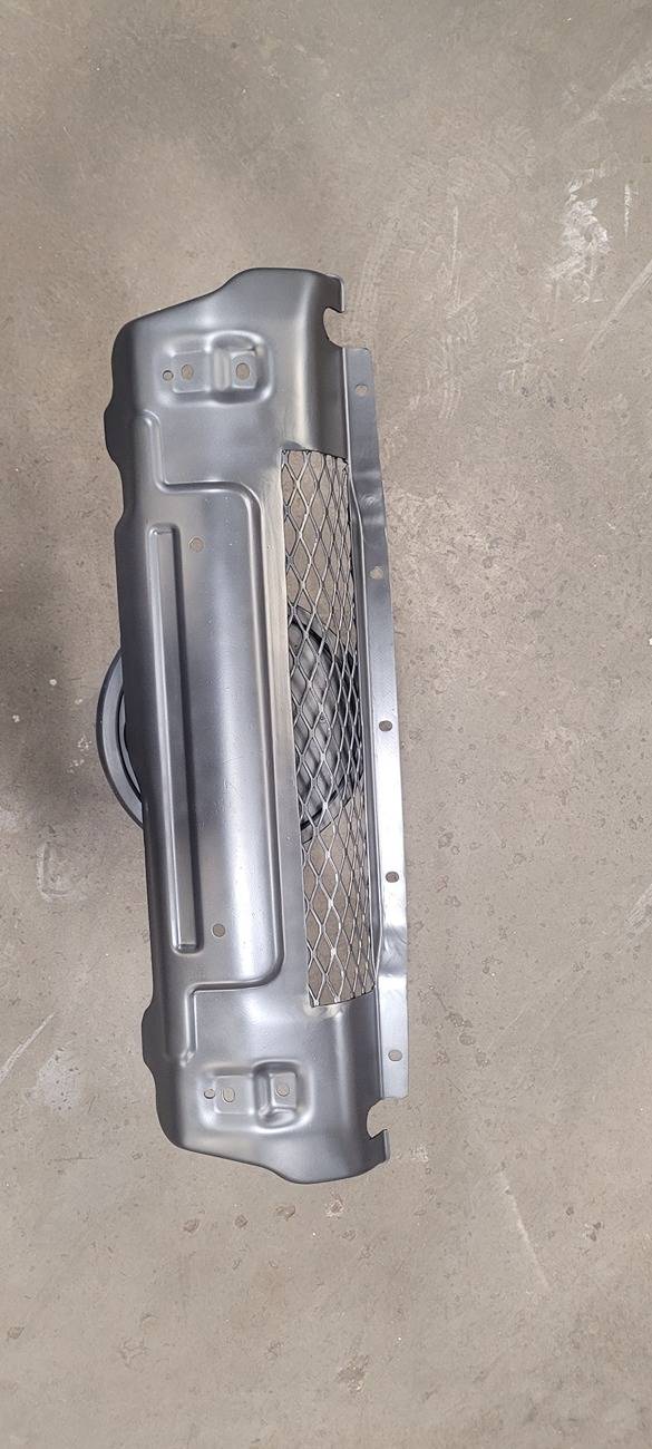

OK, just got it on the truck.
I cut a hole and decided to use the 3/4 expanded metal I had on hand to maximize airflow. The hole is 38% larger than the size of the radiator in hopes that the available incoming air pressure/volume would always be more than the exhaust out the back side.
I also made a little air dam to guide air from the lower part of the hole up the the radiator. The entire radiator is also sealed 360° to the vent by a foam surround. I reused the piece I cut out trimmed and flipped over for the guide.
Best I can do without a wind tunnel.......Now for the real test......It's forecasted for 117° here today!

EDIT: Pretty sure I did something right for a sheet of paper sucked to the grill when the fan is running, but falls off when the fan stops? 😄 🤯 :rock:

I honestly can't tell much difference on the road unloaded, but it seems like it recovers quicker when coasting or pulling off the highway for sure!
I have a tow coming up with some serious elevation changes, so that will be a test.
