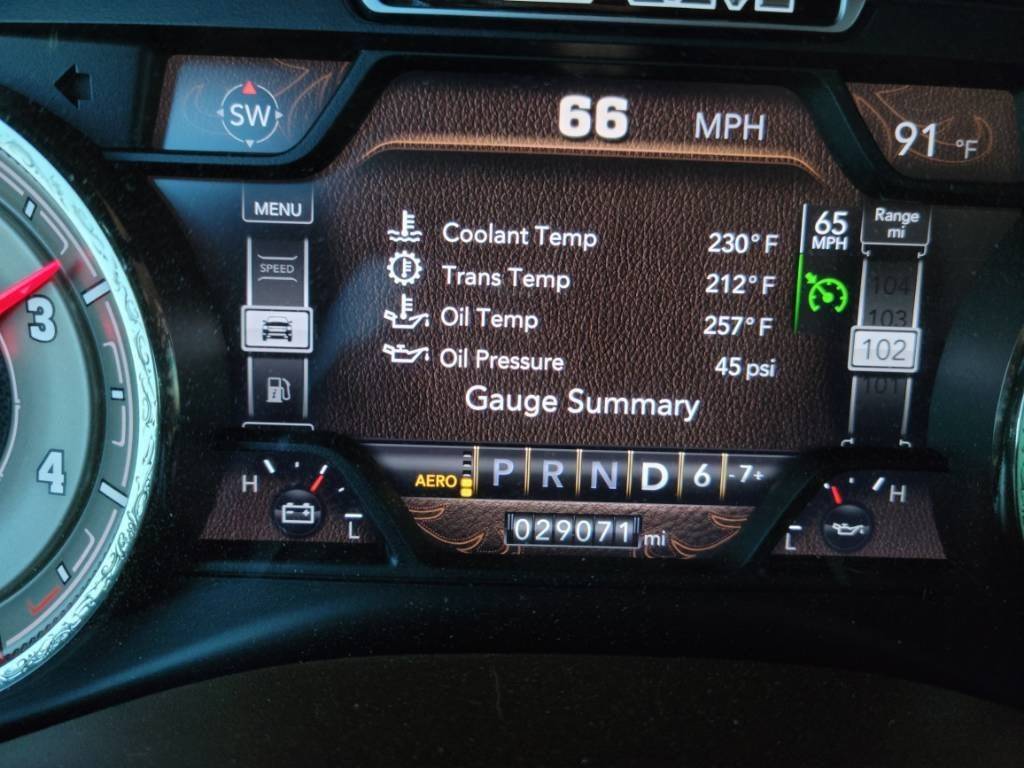

Air flow is very limited on the Jeep. My highest towing coolant temp on the Ram was 230*F and highest oil was 257*F. That's towing 7,000 lbs with cruise control, air condition on, and towing on a long steep grade at 65 MPH. I've towed throughout California, Neveda, Utah, Arizona, Colorado, and New Mexico. The highest ambient temperature that we've towed in was 117*F.

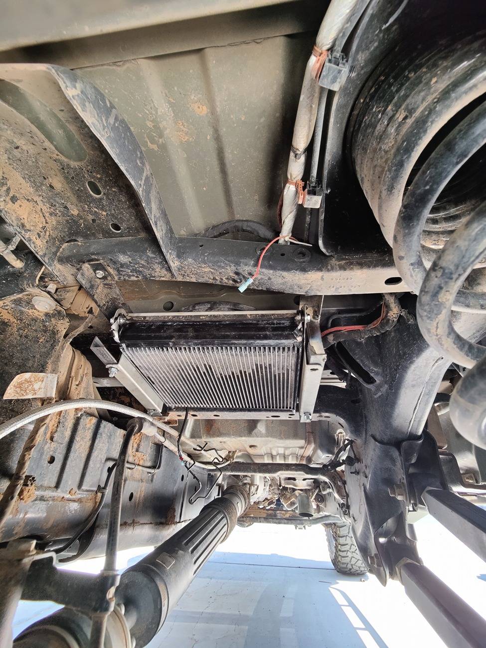

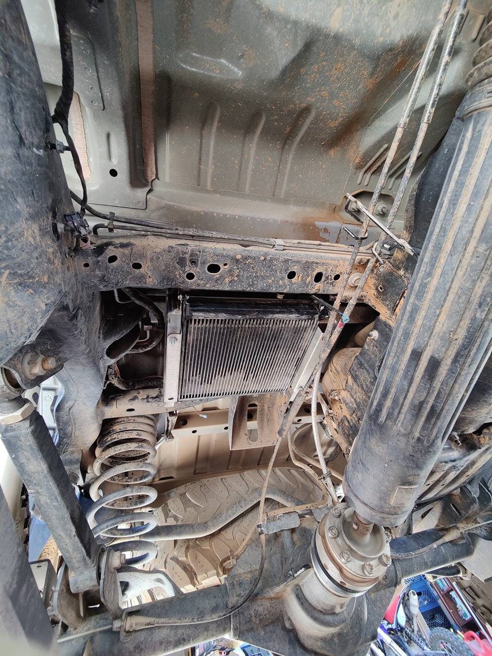

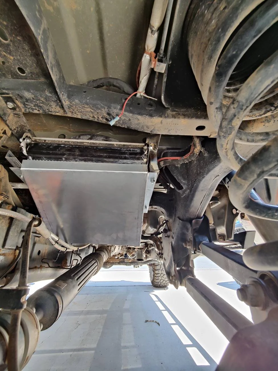

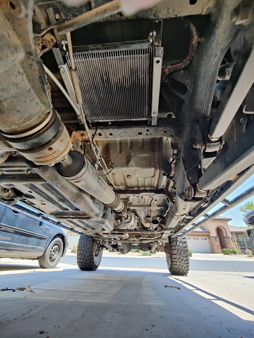

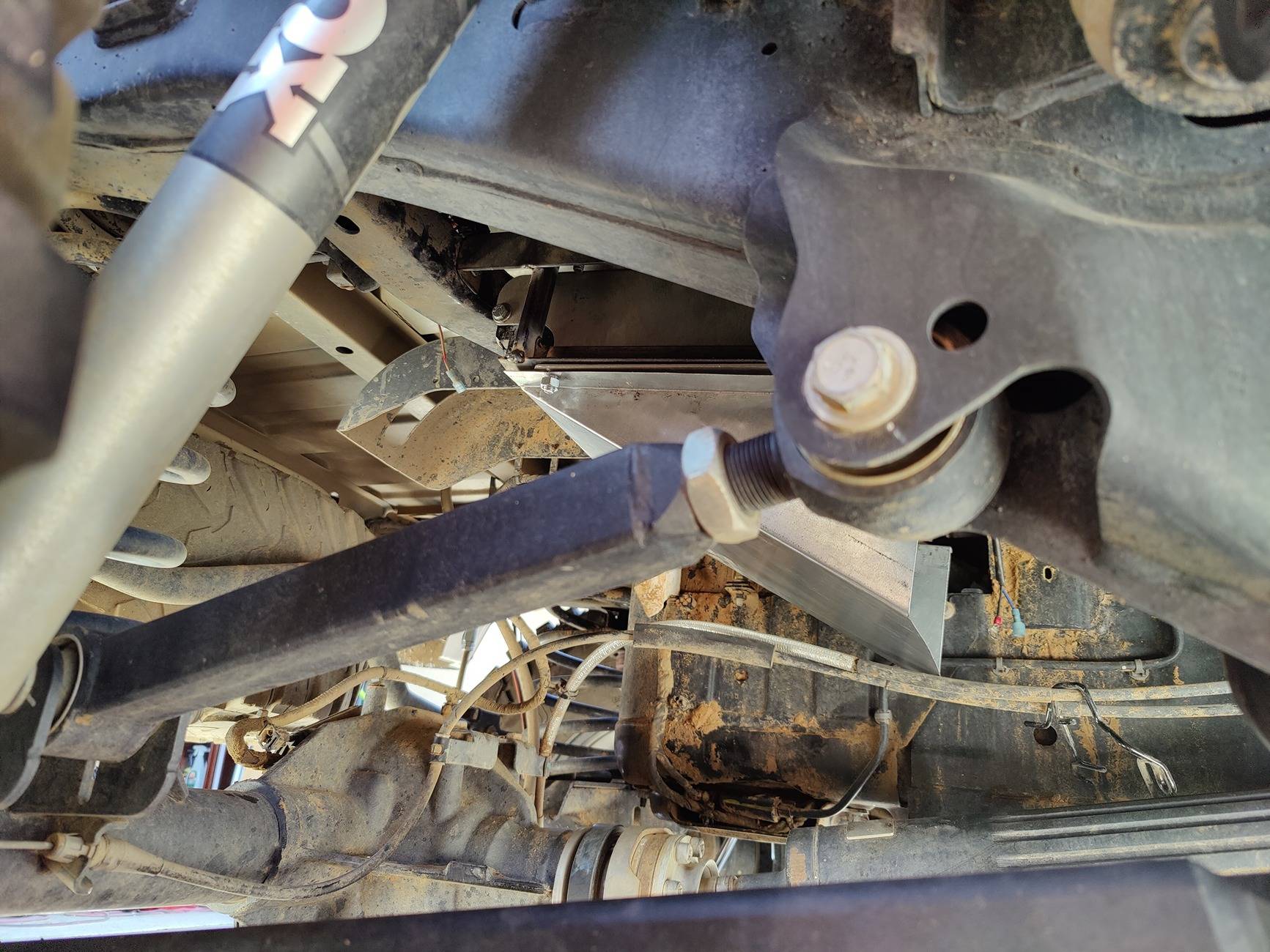

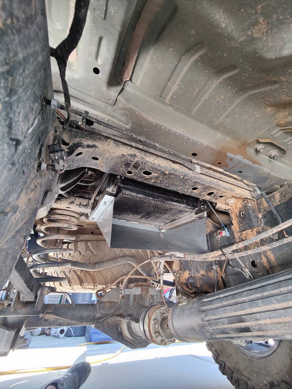

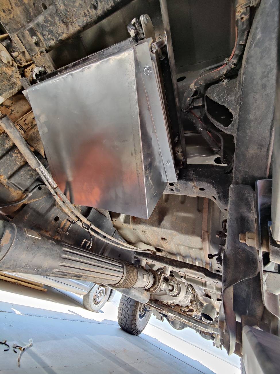

Here is my solution. It uses a Derale cooler mounted towards the rear under the bed. I am going to tap into the coolant just like BPD does, the return from the oil heat exchanger. I made a scoop for it that is easily removable. At a minimum I plan to run the scoop on long trips and definitely when towing. I am still waiting on my hose to show up so I can plumb it all in. I took the best pictures that I could. It's very difficult to do without the truck being on a lift.
You’ve got me wondering now about what kind of effect a run of that length is going have on flow…. that is a pretty lengthy detour for a hose that originally only spanned a couple inches..
I wonder, would it be possible to just tap into the main radiator and obtain the benefit of the larger hose size and thermostat controlled flow?
