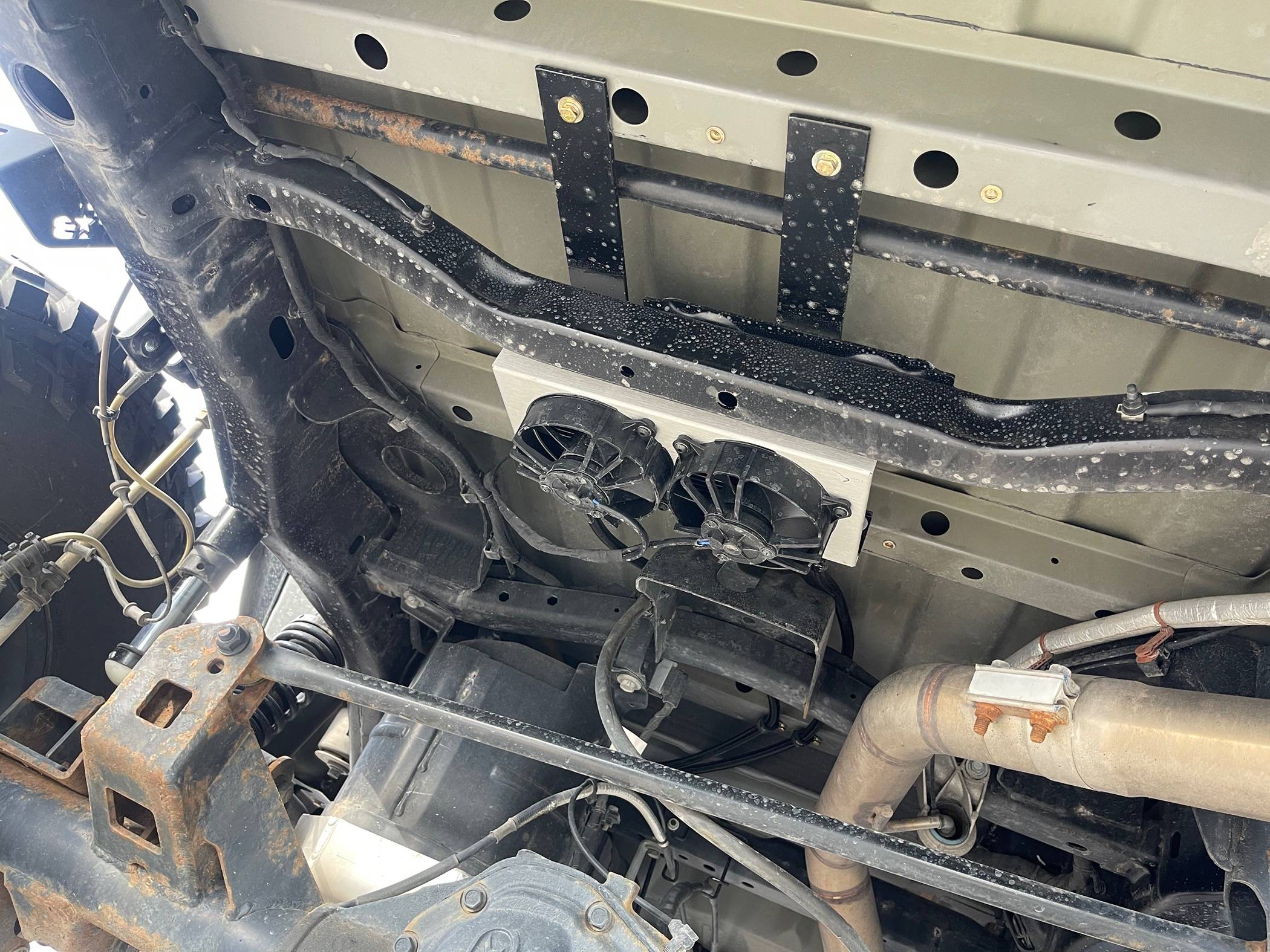

Do you have any pics of your cooler install? I have the ID kit but have not found a good location for the cooler...
I don’t run a spare under the bed so that’s where it is.
Ignore all the surface rust :(

After combing through this thread I settled for building my own and stuffing it on my front bumper as I use my Jeep for rock crawling and off-road only. I threw 4 fans on the back as well. This solved my de-rating issues going up I-70 and other passes when towing. I also had issues de-rating when cruising (no tow) at outside temps above 100F. I am on 37"'s with factory gears.

You've got oil running through this bad boy? Curious how hot the actual radiator gets, but that is some impressive manufacturing. Makes me wonder what I'd be up to if I had a heated and cooled garage space.
It's in the oil cooler loop so coolant only.
