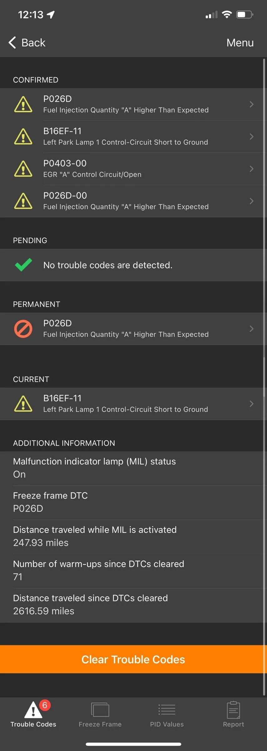

P00AF code at 7000 miles and every time I tow my camper. Probably 15 times total as now I am at 18000. It requires a power cycle and the engine power comes back with CEL for a few more cycles before it clears. It gets really annoying when you are doing 70 on a holiday weekend and all of a sudden you slow to 45mph. Plenty of fingers to go around.

27k on wife's 21 JLURD, gad burned harness issue
3k on my 22 JTRD, high pressure fuel pump toasted and egr harness bad
