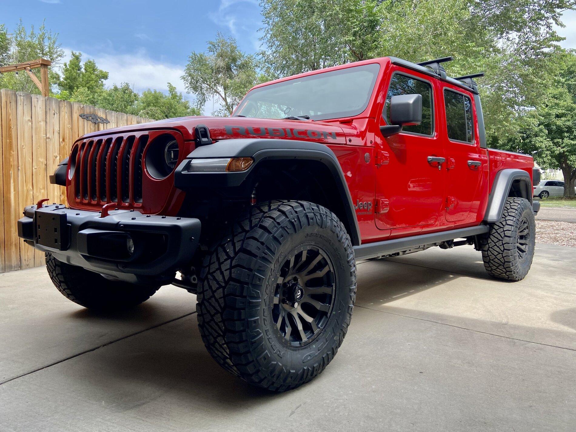

If anyone is curious. Same thing happens if you do the teraflex 1.5” leveling kit. With the 3/4” rear still bottoms out.
Hmmm...I used to bottom out over speed humps with the plastic bumper at 20-25... So I added the Terraflex 1.5 up front and DayStar 3/4 in the rear. Now with Steel bumper and winch, no bottoming at at 30mph. BUT, BUT, I did NOT use the terraflex bump stop extensions, which is a risk I guess, but I decided not to because the gap between the foam and stop was sooooo small before the spacers, and now it looks like what I think it should be.
Wish jeep would just send me a Mopar Lift kit and we could put this to bed :)
Creepy - Good looking Gladi by the way... the Red is really starting to grow on me!
Yeah there is no reason to install the bump stop extensions if you stay stock size tires. I would have left mine out as well!
I really think getting some hydraulic bump stops would make it so much better... But grabbing a saw and cutting up my new jeep isn't something I will do quite yet :)
