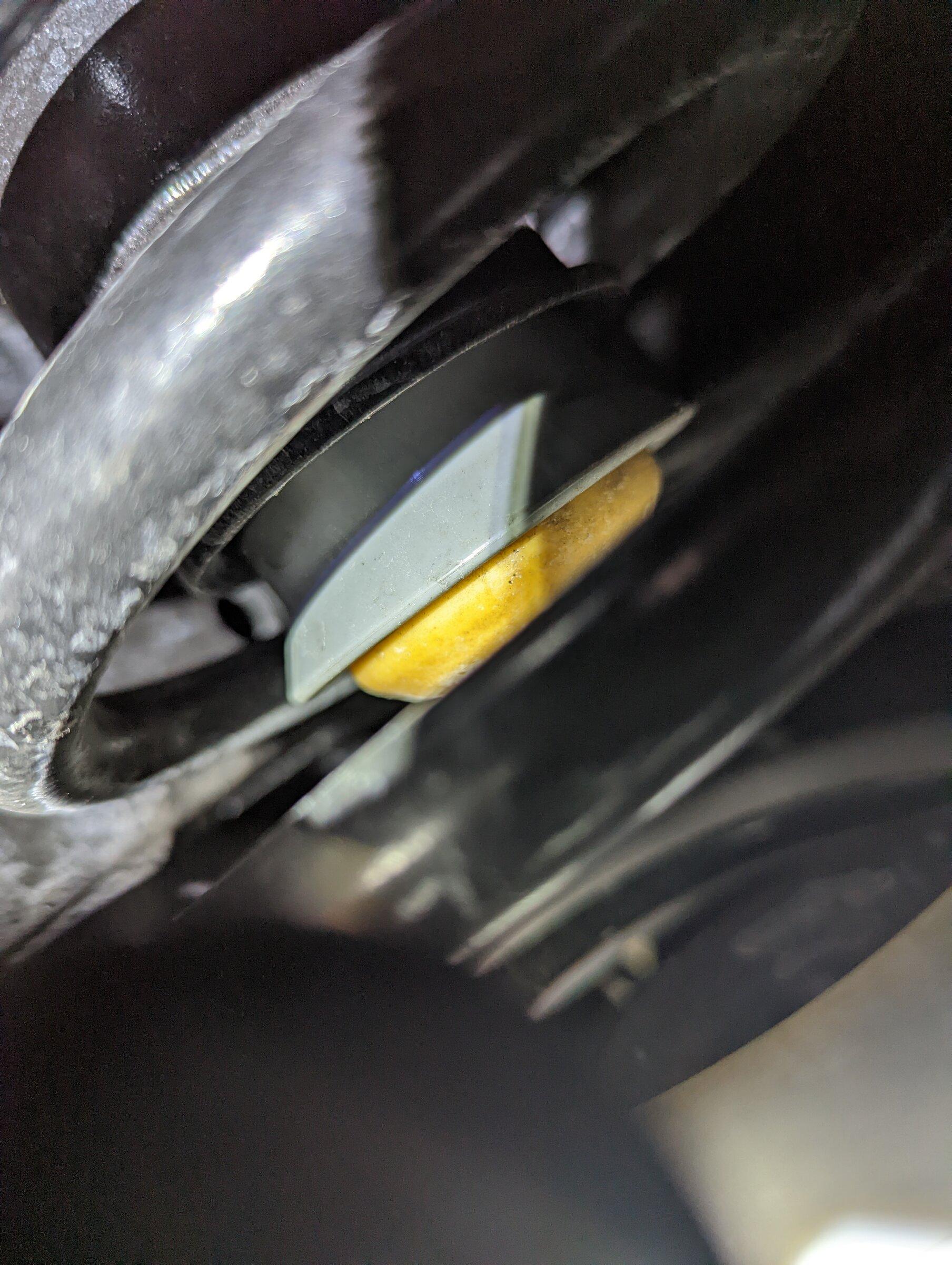

I have a 22sd and have the same springs on both side and what I believe to be updated bump stops I mentioned in another thread.
Jeep Gladiator Eco diesel Suspension bottoming out on normal roads PXL_20211228_000235024
That is a different bump stop, for sure. Do you bottom out as we all describe?

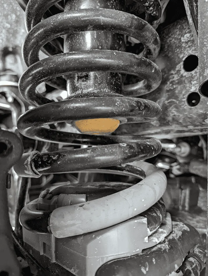

No, I haven't had any bone jarring bumps as people here and the video showed. I also don't drive my sport like a Mojave though for what its worth lol. I do know that it has contacted , as I did a chalk test.
Def dont have the mopar lift installed, Shes stock height but interesting if they actually are rubicon springs. @am1978 @SargeDiesel

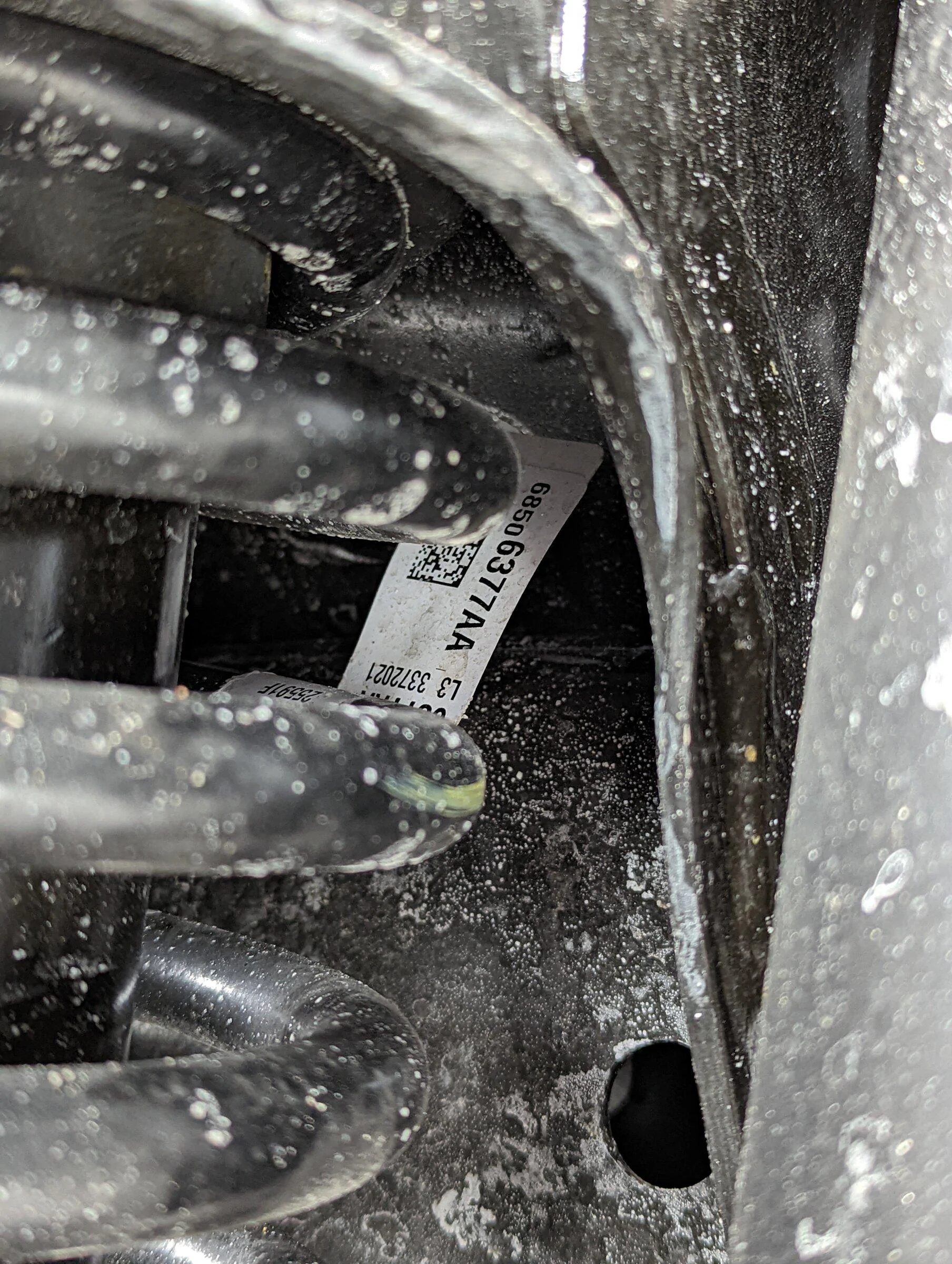

Here is a better look at the clearance I have

PackMule
Dean
Nov 22, 2020
190
174
Montana
2021 SingGray JTRD, 2012 Dozer JK, 2014 GC
InfoTech Retired
That 6377 spring is stock on a Rubi.
Yup... 6376AA, 6377AA, and 6378AA are the springs used in the 2021's, ... at least on Rubicons. Hopefully a '22 Rubicon owner like @SargeDiesel can check and report their spring numbers. 6377AA might be ok for a Sport, but questionable on a Rubicon.
'Cause if they DIDN'T stiffen the springs for 2022 Rubicons, and just put a neck collar on the bumpstop, like a whiplash patient, I don't think I'd trust this "fix"
