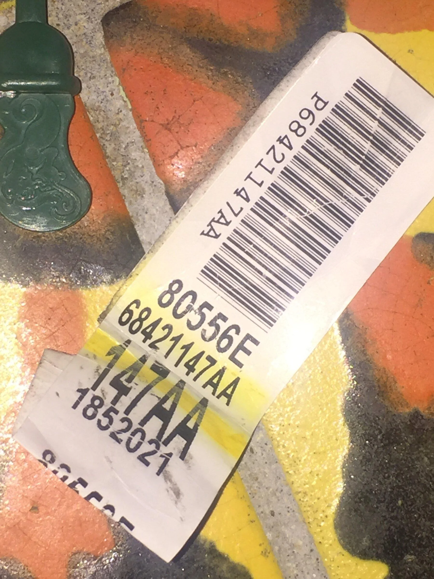

I have the 2021 rubi eco.took it back to dealer with 1200 miles for the bottoming out problem .
It was terrible. Googled the problem before taking to dealer and found this thread.told dealer about it and explained the springs just ain’t strong enough.dealer put stronger spring and it was better but not enough so they put a stronger yet spring .now I don’t bottom out on normal driving. Dealer people were very nice and
Said they would fix it . I am happy with it now
For springs part numbers see image

Any idea what they are off of?
So they arent specific to one side? Usually front springs are drive or passenger side specific.

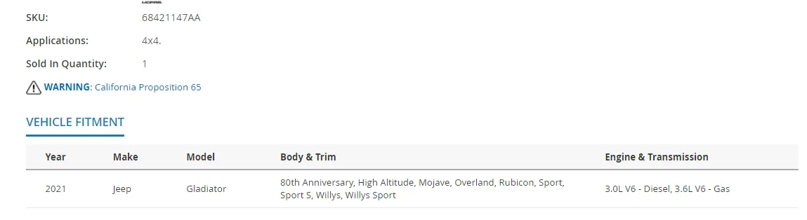

Everywhere I look it says that 148 is for a rear coil. Any ideas?
The real issue is the 150 spring. The documentation is wrong for that one.
