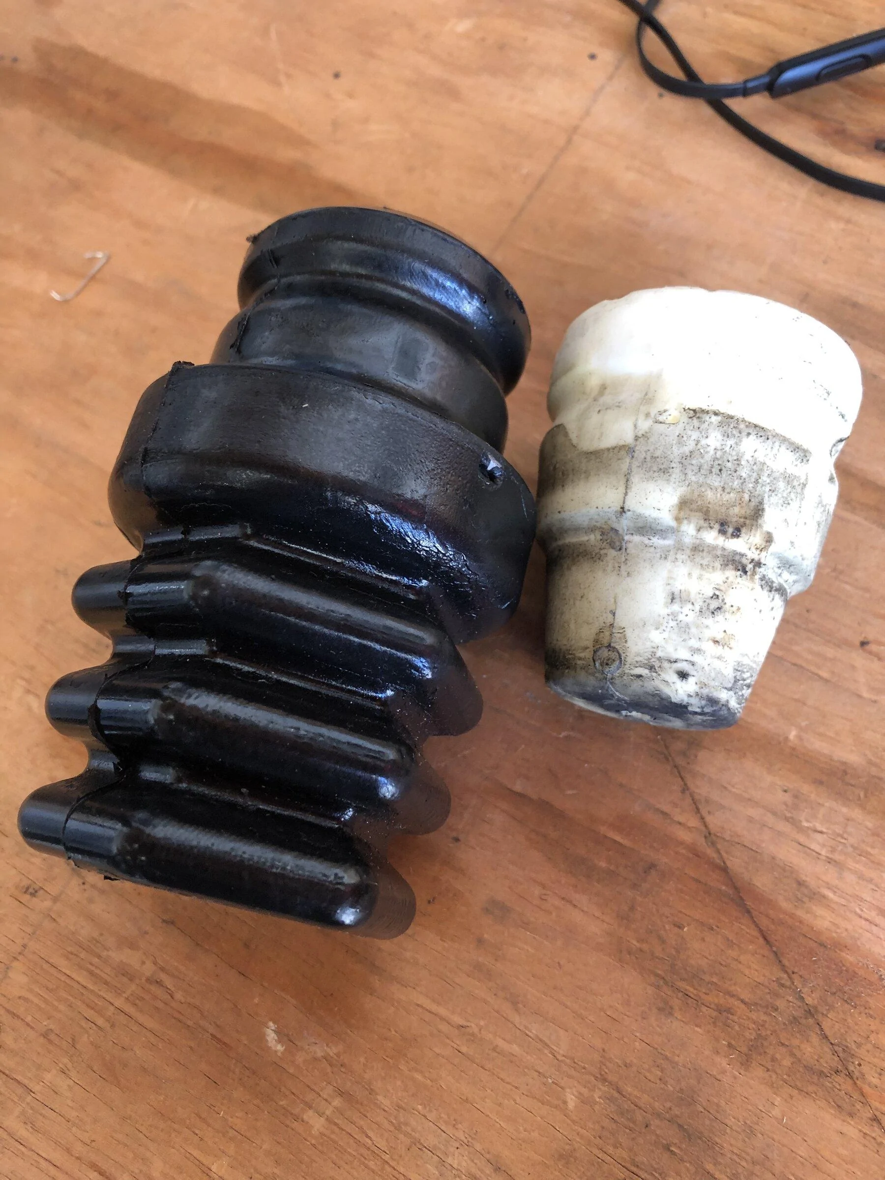

Installed some metal cloak bump stops and daystar 3/4 front spacer. Hopefully this takes some of the harshness out of the front end.
@kilroy173 I ordered the Metal cloak front bumps as well and was thinking to put a spacer in the front too. I read somewhere without one they can contact too soon and create harshness in the ride. My rear end is high after I added the Rock Krawler rear spring bow correction wedges (running 4.5" EVO lift) so a wedge in the front or longer springs is probably the way to go in the front for me which I am hoping works well paired with the front Metal cloak bumps.
I was trying to decide if the bumps would fit in the front as they look so much bigger then the stock ones, but I guess they do as you got them in.
How are the front bumps, engaged them yet?

The metalcloack bump stops fit with no issues. You do have to remove the springs to install them. I installed them at the same time as I was adding a 3/4 spacer to the front. They do make contact with the axle a little more now because they're longer, but I wouldn't say its harsh. It also takes away the metal-on-metal contact I was feeling with the factory bump stops.
