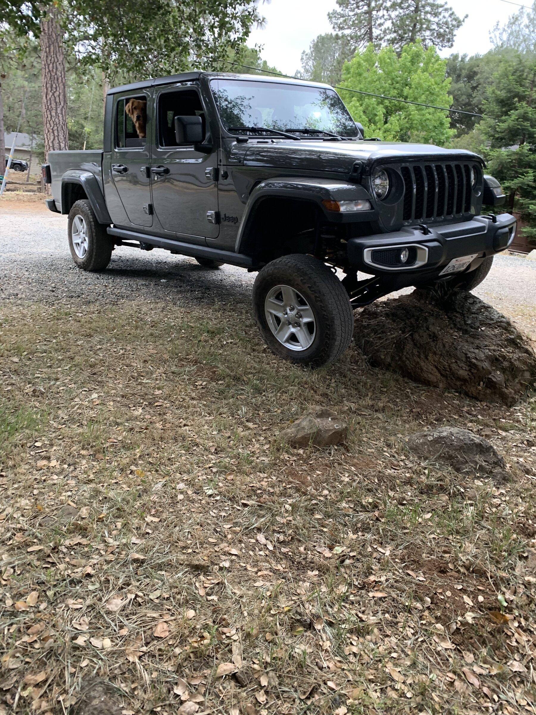

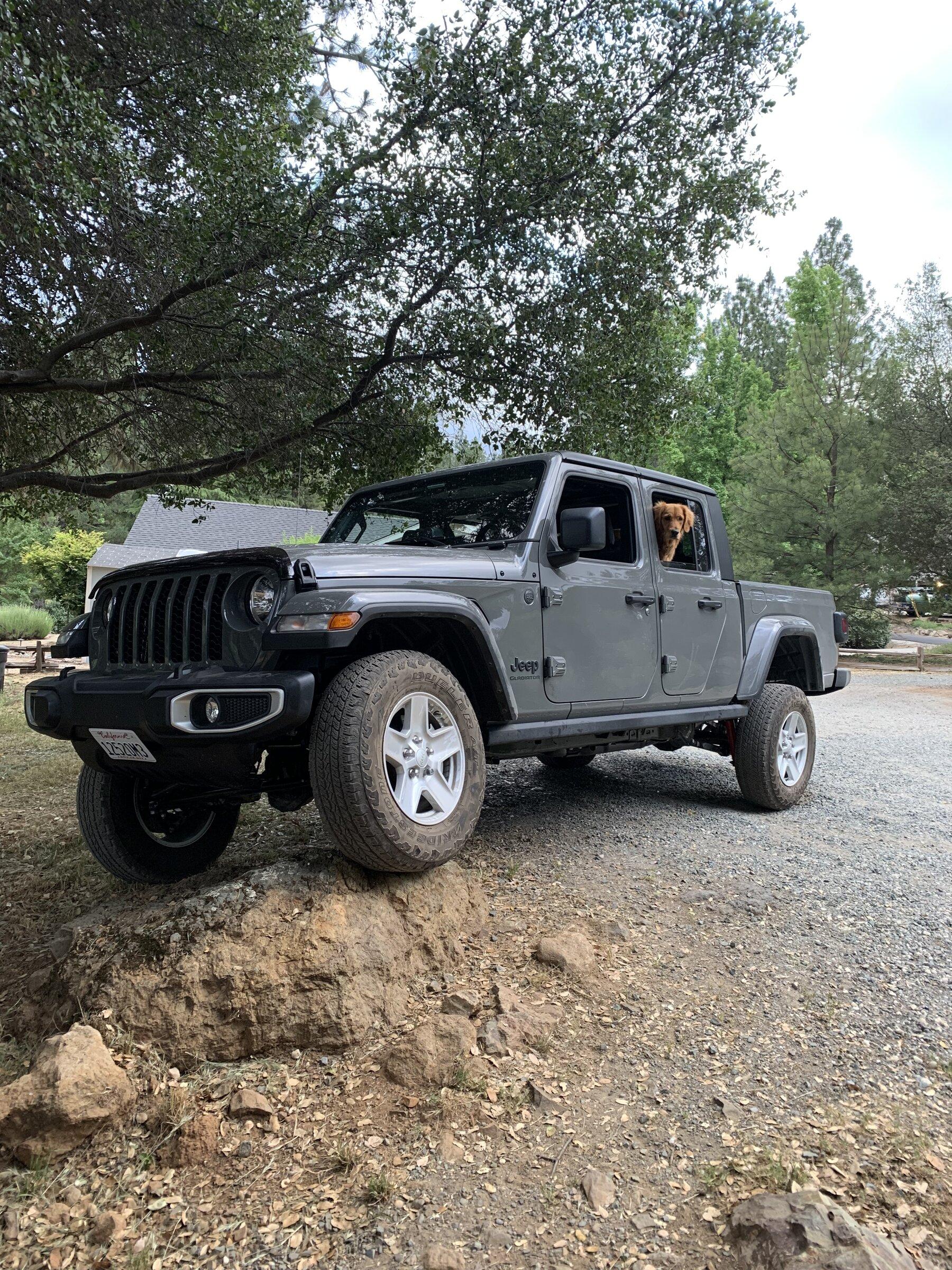

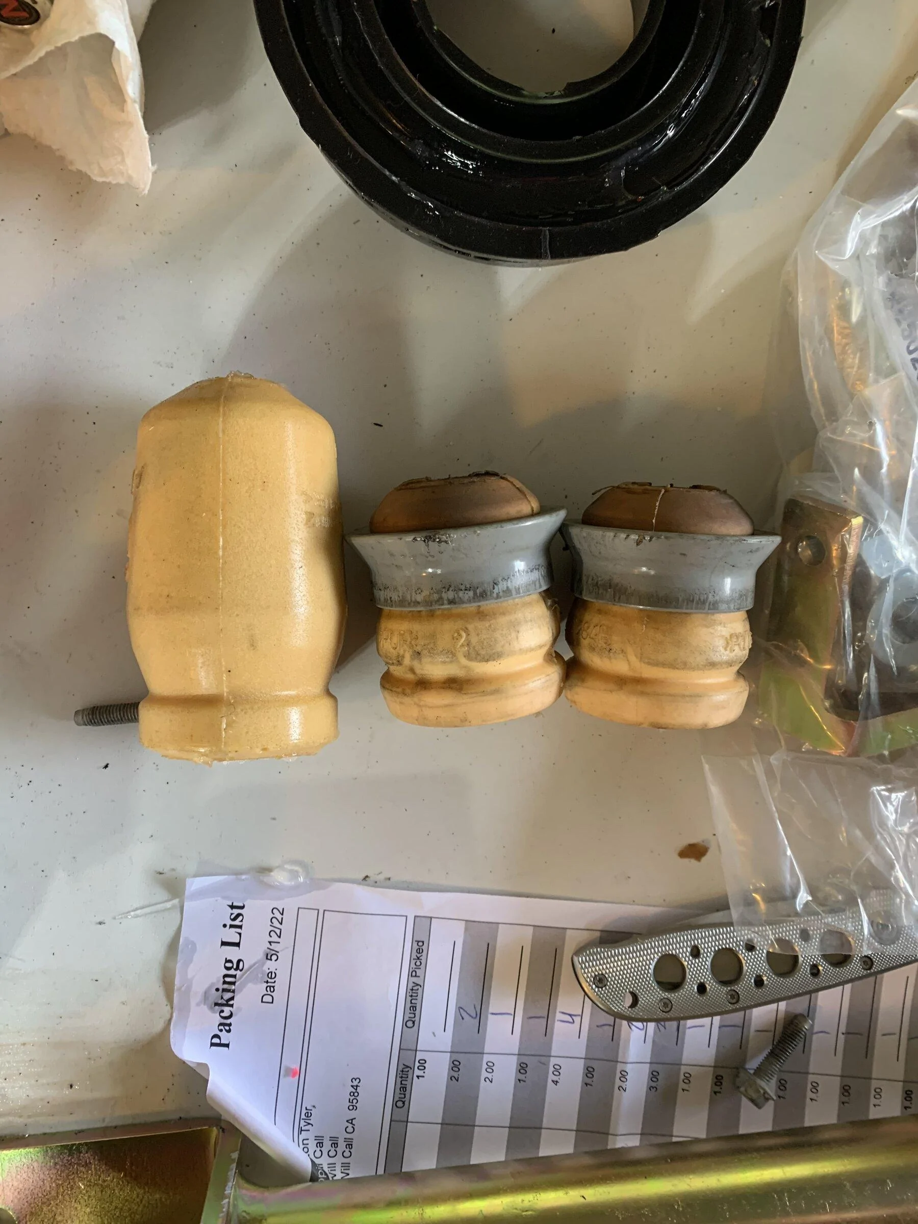

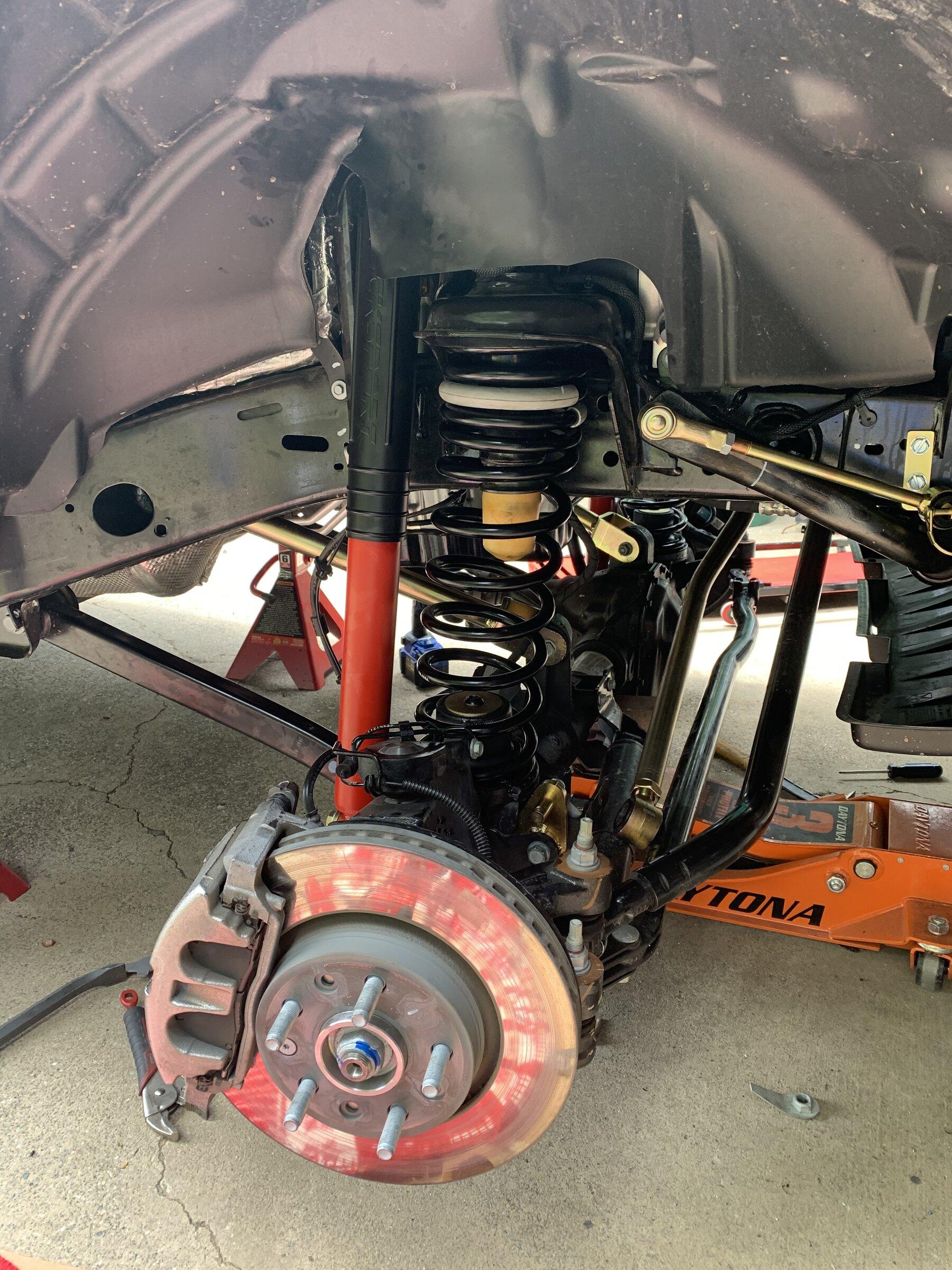

Just installed a metal cloak dual rate 3.5ā€ and oh my god it rides so much better than factory.
fyi dealers have a plastic spacer to reduce up travel on the bump stops. A cheap fix is the teraflex falcon bump stops for 99$ it will accomplish the same thing but keep the harsh clack sound away.
Really the diesel needs taller stiffer springs than factory to get more uptravel.

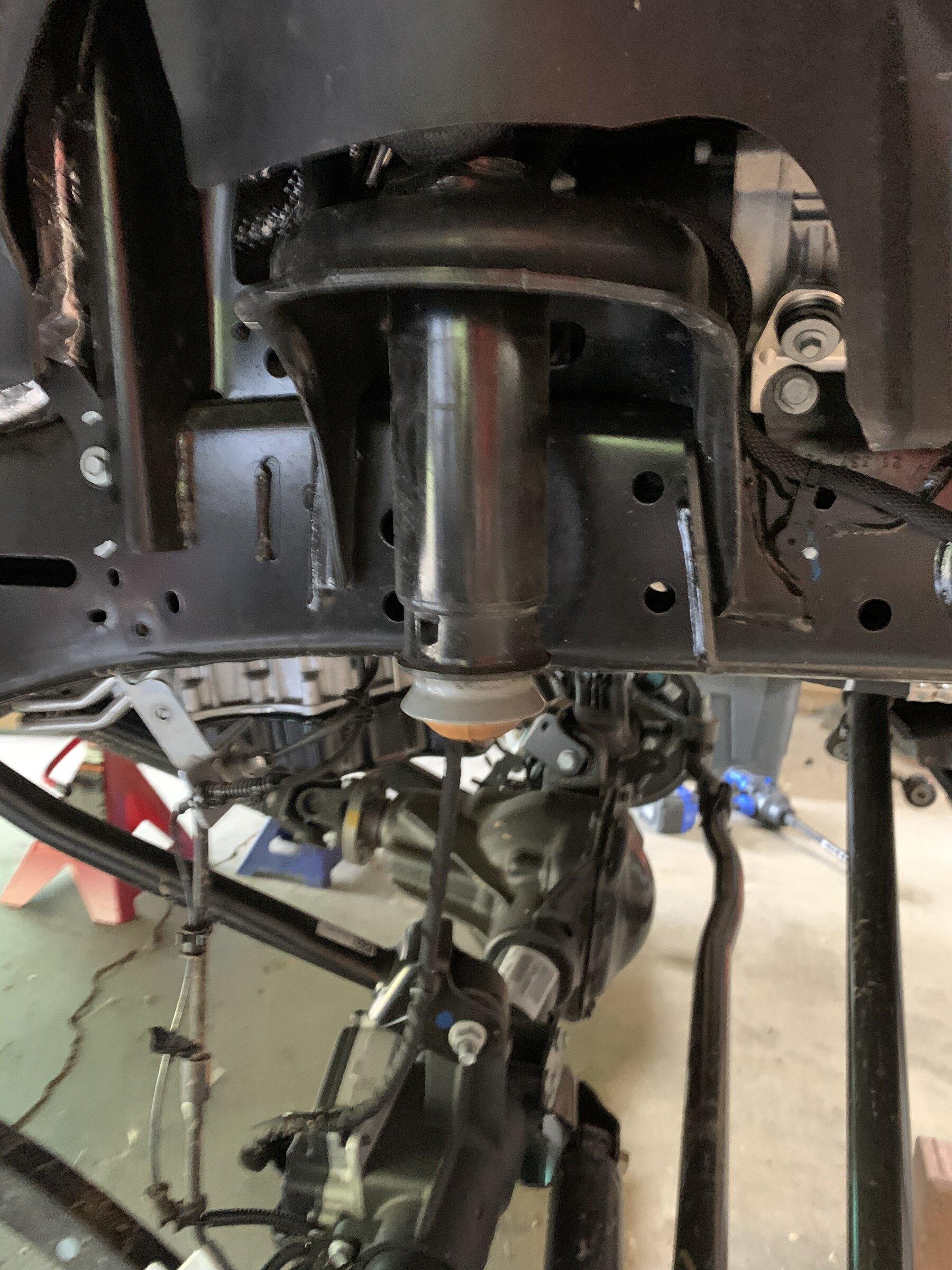

Sounds to me you need to change that dealer. Don’t give them another penny. You should be able to hand him a copy of the TSB and point out where the jounce bumper tower impacts the pad inside the spring on the axle. I had an oil and fuel filter services done at a dealer an hour away in a small town west of Gainesville, FL. Showed the service writer the TSB number. She printed it out and showed it to the tech when he did the fuel filter. When they were done with my service and recall flash, she said the parts had already been ordered. All the parts are in with the exception of 1 rear shock, which is due in the end of June.
