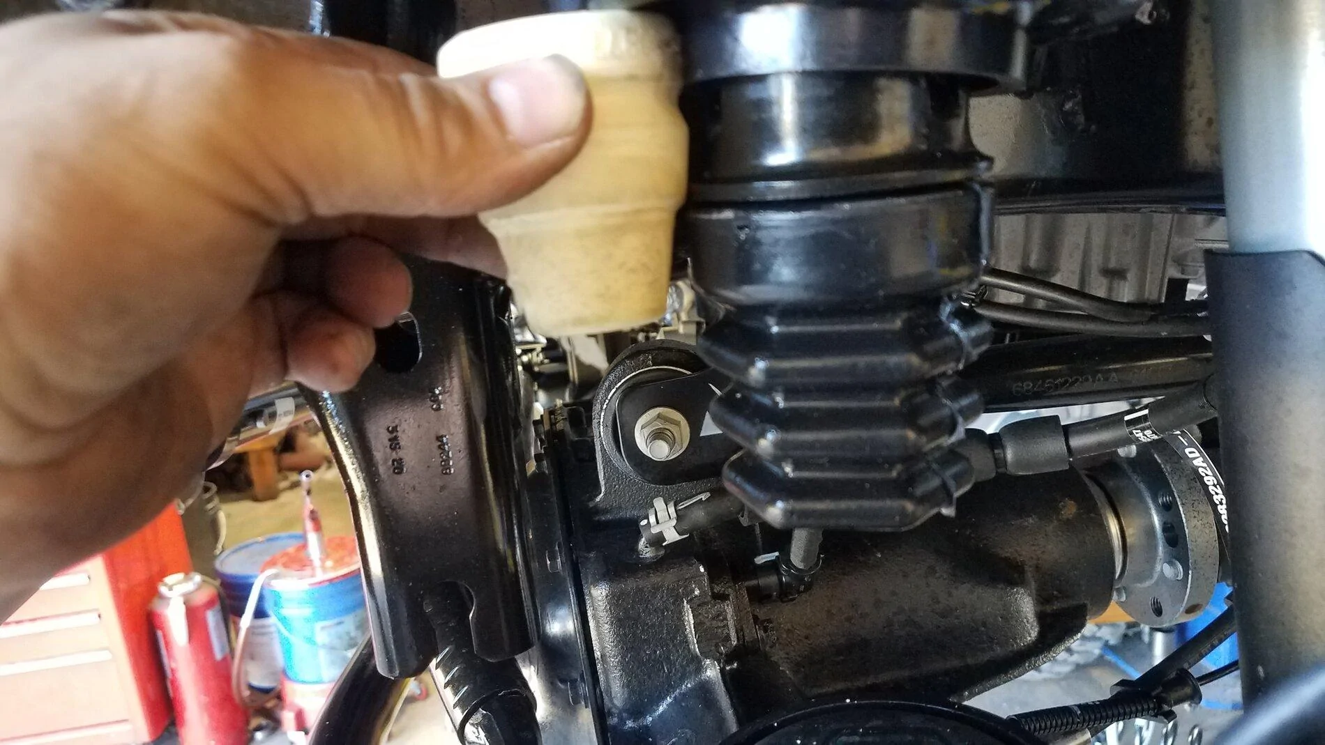

Got mine home last night.......yes, the thing does bottom a bit easy. Tossed on 1.75 spacers and a pair of Metal Cloak front bumps and it does hit the stops, but not as hard. These Fox shocks are a bit too soft for my liking, but nice on the highway.
Jeep Gladiator Eco diesel Suspension bottoming out on normal roads 20210213_110313
