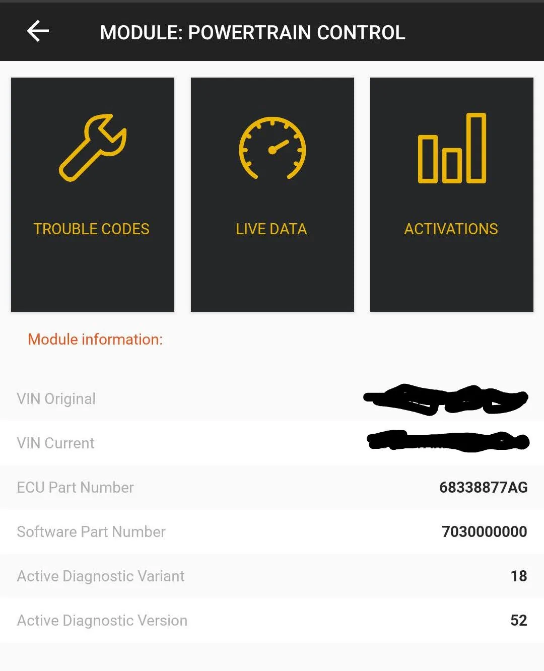

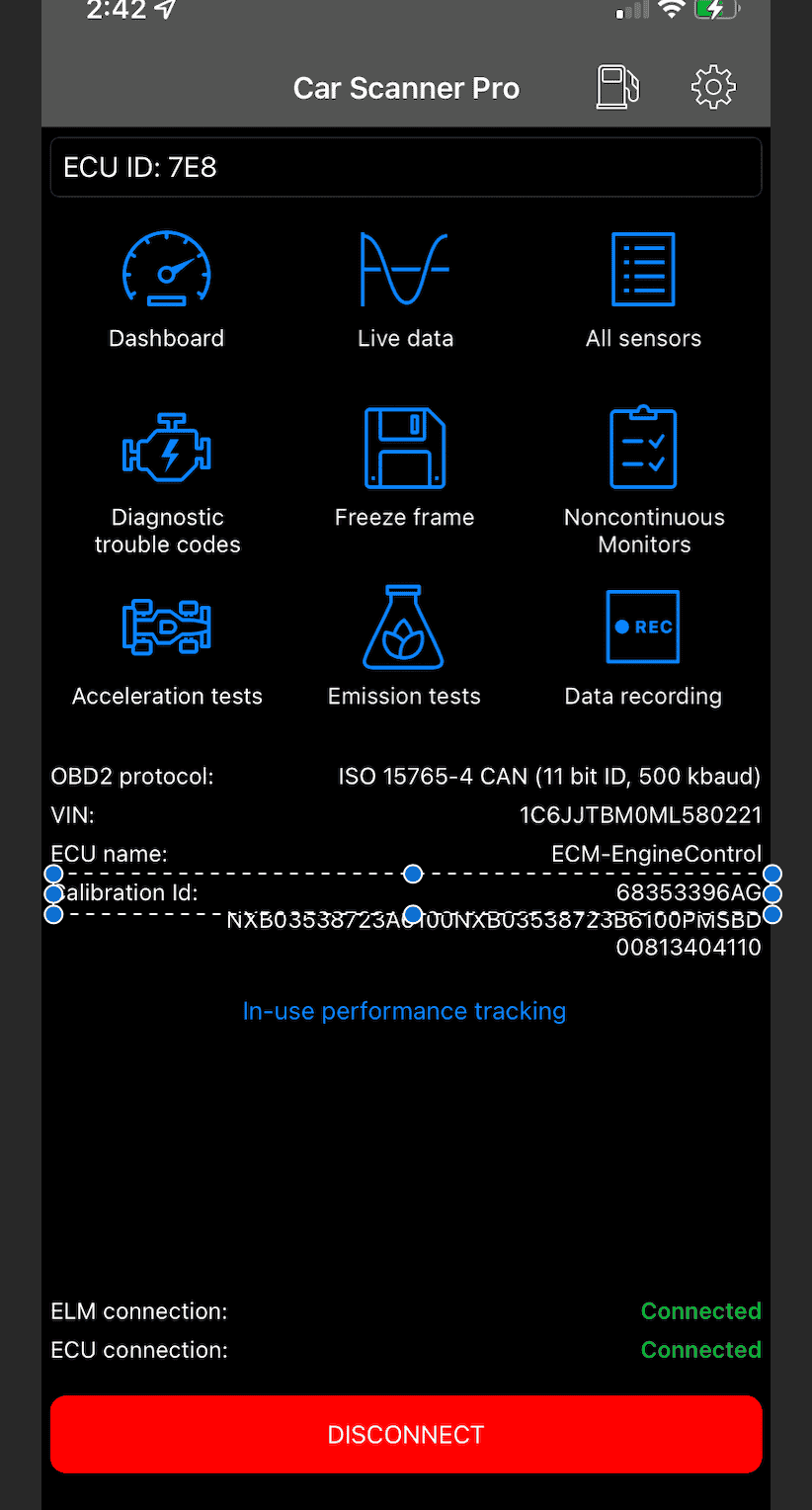

So I figured out how to tell which version of software runs on your PCM.
If you have a bluetooth OBD2 sensor, and you have loaded the dashboards I constructed several months back (temp gauges, DPF level, etc) You can see the software version is on the PCM.
Download and install Car Scanner Pro, and load it up with the EcoDiesel profile. Then simply connect, and it shows you.
Wow this tech must be a ninja for real lol. It is updated to AG. He must've connected the handheld device before he drove to the bay and disconnected while pulling out.

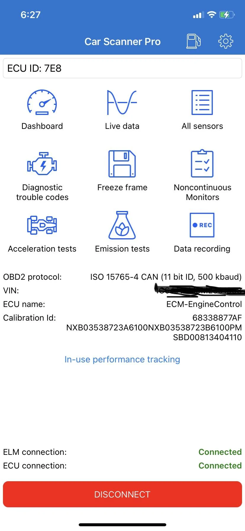

Checked my PCM/ECU version. Here is what I saw. This is after the recall procedure.
Your ecm/pcm flash ID are same as mine. Don't why some vehicles are different.
