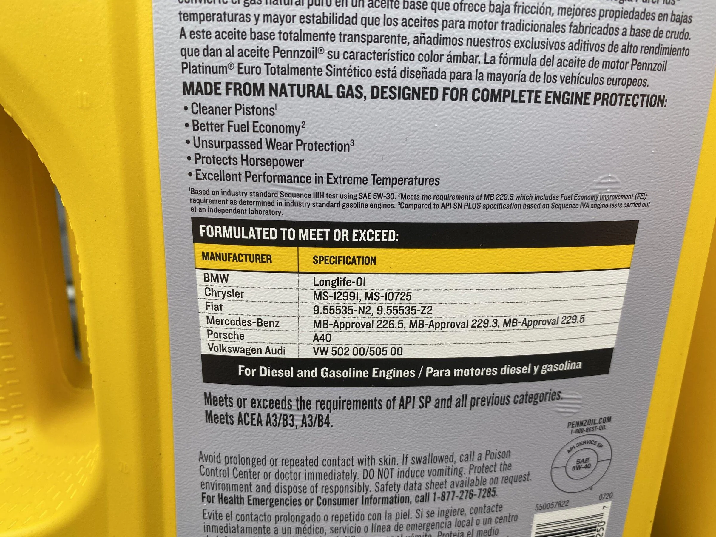

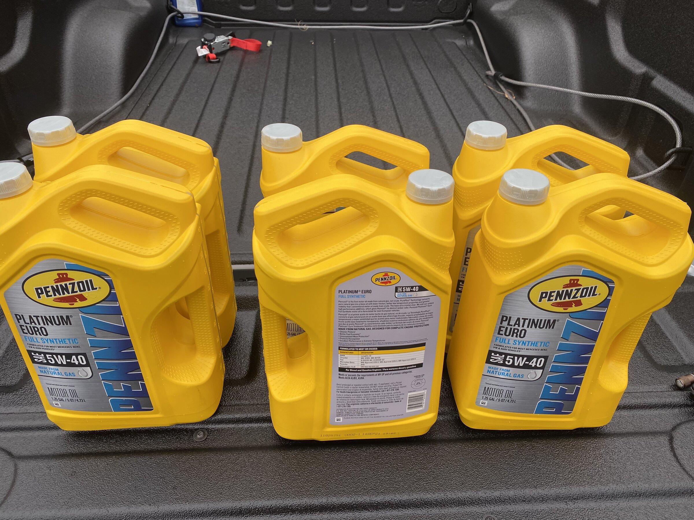

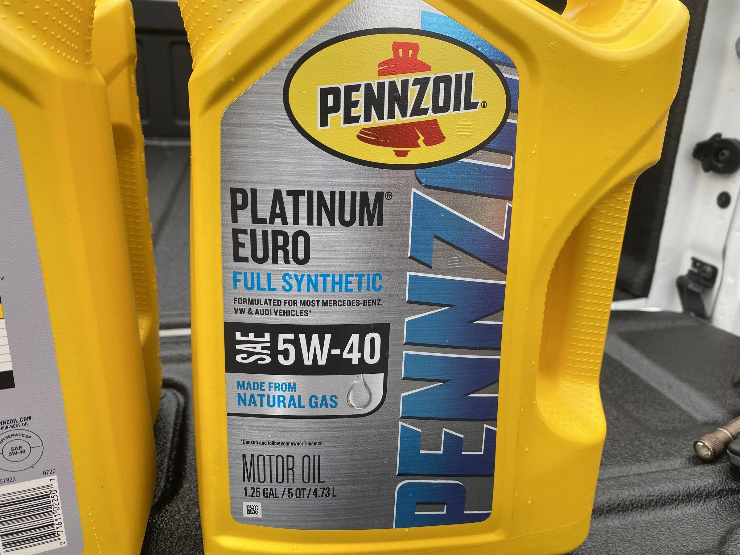

You may want to look into the oil the dealer is using. At my first oil change they told me Shell that’s not approved. We had a big sit down and they had to go pick up the correct oil.
Are you talking about this Shell that states it’s MS-12991 compliant? This is what the manual says to use.
