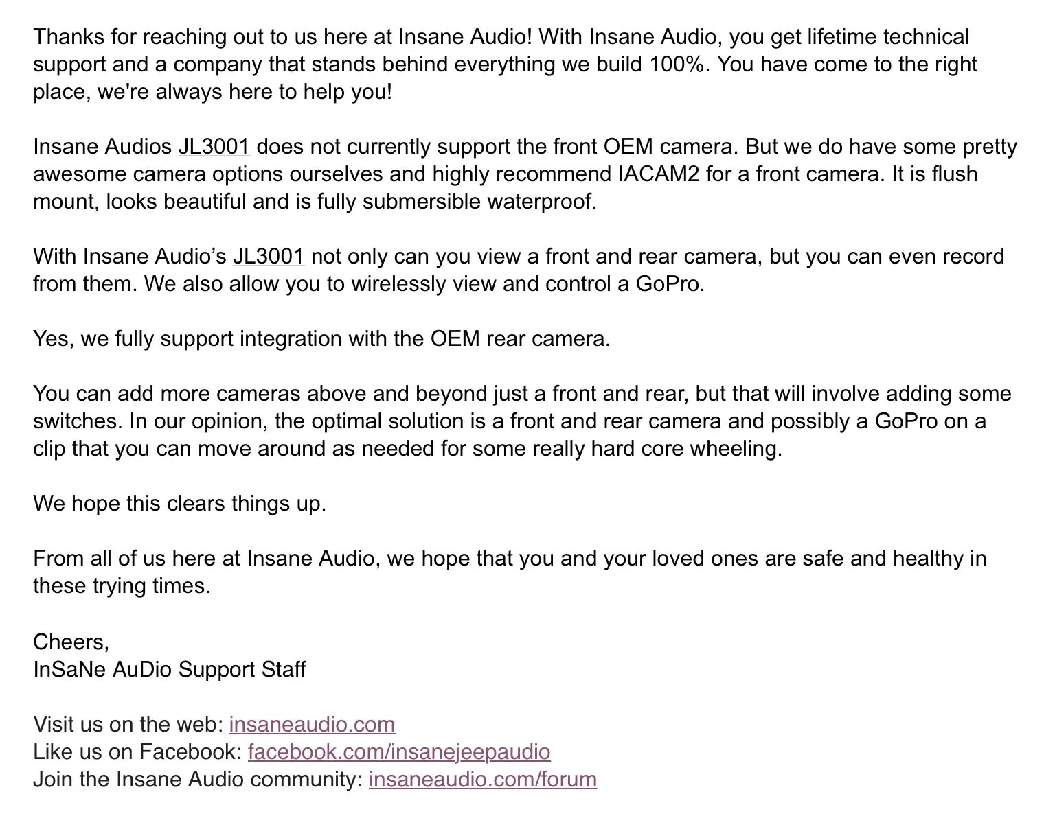

I’m still waiting for the diesel but I’ve been running out all my build details to the Nth degree in the meantime
I contacted Insane audio because I feel their head unit is vastly superior to the 8” U connect and is cheaper in terms of cost to add on a sport with the factory 5 Or 7”
here’s what they said about adding cameras

Sounds cool for those who want to replace the head unit. I myself want to keep the oem. Chrysler has one of the best UIs around. This thread is geared more towards those who want to integrate the oem system with an oem head unit.
Inane audio is pretty cool tho!
I guess I was delivering confirmation that it’s more complicated than just plugging in cameras.
