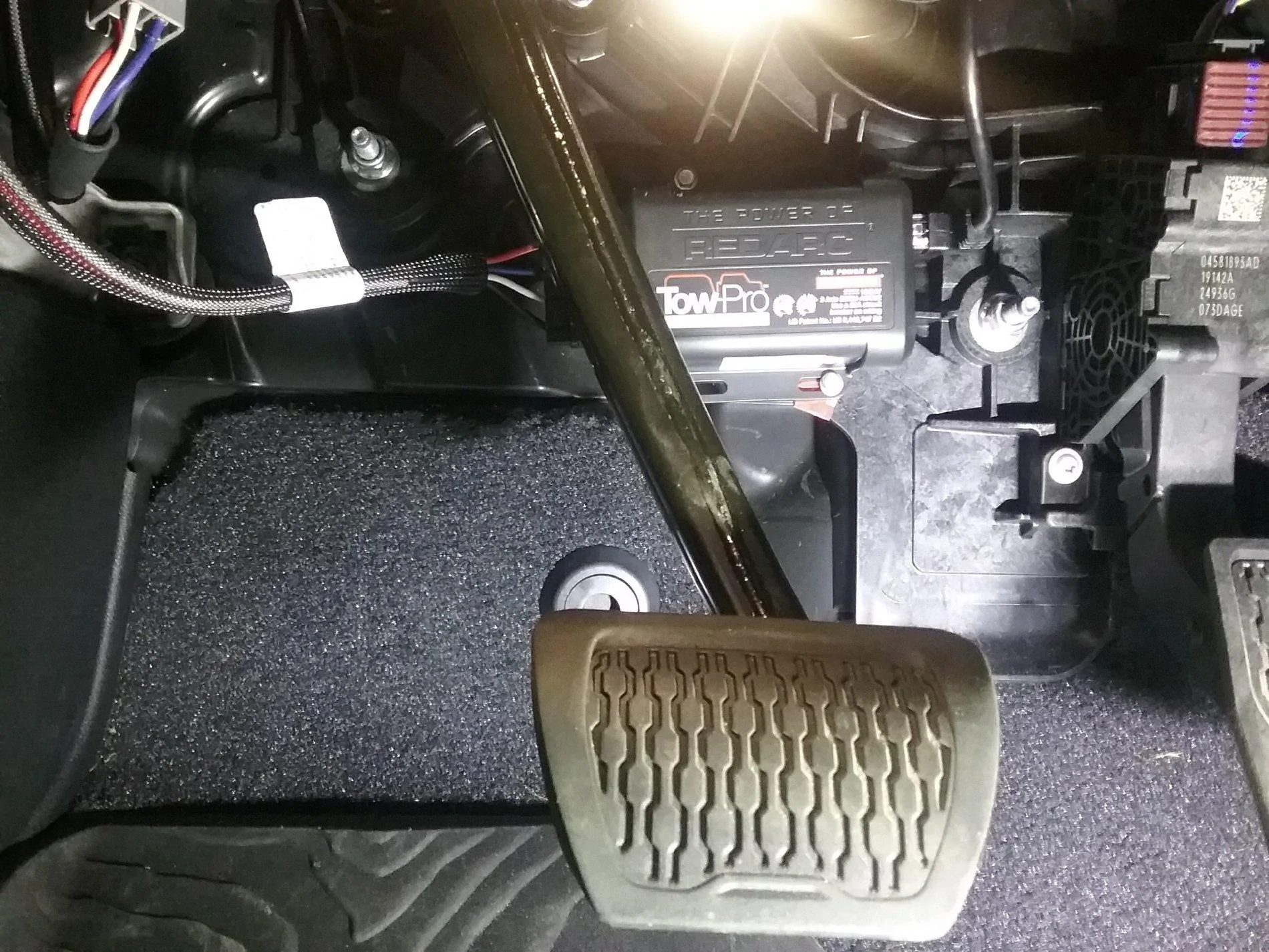

Was the wire swap just a simple pull, or did it require re-soldering?
Probably release the finger or catch in the connector, remove, reinsert into other holes. Guess based on hundreds of connectors I've build and modified. Most pins and socket press into the shell and can be released - unless these are those really small sealed connectors.
Will be interesting to see how he really did it - I have to tow before April - this really sucks.
I will apologize in advance, I did not take pictures of the pin swap, but it was super easy. There is a white locking clip on the connector, you release it from both sides and pop it out. Once that is out, you can use a small straight screwdriver, pick, or even a thin pocket knife to push the tab that hold the pin out of the way and pull the pin out. Removed both the blue and black wires, and put them back in the opposite cavities and push to snap in. Then take the white locking clip and snap it back in, and you're done.

I pulled the factory outlet over behind the dash on the passenger side of the JT. You just have to remove the glove box and access the area. I then plugged my dash cam into it. If you wanted to you can splice it from there to anywhere in the truck. There is just enough length to get it to the glove box.
It would behoove Redarc to to have somebody video this entire install and post on youtube. The install on etrailer is amateurish. I suggest we have Waxman go with the Redarc and do a video for the sake of towing members of this forum. In fact he should offer Redarc his service and they could compensate him after all the Gladiator is available in Australia.
Now the unit mount was good in the etrailer video but I mounted mine down on the firewall.
