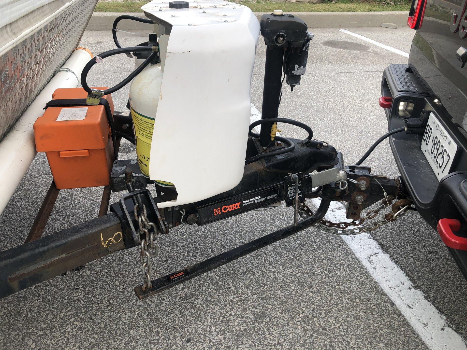

I have only towed my Toy Hauler empty so far...about 4400 lbs. watched all temp levels and no issues, even with climbing some pretty big hills. Fuel economy sucks pretty bad with the revs up, but flawless towing.
I have a weight distribution hitch with integrated sway bar, so that surely helps.
Jeep Gladiator Finally available! > 2020 Jeep Gladiator Accessories - Trailer Brake Controller - 82215652 70545640-508F-4F1E-9B87-B8331BAD8403

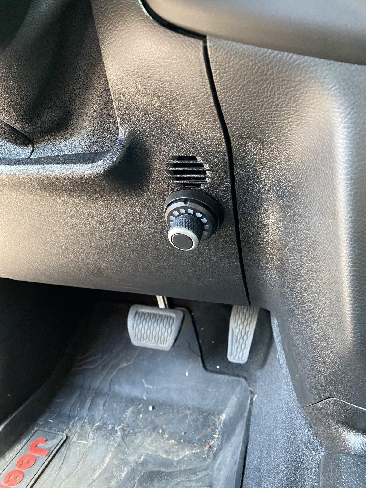

H

VirTex
Gabe
May 30, 2020
Military
The new curt harness for the Gladiator is the same as the Ram one we have been using except they swapped the blue and black wires already. Probably seen many posts from here or other sites of the mod needed and realized they could fix that easy enough.
Personally, I had bought the Ram harness and swapped the wires and ended up upgrading to the spectrum controller (had a curt discovery prior to this that worked but was an older time delay controller as opposed to the motion sensing of the spectrum)
Just got back from towing my 18’ cargo camper conversion (7x16x7high w/2’ v-nose) that I weighed at a truck stop with just Fridge, microwave, fresh/grey/black tanks empty and normal camping gear totes loaded. Came out at 4000 on axles and 600 on tongue. I added our luggage, food in the fridge, a set of 37” tires and rims (89# each) and the generator (90#) and it pulled it great. No issues! Once I got it dialed in as to strength and sensitivity, I never messed with it again and every stop was smooth regardless of how hard I hit the brakes.
As a side note, I need the 12v plug for my electric cooler so I used the sticky mount and put the control knob next to the tip of the parking brake below the 4wd shifter. Worked great with easy access and easily reachable while driving.
Can you post a picture of where you mounted it? Thanks!
I’m about to tackle the install this week and wanted to place it in a location that wouldn’t be in the way, while also allowing me to remove it in the future if I decided to go with the ever elusive factory controller.

Pictures please.
I didn’t take any pictures. If you have the harness then you will swap the blue and black wires. There is a video showing the install. I believe it’s in this thread. Check it out or maybe someone can post a link.
