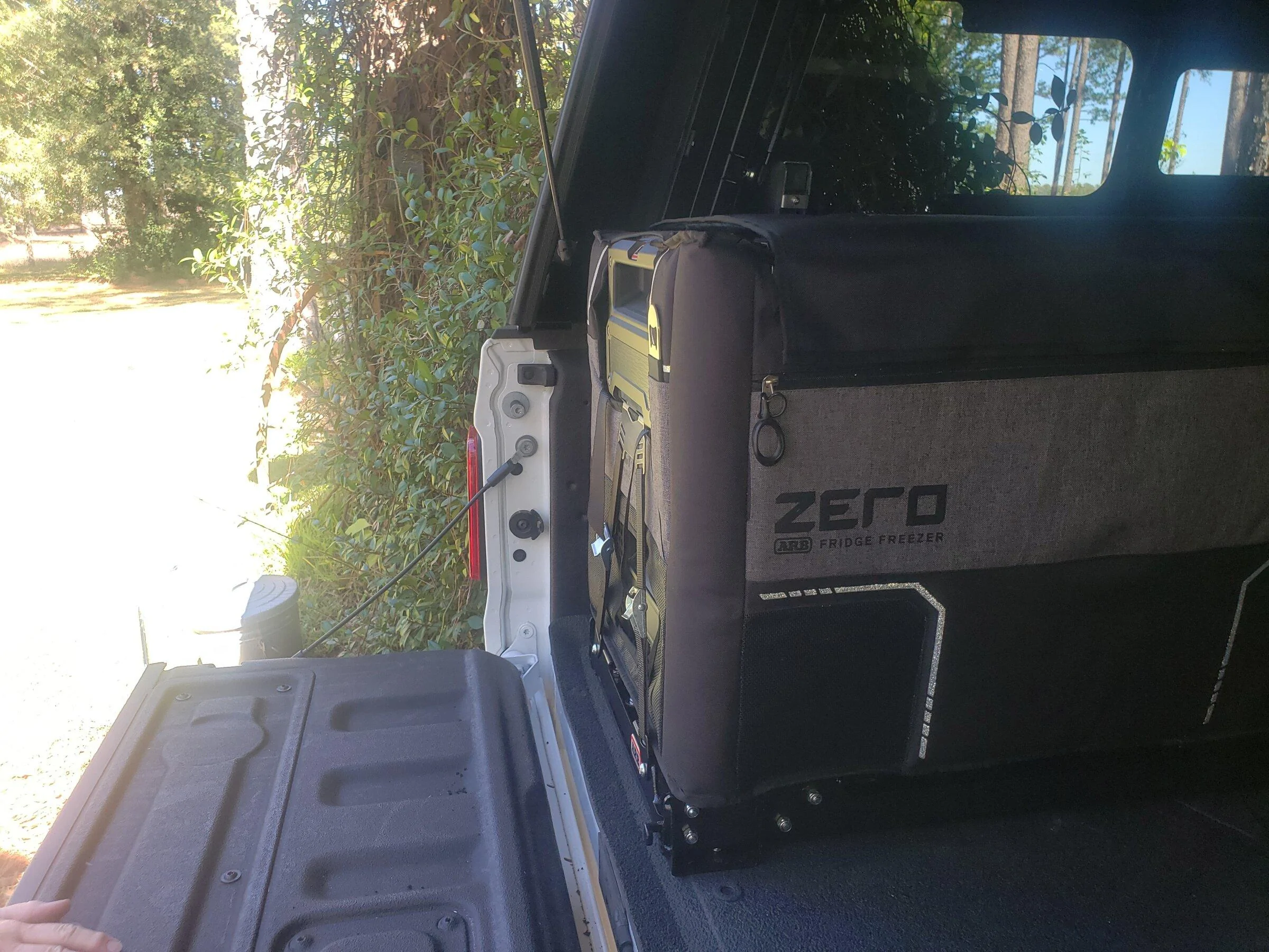

In the bed on a slide works for me. I'd like to keep the seats open in the cab. It's not a big deal to take the fridge out, but the slide will take a minute or two to get out.

Old post but worth a shot, how did you mount the slide in the bed? rivnut to the floor?
I have a rubber mat on the bed floor and the fridge slide on that. The arb slide is bolted with 1/4 inch stainless hardware. Rivnuts would be a better choice if you plan on removing it. The predrilled holes in the ARB slide align the the reinforced ribs under the bed. It is not just bolted to the bed floor.

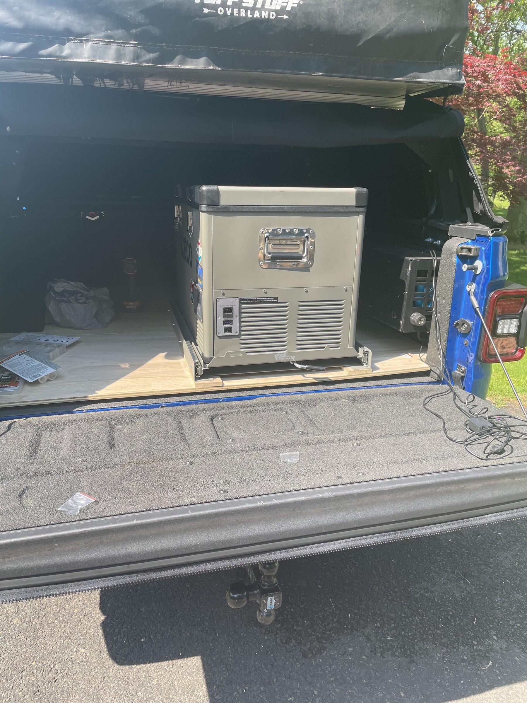

no issues? happy with that install method?
Here's another vote for rivnuts. Been in there since '21 and no problem. Did make a base plate for the bed out of 3/4 birch to mount a drawer slide on and got longer bolts to mount the fridge/kitchen slide over the base plate.

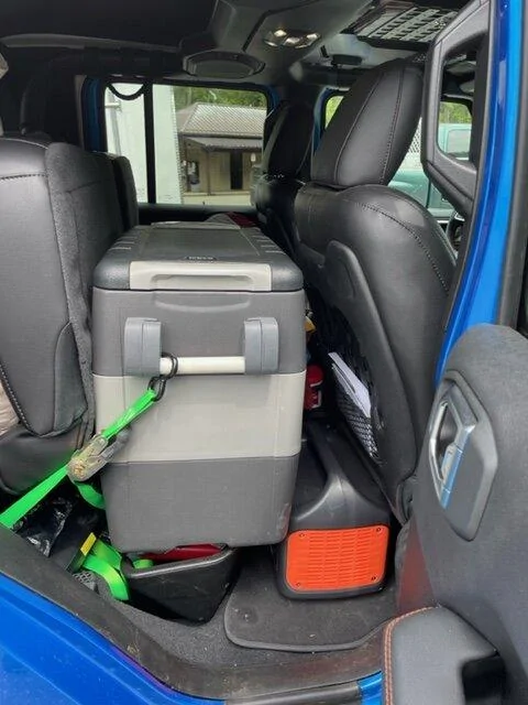

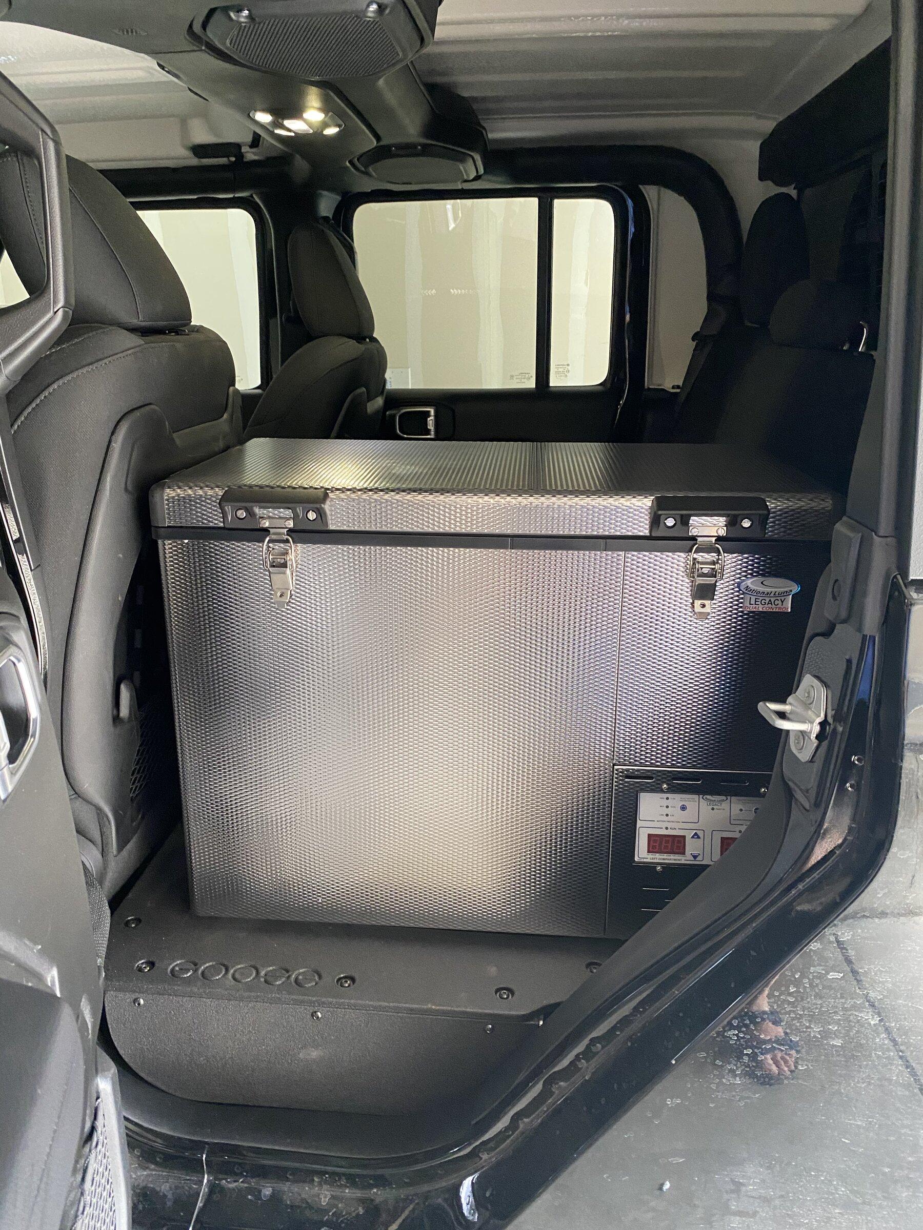

I went with the cab for more room in the bed. I have the Goose Gear 40% seat delete and 50L National Luna fridge/freezer combo. it is a perfect fit behind the driver's seat. I have a 12 volt plug going back to the house battery in the Alu-Cab.

Do you have your fridge strapped down to the goose gear platform?
Yes. I installed
Yes. I installed 2 low profile strap loops on the platform on each end and run tie down straps through each handle. It is very secure with zero movement or rattling.

Yes. I installed

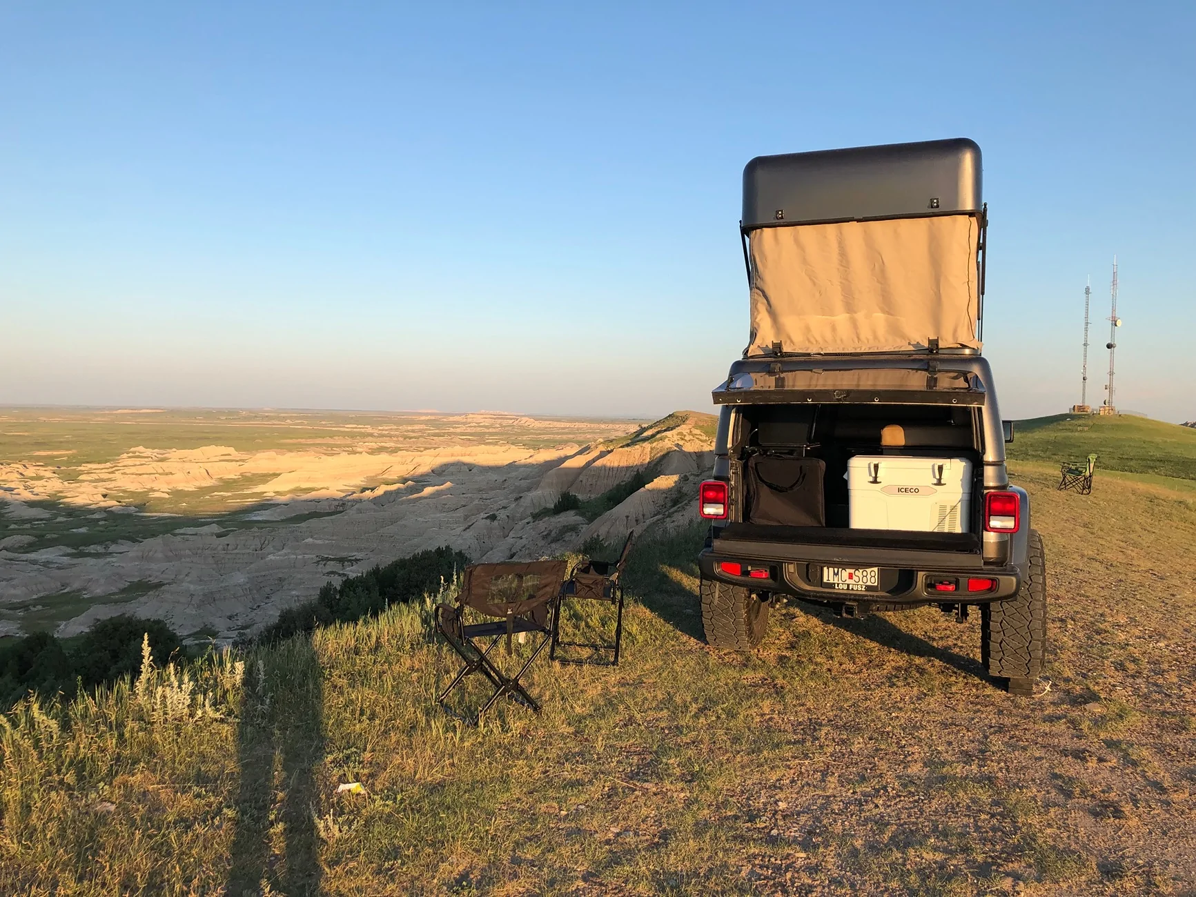

I’m not sure how much rain they can take. I keep mine in the camper.
