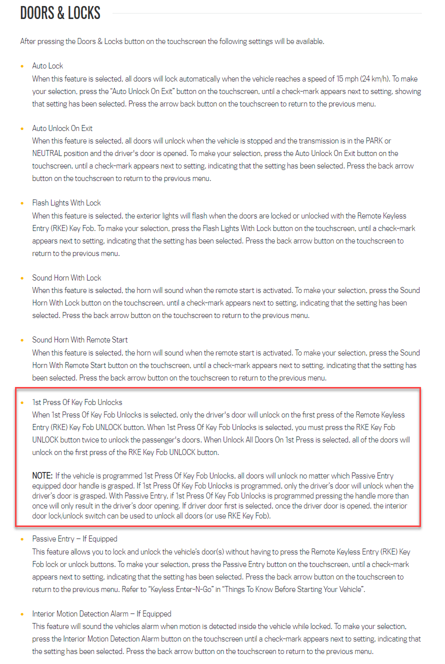

...I have the Rubi with proximity....its actually quite handy. Just wish it would also open rear doors not just the drivers...
A bit off-topic here, but if you're talking about the proximity entry, there should be a setting in the radio that allows you to change it to "All Doors". It's under the "Doors & Locks" section of the Uconnect settings. I set this to "Unlock All on 1st Press", so when I grab the driver's handle, all doors (including the tailgate) unlock.
Jeep Gladiator Get creative challenge. Bye bye push to start button. 1649423773737
EDIT: The "Note" sucks. The first line should say "If the vehicle is programmed with "Unlock All Doors on 1st Press", all doors will unlock no matter which Passive Entry equipped door handle is grasped." That's what you're looking for.
I think what he means is the front door handles are the only ones with the feature. It drives me crazy too. I have proximity key but need to touch the front handle to unlock the rear doors, if my hands have something in them it’s already a PIA and now I have to touch one handle just to open the other
