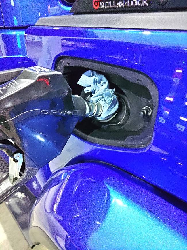

I think this issue has to do as much with the wide variation in speed/volume of gas delivered from pump to pump, as well as the fact that the fill tube is a rather small diameter running to the opposite side of the truck under the bed to enter the tank.
Have found that doing the paper shop towel trick , and only running the trigger of the pump at the next to highest detent rather than full blast seems to cure the problem.
I really don't lose any sleep over it, or feel the need to bellyache to the dealer.
