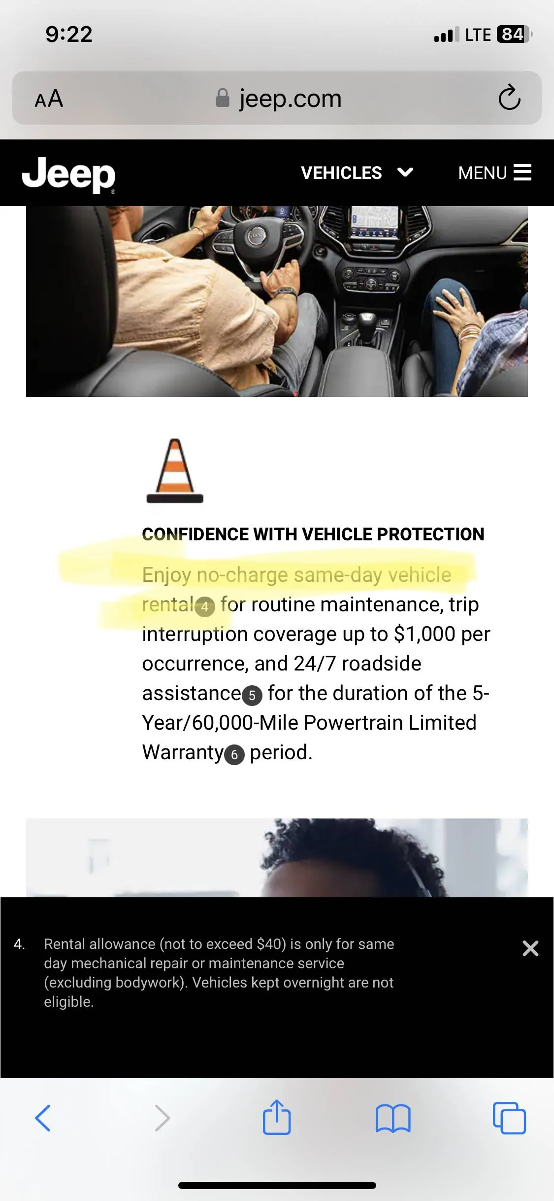

Kate could you please explain this statement on the Jeep Wave website? I don’t see where it says based on availability as you stated, I even included the fine print.
There is zero reason that anyone who spends $40k plus on a brand new vehicle should then have to purchase a rental out of pocket to have their new vehicle fixed due to a factory or design flaw that is in no way caused by the customer.
Subject of loaners and rentals has been like a beaten dead horse in other threads here. You are not going to be able to internet lawyer this to your satisfaction to force anybody's hand.
Jeepcares also will not get in the weeds with you on this. They just state their canned responses, not explain them past the surface details.
I haven’t been in all the threads and didn’t know about the horse beating. I also didn’t expect any significant changes but rather I just wanted to point out the hypocrisy/false advertising whatever you want to call it. I am not threatening lawyers or anything like that, but I do know jeep monitors these threads, if they start loosing market share to the Bronco maybe they might care begin to care. Think of it as my way of completing a satisfaction survey I wasn’t asked to take. ?
