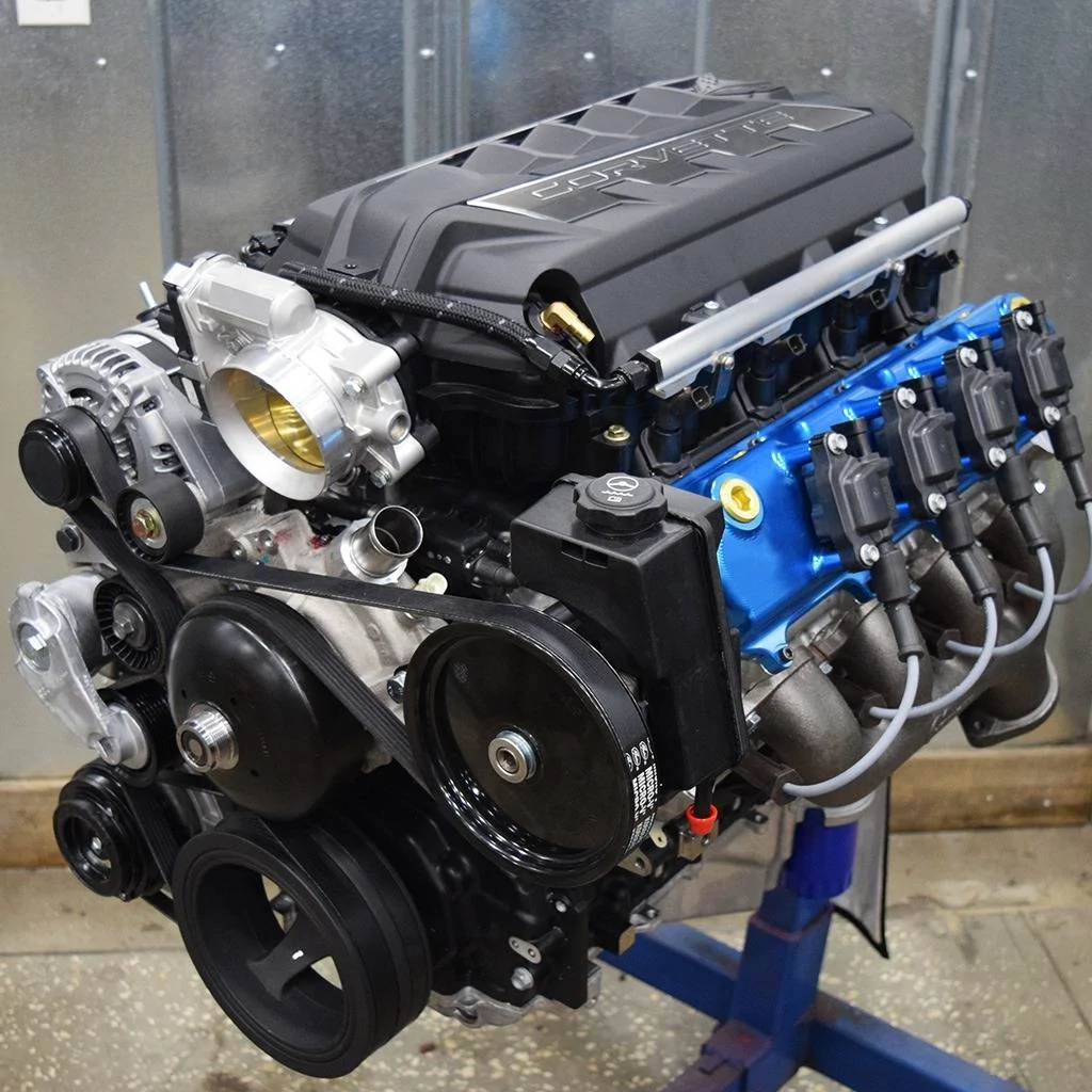

Bone stock LS7 will put a big smile on your face and be super reliable.
Jteakus
Teakus
Feb 19, 2022
1,869
3,431
Oil City, LA
LT4 would put a really big smile on your face

So there's a few swapping companies out there. Bruisers, AMW4x4, RubiTrux (pretty sure they just install AMW kits). I'm not seeing a powertrain platform in the future of the gladiator worth holding out for. I like my Mojave and want to keep till one of us ends in some way. the 3.6 ain't it however. Its a motor, and it works (most of the time). But its the instant mash potatoes of motors as far as I'm concerned. Generally these kits cost in the 35-55k depending on the power your looking for. So I'll list some basic info about what I'm considering and ya'll give that good ol' $0.02 bout it.
Bruisers - LX3 6.6 V8 550HP - stock trans (yikes) - $34k (for a stock trans setup, oof) - plug n' play - 93 pump gas
AMW4x4 opt 1 - 5.7 HEMI V8 395HP 410FT-LB (do ya need more?) - 8HP750 trans (nice) - 34k (still a kick in the pants) - plug n' play - 88 pump gas
AMW4x4 opt 2 - 6.4 SRT HEMI V8 505 HP 475FT-LB (thats alot) - 8HP750 trans (nice) - 36k ish (is the extra power worth the small price change?) - plug n' play - 91 pump gas
DIY - source a LS 5.3 and figure it out. (easy way to ruin a 50k truck and end up on jack stands for a decade, lol)
Magnusson - 3 LKQ spare motors to go with it - need to source a different ECM- 20k
My vote would be for the 6.4 Hemi. 2k extra for the extra power is worth it
