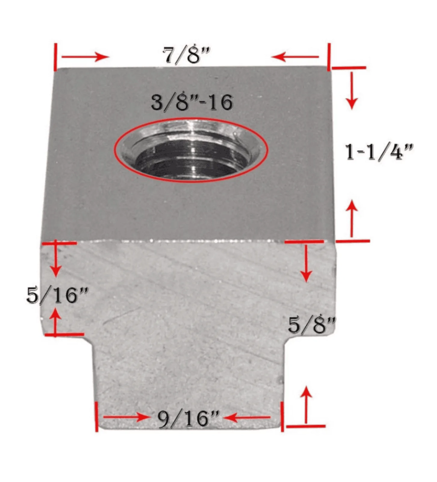

The t nut dims are all on the product page on Amazon.com.

you can buy SS T-nuts as posted in this thread
yes, but he's asking for the bolts to attach the rails to the bed. If you get the SS t-slot nuts, I'd match those with SS bolts for mounting your gear to the rails.

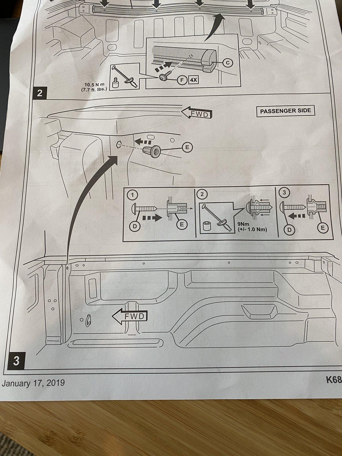

By the way...what does "FWD" stand for on these instructions?
I assumed "Forward" as in the front of the car...but I guess I am wrong on that.
I already put it in....just curious.
Huh, I never even noticed that "FWD" note (which I also assume would be forward) in the drawings since I watched a YouTube vid for installation, but it seems their arrows are pointing to the rear of the vehicle. I'd say the arrows are pointing the wrong way.
I figured something was off but then when I watched a rack install (1:07 on this video... ) I wondered if I missed something. I think in the video, he just through the rack up as a demo (but did not actually throw it in correctly?) lol.
I am pretty certain that BOTH rails go to the back of the bed - at least that is where I put BOTH my hex inserts.
