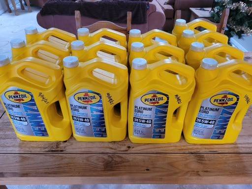

I then searched advanced auto and found them at 20 miles away. Went to the store and got the last 2 5 quart jugs. Manager informed me he won’t be getting any more again.
Advance Auto discontinued it. I bought 13 jugs of Platinum Euro for $14.25 ($2.85 per quart). If you can believe this, Advance Auto had 67 additional jugs in the warehouse for the same price. According to the gurus, shelf life is approximately 5 years for synthetic, so I was maxed out. I purchased enough oil to get me through the next 4+ years.
