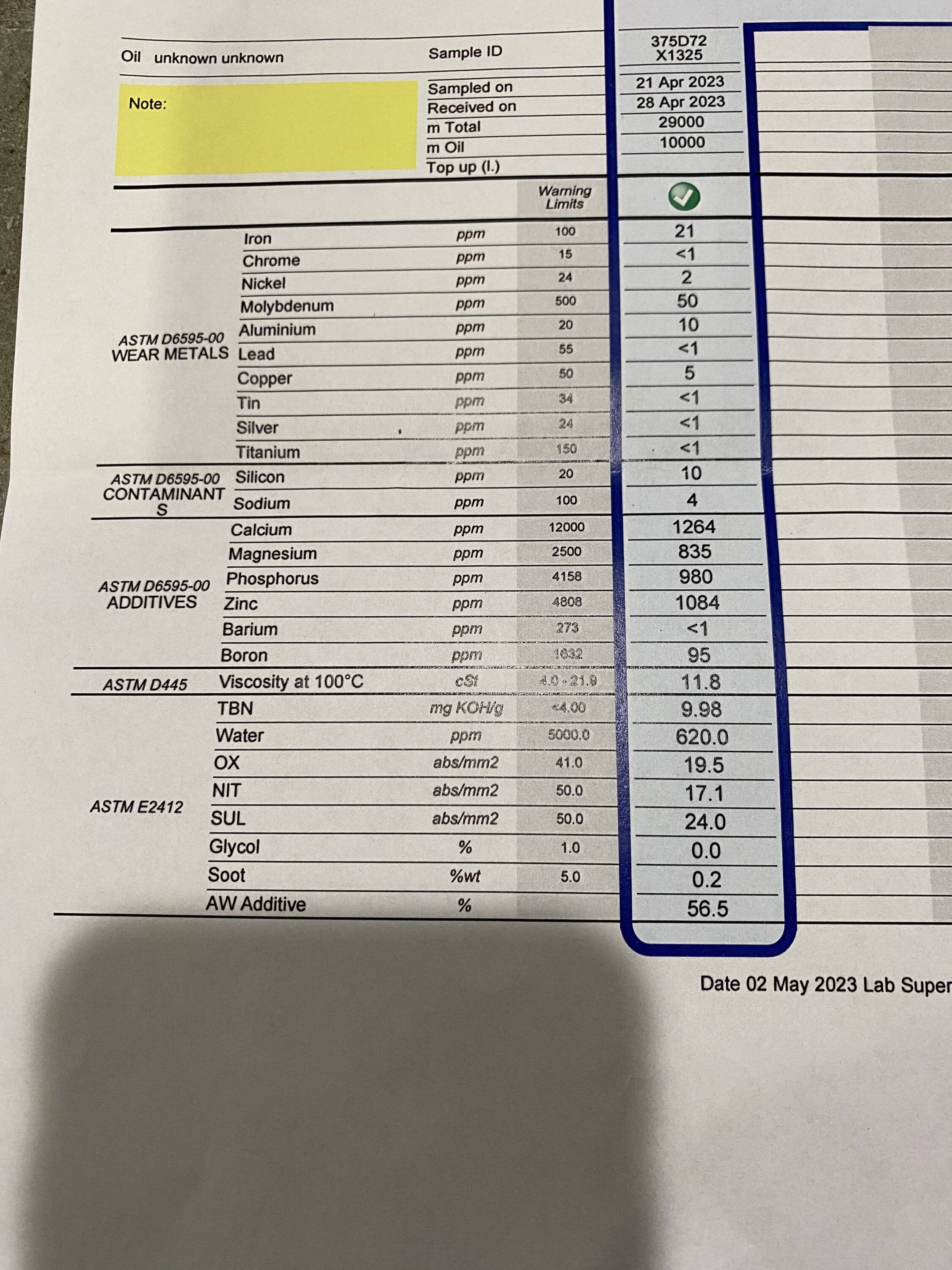

My first ever oil Analysis. ‘21 JTRD. 10,000 mile oil change with factory and ID bypass oil filters. This is the spec Penzoil.
That doesn't look all that bad overall for 10k miles. Viscosity is in the 5w30 area though.
Looks pretty good still. How old was the oil?

About 6 months. My rigs heavy to about #6800. Turning 40’s. About 10% towing 4K trailer.
This oil change with Motul. See how that does.
What lab did this one. Does not look like Blackstone.
Very curious on what the Motul numbers do. The viscosity does look like 5/30 to me. I’m liking the metal wear numbers??
That's why I'm still running Pennzoil Platinum, albeit 6,000-mile intervals. The UOAs are pretty good. The gen 3 engine does a good job of shearing oil. Quaker State shears faster than any oil we've seen.
For whatever reason, the aluminum wear numbers are lower on the Jeeps than the Ram. Nobody seems to know where the aluminum is coming from. GDE thinks it's a combination of low-tension piston rings and an offset wrist pin. We would need to see a high mileage teardown to see what the piston skirts look like.
We've tested Amsoil AFL and EFM. Amsoil AFL has performed the best (no shearing). There's also an HPL 10W-40 that is being tested, and so far it doesn't seem to show much shearing. I'm happy with Pennzoil at this given time, but Amsoil AFL is the best oil we've seen without dispute.
The Amsoil AFL is not recommended due to the lack of MS-12991 cert correct? I understand it meets and/ or exceeds the performance required of FCA.
