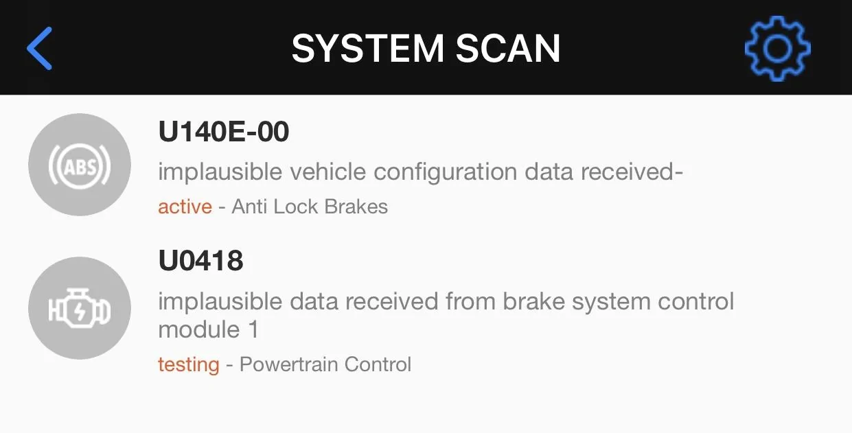

Has anyone else experienced any weirdness with their vehicle after adjusting a setting using Jscan?
I've used Jscan three times so far. The first time I used it I increased my tire diameter when putting on Summer tires. Everything was fine afterwards.
The second time I used it I decreased my tire diameter when putting on Winter tires. That time, I ended up with a cruise control error that went away after a day. That was followed by one of the TPMS sensors ending up losing its programming, and I ended up having to get the dealer to reprogram it. It wouldn't do it on its own even after driving about 50 miles.
I just used it a third time to enable passive entry. The passive entry is working fine, but I have a cruise control error again plus an ABS error this time. Too soon to say whether they are going to go away or whether the TPMS thing will recur.

I tried to clear these, but not having any luck. They weren’t there prior to connecting JScan and updating the passive entry entries. It will be interesting to see what Jeep says.
U140E-00 and U0418
U140E-00 and U0418
This is actually the result of changing the tire sizes (yes, I realize it might not have happened to others, but it happens). You’ll need to perform the abs initialization routine, otherwise these faults will keep popping up. Note- you have no anti lock brakes while this fault is active.
Interesting. I’ll give that a shot (once i find it). I did notice that the ABS wasn’t working. Thanks!
Is this something I can do from JScan? I’m not finding it.
I just looked- I guess not. You’ll need AlfaOBD to be able to do it. It’s a far more powerful tool than Jscan, and is not VIN locked so you can use it on other FCA vehicles. It works with the same bypass and interface that you have for Jscan.
