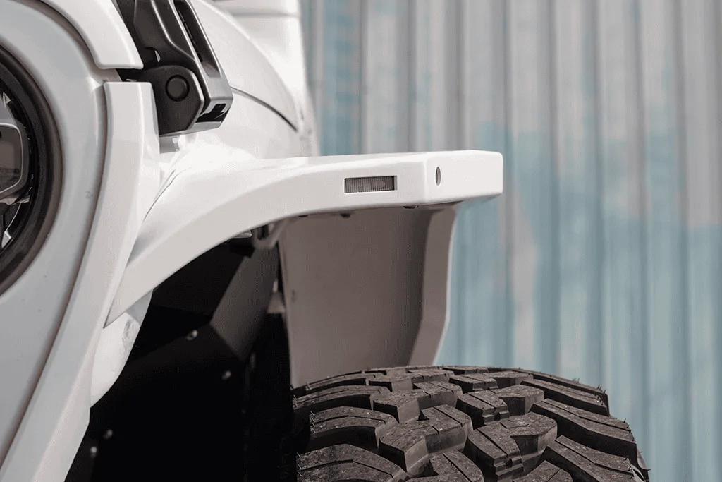

Looking at the JCR fender flares. Read the below and wondering if JScan can address it.
  • On Jeeps equipped with incandescent marker lights (IE. not the LED lighting group) a resistor will need to be added to the turn signal wiring to cure hyperflash and to remove dash warning lights, we recommend part number DD4025 from Diode Dynamics. Follow their instructions for wiring. (Luck has also been reported by those using the "LED Front Turn Signals" setting on the JL Superchips Tuner, no resistors needed.)
  • On Jeeps equipped with the LED lighting group, removing the DRL, marker, turn signal module from the front fender will cause a "bulb-out" warning on the dash. There is currently no work-around for this.
I am equipped with incandescent package but would be looking to also add Oracle LED lights at the same time.
I will need to flip the headlights to LED for the Oracle headlights. Will that impact the issues with incandescent DRL/turn etc they refer to? I.e. will it make the Jeep see the bulb out warning associated with the LED, or will I still need the diode because the wiring is incandescent?

You *should* be fine just changing the settings to Led without the resisters. Over on the JL forum some have had issues with some of the off brand sequential turn signals and getting the hyper flash and bulb warning after changing the settings to led.
Gregj
Ok. I would order up the diode to have just in case I suppose
So I went back and read their description of the flares and they remove the DRL completely. In this case you will need to turn off the DRL's in the settings, you can do this with Tazer, JScan and i assume with Flashcal, I don't have one of those so I cant say for sure.
Gregj
This happened to me, but after I left the turn signals on for more than a few seconds, it went away.
Gregj
they have a side marker and a drl on the front, dont know why they would eliminate drl altogether
The way I read it is the LED package has a different module that gets removed and there's no fix for that
"removing the DRL, marker, turn signal module from the front fender will cause a "bulb-out" warning on the dash"
