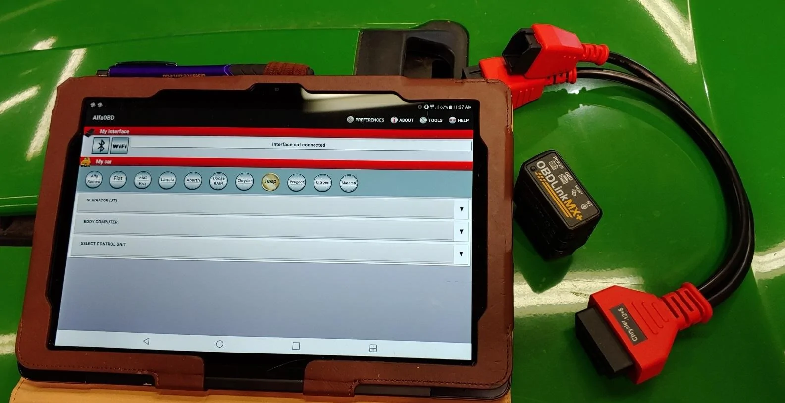

BUT - the less expensive adapters/readers, such as the $25 range, can't access certain areas because of lack of processing speed. I ended up ordering the more expensive MX+
https://www.amazon.com/gp/product/B07JFRFJG6
The cheaper one just didn't cut it for me (so I supposed I should sell it one of these days and not let it just sit)
Good thing I didn't tell my wife I tried to save a few bucks and then ended up buying a better one later - I'd never hear the end of it. "why didn't you just get the better one first, you know how it always turns out".
Here's my setup - and little I can't do (except a few things tazer does because it has to REMAIN in your truck to operate live)
