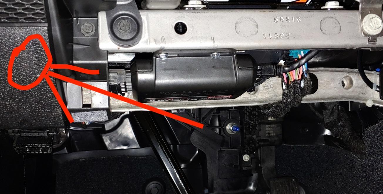

Its actually behind the panel to the left ... but pulling the panel under the steering wheel it might help in seeing those plugs and letting in more light. The OBD port is in the bottom left of the picture and the plugs you need are just a few inches above that ... right about where I drew the circle
ALSO... supposedly the Rubicon has a extra CPU right there where I drew the circle and that is why it is tighter and more difficult to pull the plugs then on other models.
LAST... I have Rubicons and a Sport S so those are the ones Ive personally done. I have no knowledge about these supposed.."OTHER MODELS" some of you speak of.
If you heard the "click", you almost got it ..... maybe you need to pull harder? Mine were also very tough to get out the first time. I grabbed the bundle of wires from the plug and kept pulling hoping I wouldn't yank any of the wires out of the plug.
Hope this helps!
Finally got around to getting new tires, ordered my cable and obd adapter and set out to recalibrate.
Only to find out I didn't really know where the plugs were. I googled and skimmed through threads but didn't see anything that was clear to me. After a few minutes I found them but if I had seen this picture it would've helped immensely!
I tore up my fingernails trying to pry the plugs out. I was too scared to pull on the wires, not wanting to have to fix anything if it came apart.
I grabbed a flat head screwdriver and was able to get it between the edge of the plug and where it seats. Twisting the screwdriver gently was enough to push it out where I could grab and pull the rest.
And like others, I was surprised to find the tire size already programed at 32.25... I had measured my new tires at 32.75. I went from stock 245/75 to 285/75. Are they preprogrammed with Rubicon tires in mind (285/70)? A lot of time, money, & effort for 1/2 inch.

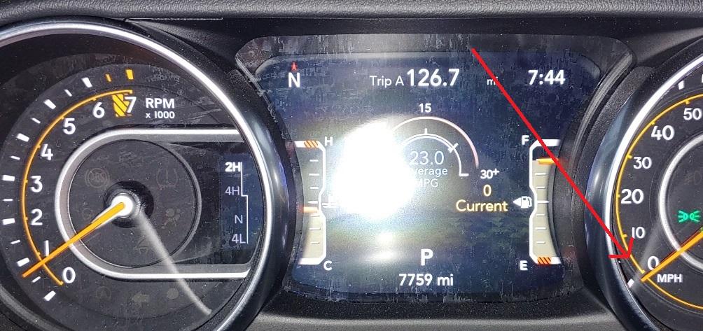

From what I have seen and read, the speedo is off on a lot of JT's from the factory. Maybe they did it to show better gas mileage. IDK. I do know mine was off and showing I was driving a lot more miles than I actually was.
KevinC
Not sure where that comes from or the supposed models impacted but when I did a test of mine using both my phone GPS and the Garmin I have - I went by odometer and set everything to 0.
Then I drove 17 miles. When I got home the odometer/trip/GPS miles matched to the tenth.
I also use FuelUp on my phone and last fill my truck said 20.7 mpg and fill up said 20.71 mpg - since the truck only goes to the tenth I consider that dead-even.
They are generally about .3 mpg within each other. That's pretty darned good.
The only discrepancy I have found is that the digital speed display is right, the analog usually shows about 1 to 2 mph faster when going 60. I have not figured the percentage that one is off but when I set my ACC the radar signs agree with what the cluster says.

There’s an analog speedometer?
lol
My digital speedometer is right on with the GPS.
DUH - along with an analog tach LOL ->
Jeep Gladiator Please teach me about jscan speedo
And yes, my digital is right on the money with independent GPS.
