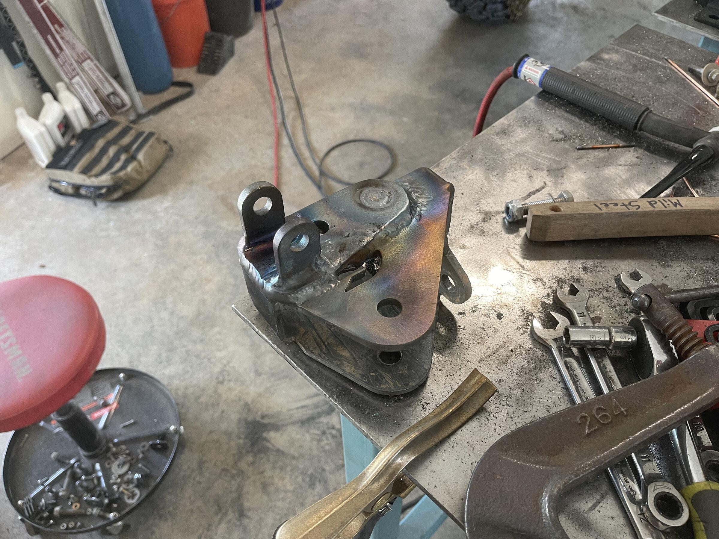

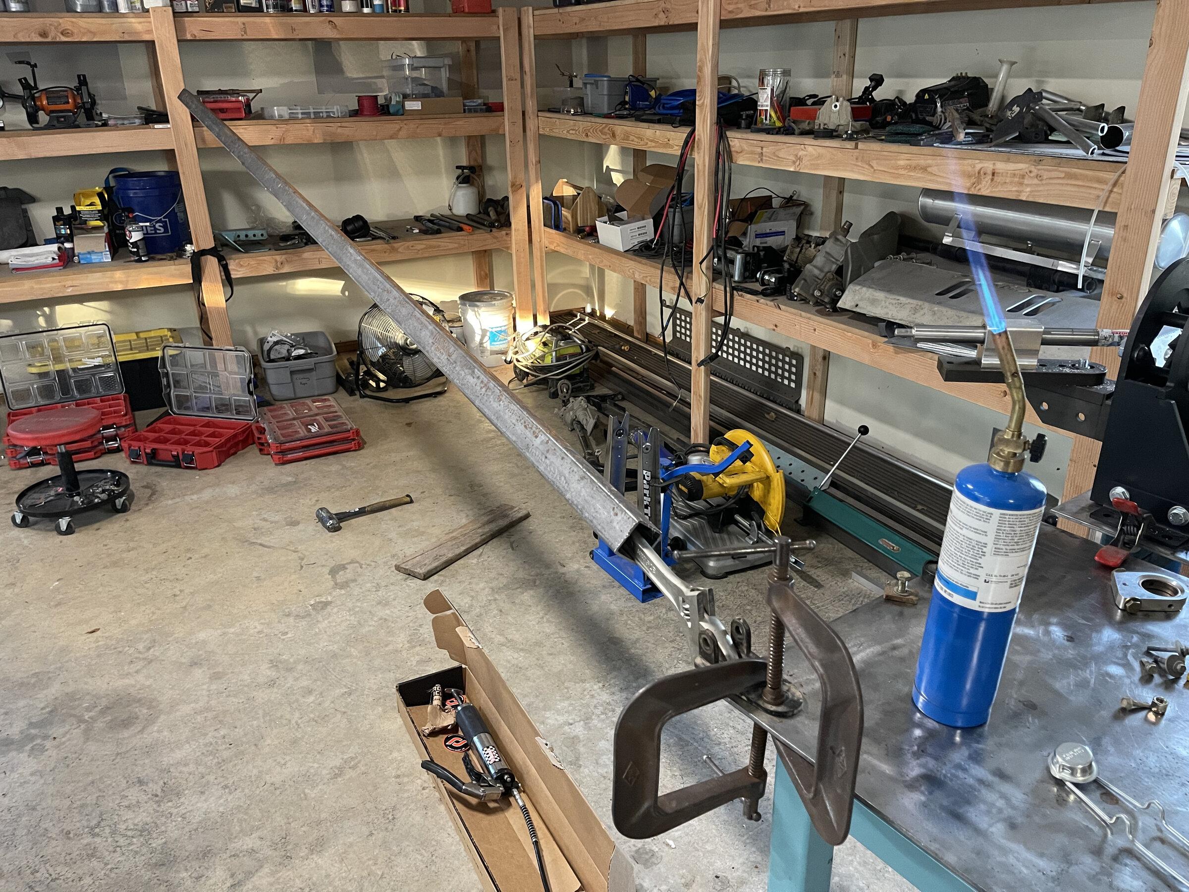

Another weekend of offroading and some lessons learned.
After trying a couple lines with fairly big rocks I noticed the bracket connecting the ram to the axle was starting to bend. This was a custom job, so I was kinda expecting something to go wrong... but I wasn't expecting this to be the weak point. I took it easy for the rest of the day and it didn't bend much further, so that was great.
The bracket required a lot of heat and an 8 ft breaker bar to reshape, so ya.... that ram has power.
Welded everything together Sunday to hopefully prevent future bending. Going to weld the bracket to the axle also, just waiting for a welding blanket to arrive. I really don't want to be welding under the axle without a little more slag protection :P
The pieces I combined are a synergy track bar riser and a steer smarts stabilizer relocation bracket.

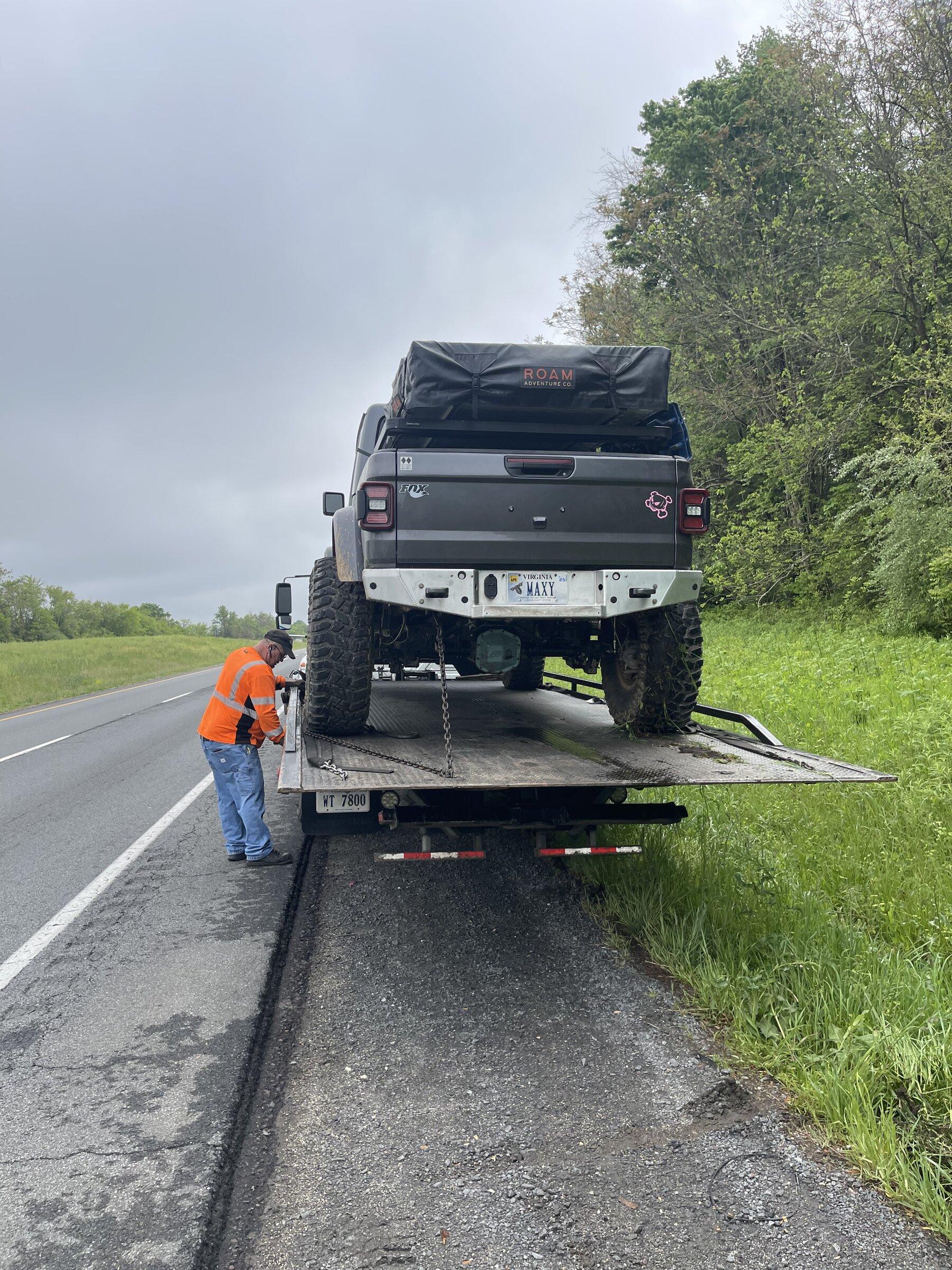

Had a bad day. Was driving the truck on errands this morning (prior to a planned wheeling trip tomorrow) and the dreaded CEL showed up. Pulled over and checked under the hood. Oil was visible on top of the engine and opening the oil fill port showed smoke inside. Shortly after stopping, oil was pudding under the truck :(
Got it towed to a dealer to see what they say, but I’m assuming I’ll be towing it home to do the real work soon. Fingers are crossed that Jeep honors their warranty, but I’m not holding my breath :/ (though I’d love to be able to report back otherwise if the Jeep gods smile on me)
Based on my cursory inspection, I’m guessing a camshaft seal blew. There are a few possible culprits though.
Hopefully it was caught soon enough to prevent catastrophic damage, but ya… rough day.
Will report back with findings and fixes.
I need that kind of shop! Or at least that much room in my garage!
