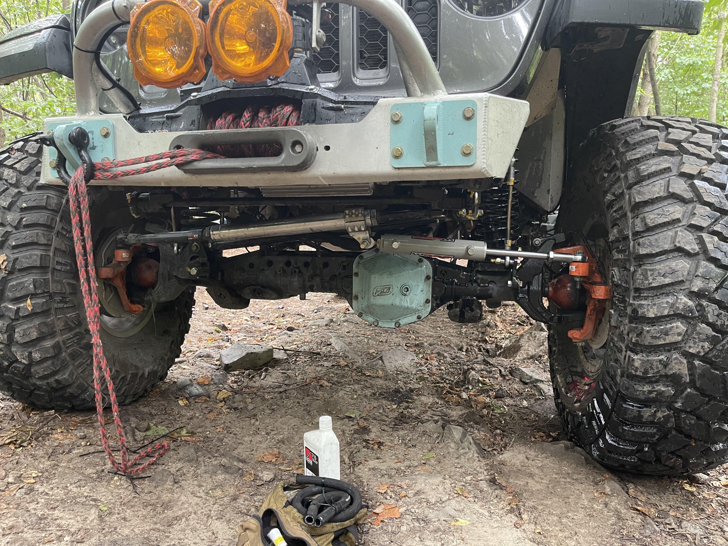

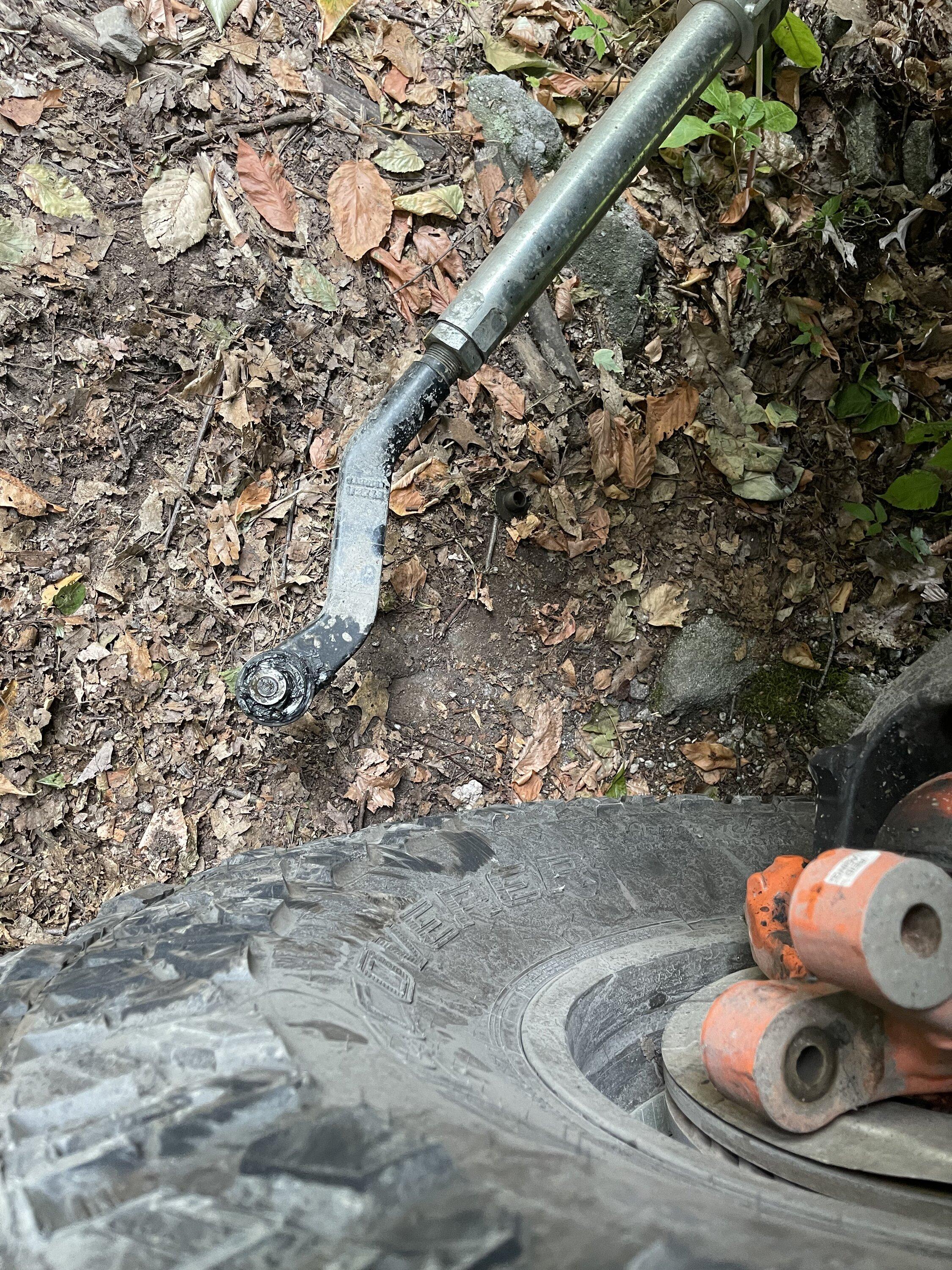

Messed up my tie rod a couple weeks ago :/ Recovering from that, I made the upgrade I had been putting off and it got me back out this weekend. Lesson learned, the steer smarts stuff isn’t quite cut out for 40s and hydro.
I went with Fusion since TMR was out of stock, it’s pretty much the same parts I think. I dig the replaceable cartridges and wish I had known they existed first time around.
Fun pictures of the break and creative configuration to get off the trail.
Jeep Gladiator Practical Truck for the Over Prepared Woman 29CC2786-574E-47B8-A415-22557E7A454A
Jeep Gladiator Practical Truck for the Over Prepared Woman 52408F71-C81F-45AC-8B74-B647374215CC
11,493
30,641
Interesting fix. ?

Can’t say I’ve ever seen that done before! How did it handle?
Kindafearless
Kindafearless
Elise
Aug 19, 2019
463
1,244
2020 Jeep Gladiator Rublicon
Enginerd
It got the truck back to the trailer. I kept it slow, but was able to steer and handle a green trail for a couple miles.
The wheels weren’t aligned great, so the biggest pain was getting the truck correctly centered on the trailer in the parking lot.
I wish I could claim this was my idea, but it came from one of the guys on the trail with me. It’s freaking brilliant.
I hope to never do it again though. I have extra TRE cartridges arriving tomorrow and the new drag link and tie rod are installed.

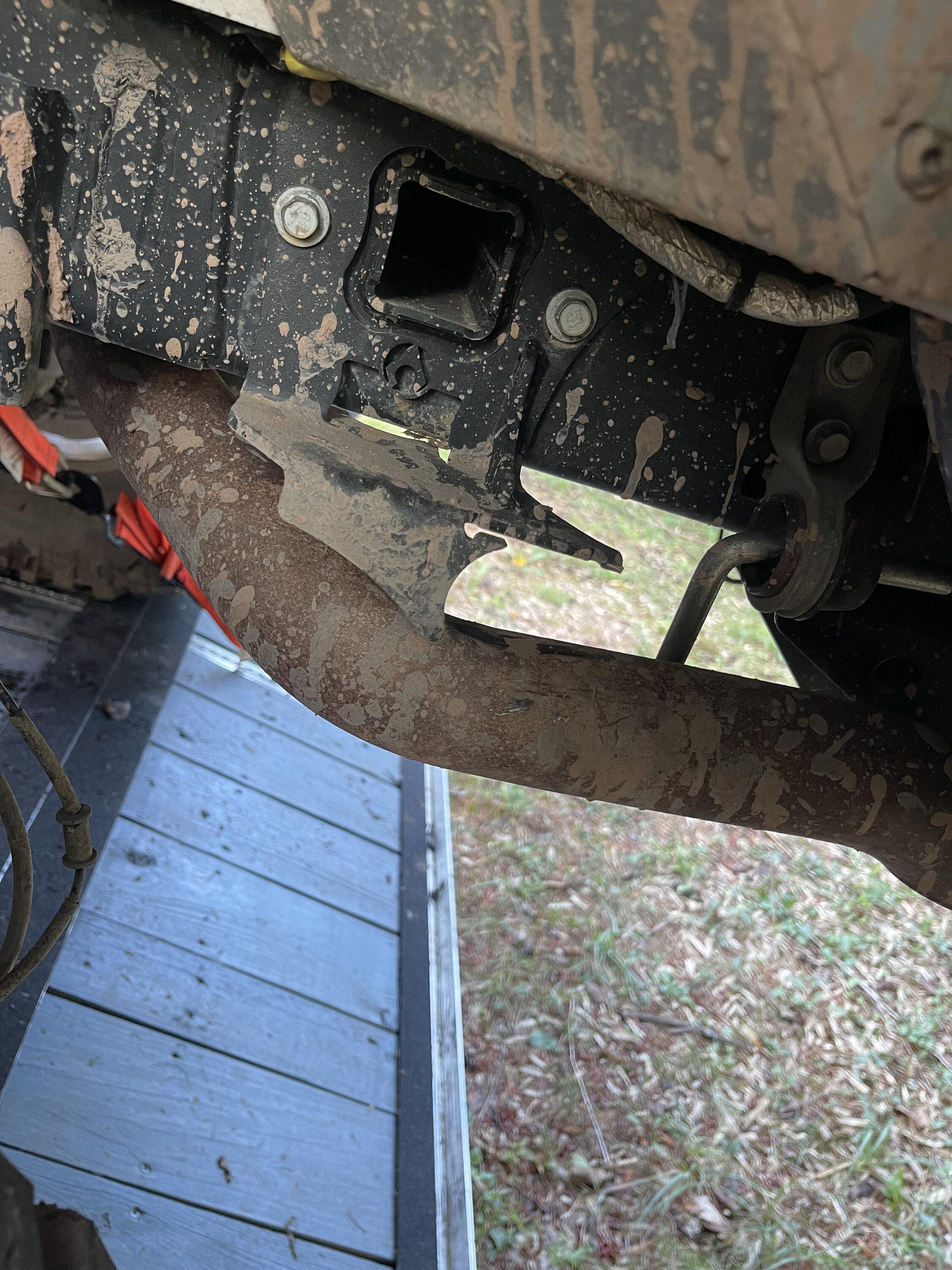

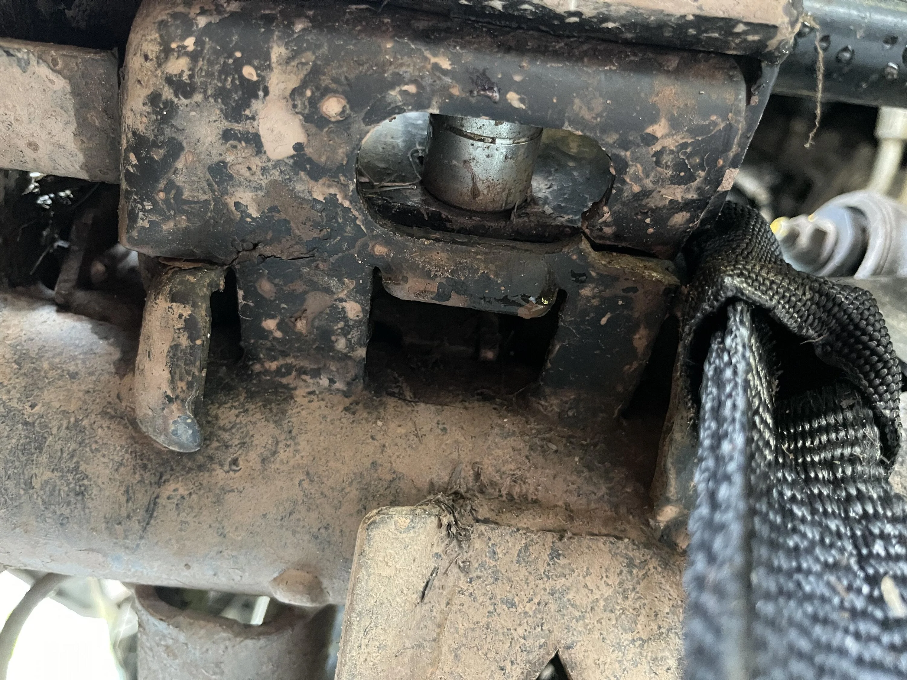

Been a few days of wheeling since I last broke something, so it was bound to happen again :/
This time it was a crack in the front track bar mount AND a failure in the rear sway bar mount (from Artec).
Jeep Gladiator Practical Truck for the Over Prepared Woman IMG_2183
Jeep Gladiator Practical Truck for the Over Prepared Woman IMG_2181
In hind sight, the setup of the Artec bracket isn't super strong out of the box. The welds are minimal and there are a couple weak spots that could have been fixed by running a bead along the full length of the bend and connection points between parts. I'll be reinforcing both brackets when I weld the broken one back together this week.
For my trip next week, I'm also going to do a quick fix on the track bar bracket. At this point, I'm going to replace it in the next couple weeks though. I just don't think the factory bracket is designed to take the kinds of pressure I'm putting on it with the track bar riser AND hydro assist.
