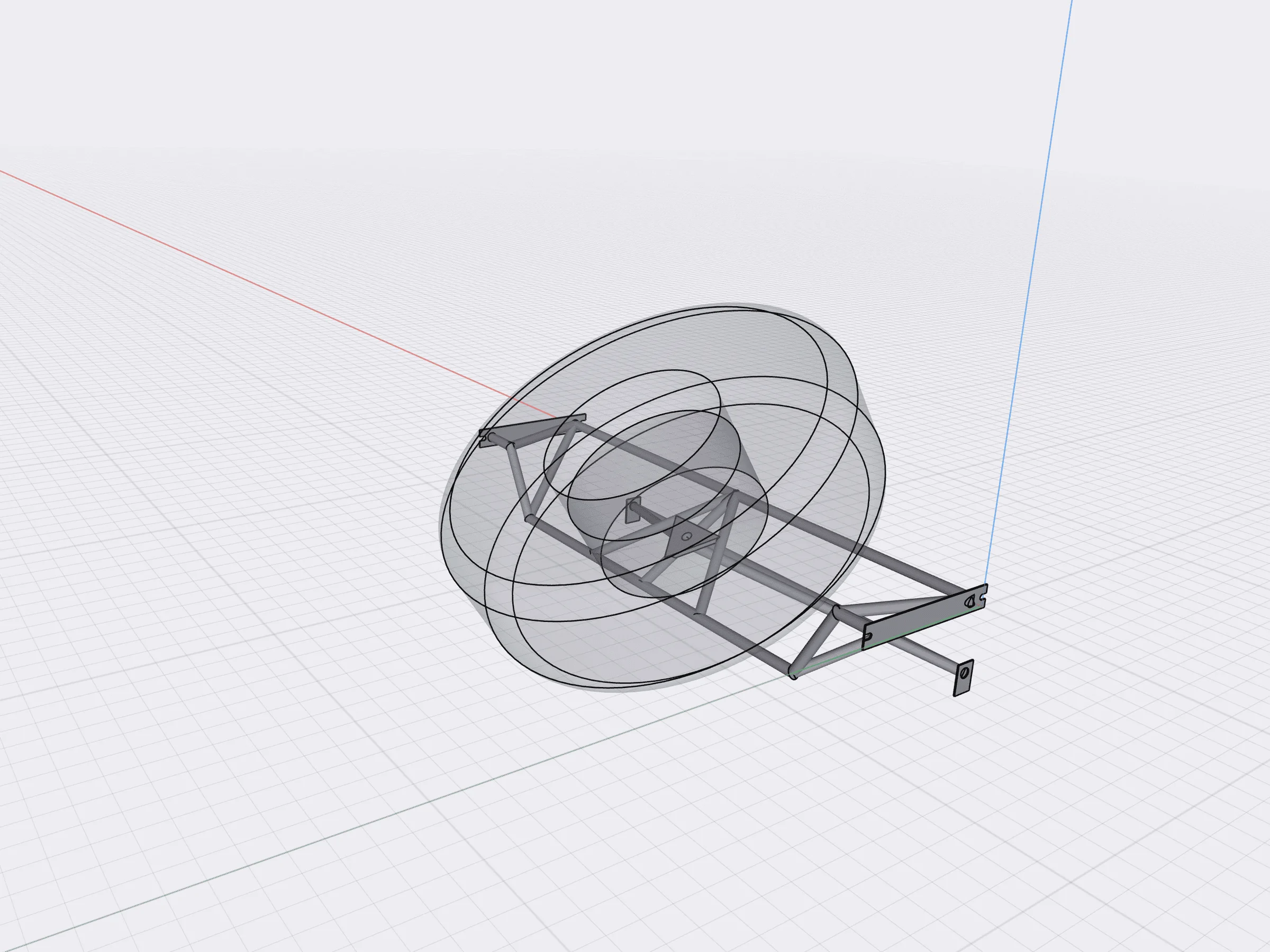

Still working on the design for the tire rack.

Where the three come together right under the wheel are tight cuts for welding. Are you able to drop a more vertical also from that point to the lower bar? Would prevent possible flex of that upper
You make a good point. You would want enough gap that each piece can be welded individually, instead of doing them all at once.
