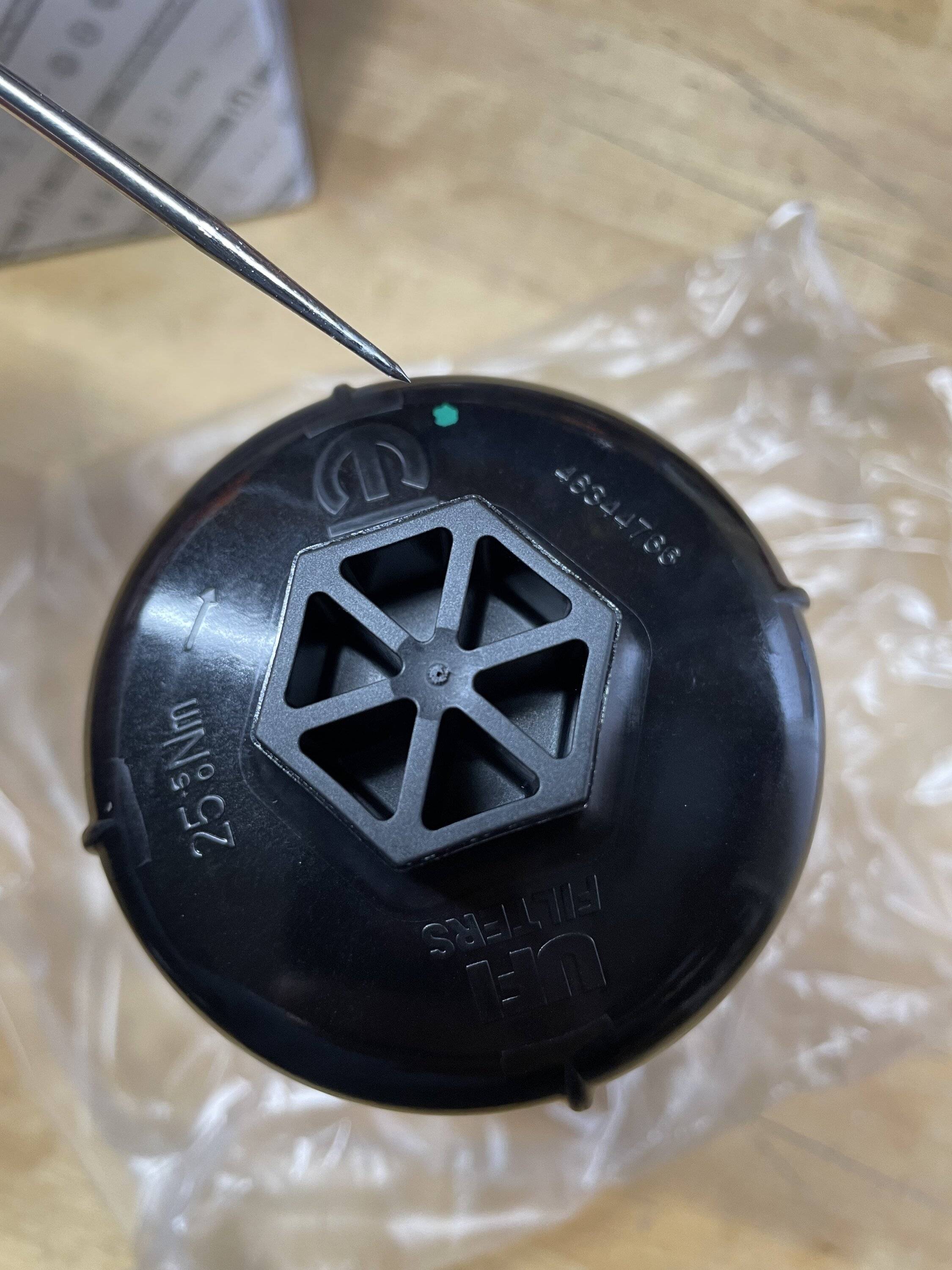

Diesel oil change torque specs, anyone have them handy? Thx!

Think it's 27 in lbs. Or 27 nm. Not sure. Remember 27 being stamped on top of the cap.

Honestly just tighten the oil filter cap till it feels snug, I have heard stories about the caps being broken when ppl try to apply a torque setting to them.
They just need to be snug, there is a o-ring that is keeping the oil in.

So 18ftibs #freedomunits

25nm is too much for the filter housing. I tightened mine to spec with a digital GearWrench torque wrench (only used a couple times and still calibrated) and it started throwing low oil pressure codes. I backed it off and put it on 1/4 past hand-tight.

I haven't have any issues with 18ft lbs on the oem filter. I used a Proto dial torque wrench rated for 0-50lb. 1/8 turn once seated for the drain bolt.
