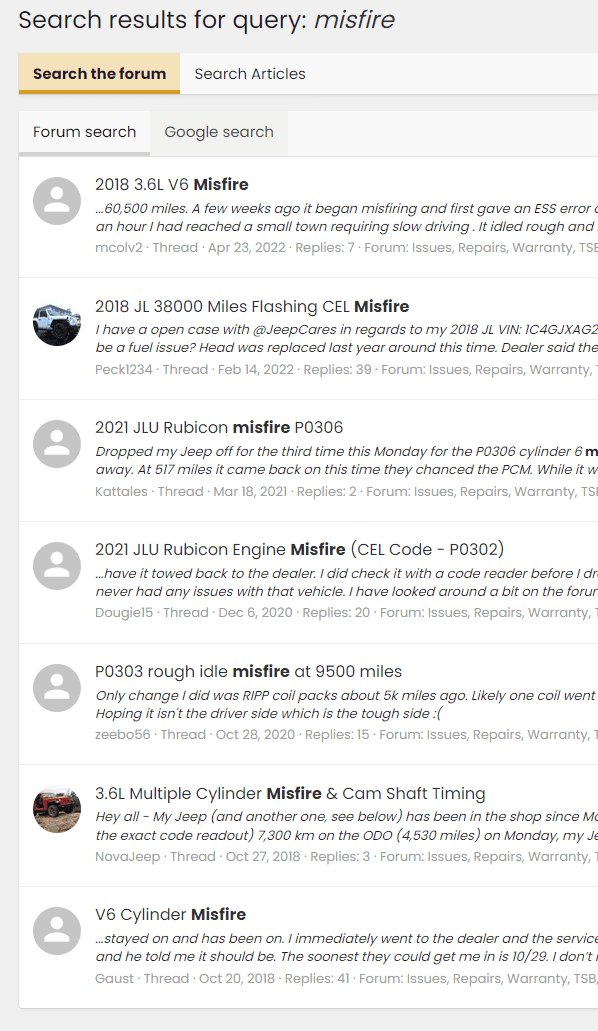

Thanks for your help, but a response like this post would have been even better. It's not conclusive, but it illustrates why I made the statement that "For some reason the JL did not have these misfire issues like the JT does".
Here is the result of a search for the word "misfire" in the title of threads in the jlwranglerforums
"Issues, Repairs, Warranty, TSB, Recalls " forum. 7 threads - 127 replies
Jeep Gladiator Survey- For those with misfire issues 1664331748167

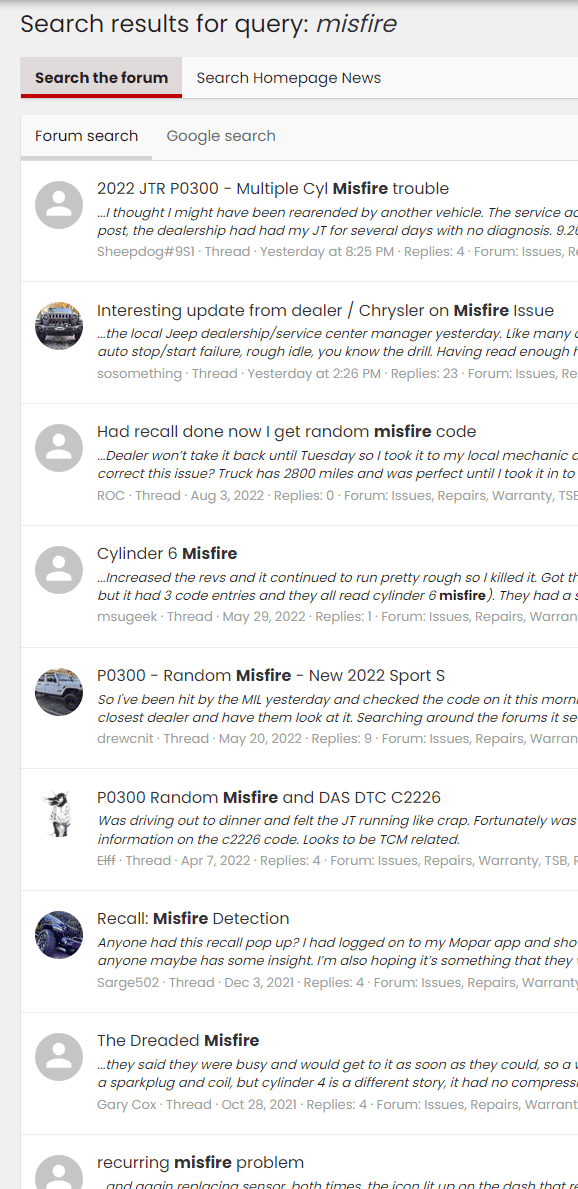

Here is the result of a search for the word "misfire" in the title of threads in the jeepgladiatorforum "Issues, Repairs, Warranty, TSB, Recalls " forum. 17 threads - 1925 replies
Jeep Gladiator Survey- For those with misfire issues 1664332153222
