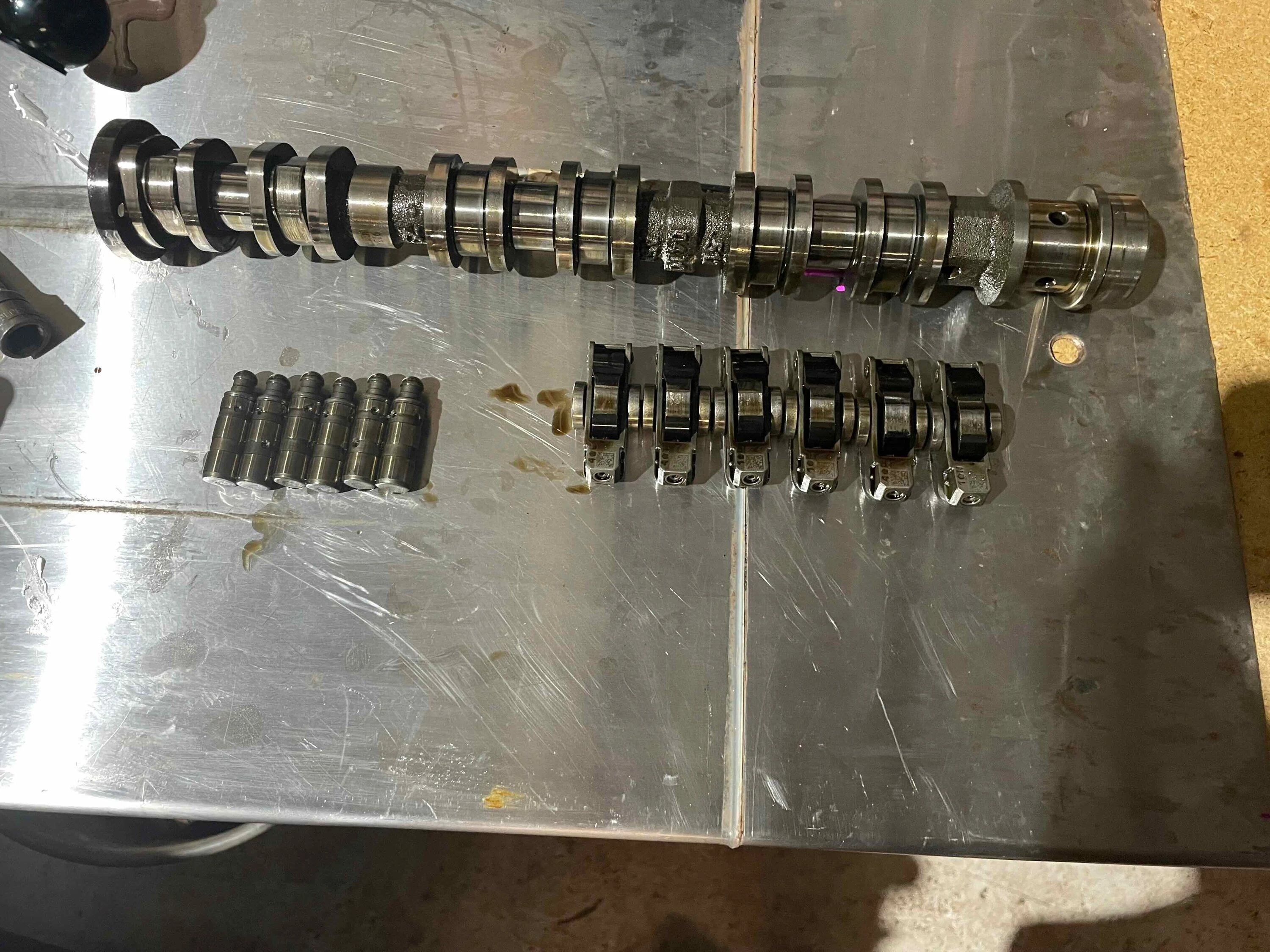

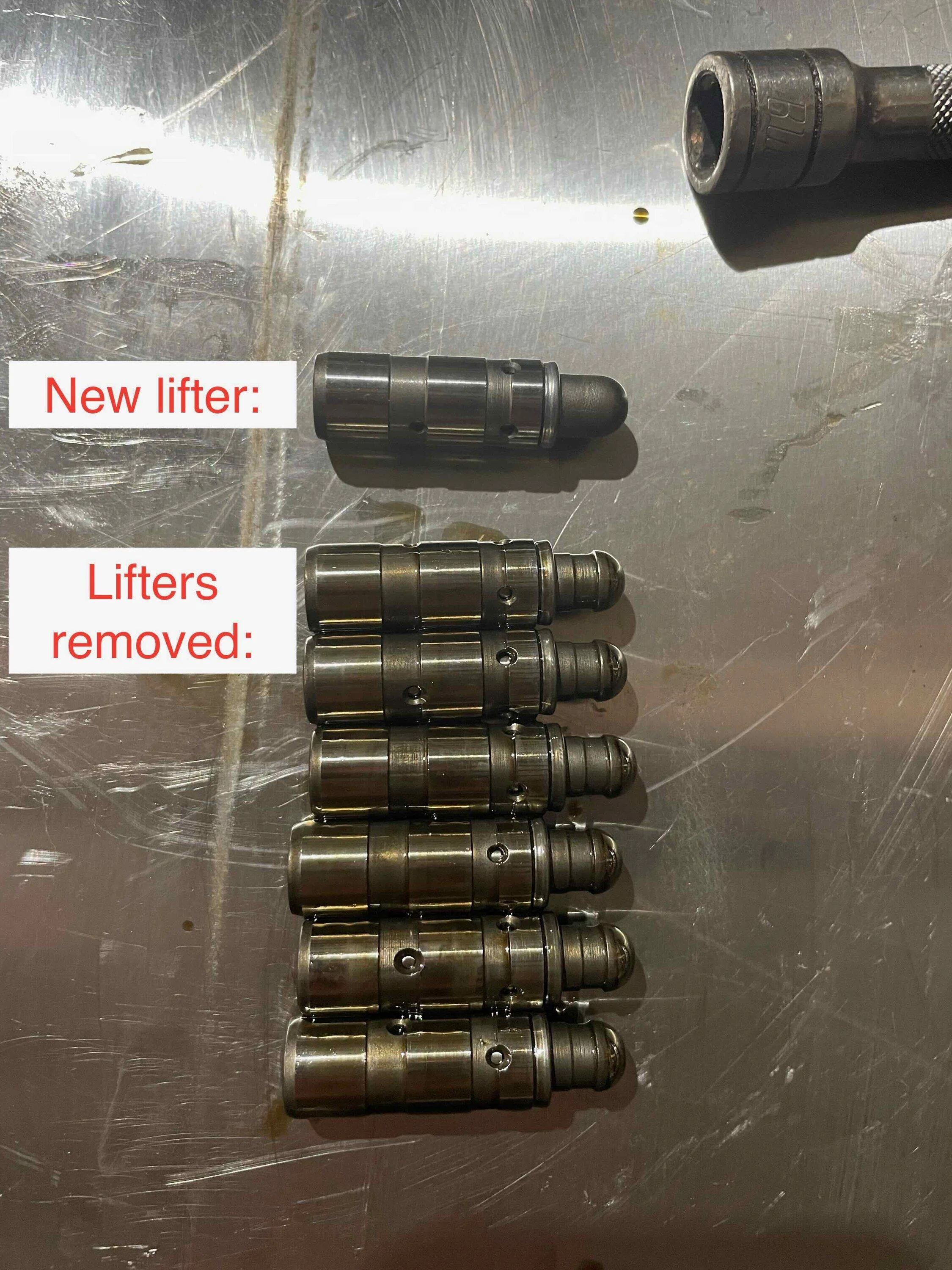

Hey guys - quick update… parts finally arrived to North-West Western Australia and rebuilt the Bank 1 valve train. All 6 high-lift lobes totally chewed out. Found the exhaust lifters in there, as others have… see pics. For the record - mine is a 2020 model Launch, done ~38,000 miles (about half of which was towing our Patriot camper), with a Magnuson.
Didn’t inspect Bank 2 - we’re currently touring around Australia in our Gladiator and had to hit the road. Time will tell I guess. It’s such a shame as otherwise, has been an awesome overlanding truck…
My parts list is below - in case helpful to others. Thanks again for the advice from Dave and others!

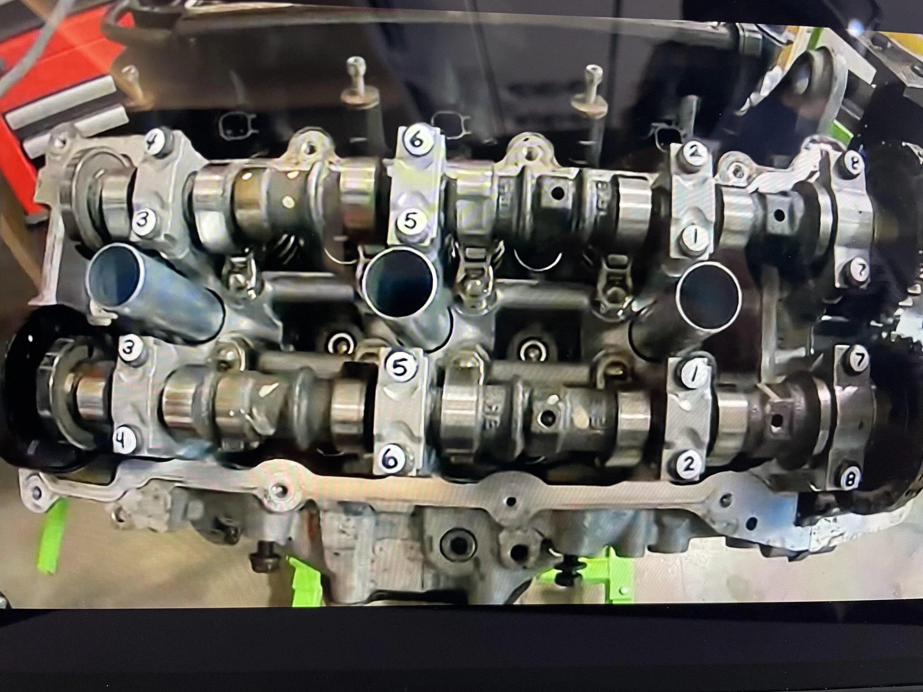

Cam caps torque order:
Jeep Gladiator The good and the bad of a roots supercharger. Cam cap torque order
Nice write up, should combine this with the cam tool stuff. I get asked these questions once a week. Maybe a good write up would help that

Wow the cams and rocker look very different from what i've seen from people doing this job on Youtube - i guess the VVL stuff has to be - that lifter is a new revised mopar part ?

If you all are wondering why I limited my engine to 2800 rpm.
Also you can see the difference between the older rockers and the new ones
My guess is the high lift shim on my number one rocker has come loose or the lock pin spring is broke.

Yeah i noticed that they look wildly different, looks like its cast instead of stamped, I assume the middle lobe rests until its actuated by higher oil pressure in the higher rev range ? (or vice versa).

I bought the cam tools. It made the job really easy. With the timing gear lock in place you can unbolt the cam phaser and then just wiggle the cam out with the timing and everything still in place. I was able to leave the blower on, and just remove the battery and fuse block tray. Had plenty of room.
I purchased:
1. Intake cam
2. 6 x intake rockers
3. 6 x intake lifters
4. Valve cover gasket
6. Amazon Pentastar cam tools for 2010-2021
7. Camshaft assembly lube
8. Gray RTV for aluminum sealing surfaces, for the timing cover split at the valve cover and for taking off the small oil pan and cleaning it out.
9. VVL front solenoid
10. VVL rear solenoid
The oil pan was mostly clean the oil filter was trashed, I had changed it thre times in the last 2000 miles when I knew what was going on. It has been clean, since the work.
