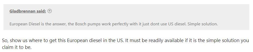

European Diesel is the answer, the Bosch pumps work perfectly with it just dont use US diesel. Simple solution.
So, show us where to get this European diesel in the US. It must be readily available if it is the simple solution you claim it to be.

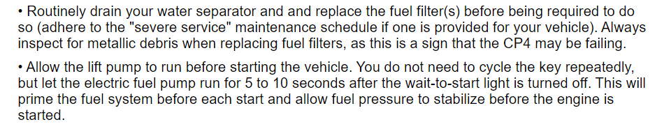

Do these not have a lift pump?

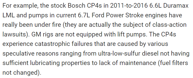

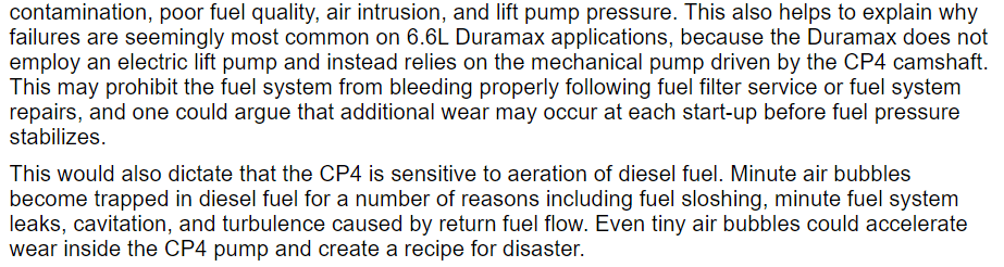

I see a number of sites suggesting aeration of the fuel and/or water being involved -
Jeep Gladiator What diesel additive is best to protect the CP4 pump 1683471690241
Jeep Gladiator What diesel additive is best to protect the CP4 pump 1683471559863
Now where people are getting hung up is on the copy 'n paste bit about "being designed for European diesel which is dirtier....... blah blah" and you see the same snippets in forum after forum, expert auto/truck blogs all over the place (yeah, those rags/blogs) and someone posted it and it's been copied by every magazine and blog and being put on forums left and right and has thus become "fact" - but it's not correct.

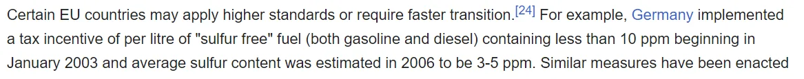

In 2009, the Euro V fuel standard came into effect which reduced maximum sulfur to 10 ppm.
So wait a minute - how can it be sulfur when the USA has HIGHER sulfur content than the EU?
Explain that one, automotive "journalists". Hmmmm.......
USA - ULSD is 15 ppm
EU is 10 ppm.
And yet- it's the lack of sulfur compared to the EU?
Like my former boss said - "misinformation stupid highway".
Hey, motortrend, motorbisquit, and others - DO SOME RESEARCH, eh?
Took me a whopping 5 minutes to disprove that European diesel is "dirtier" and has more sulfur which lubricates.
Jeep Gladiator What diesel additive is best to protect the CP4 pump 1683472597299
BUNK.
USA fuel is DIRTIER as far as sulfur.
Jeep Gladiator What diesel additive is best to protect the CP4 pump 1683472693530
3 to 5 ppm in certain EU countries, while 10 is allowed in the states?
And yet EU fuel is better?

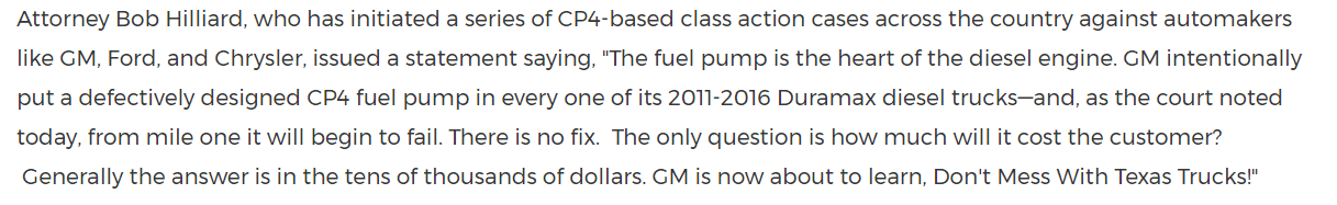

Other sources are attorney/class action sites. Another great source of facts (look at the class action suite on the 3.6 valve train - they lump ALL years together including the Gen 1 engine, but stop short of the 2020 Gladiator?)
So I'd love to know, after all of these years, all of the vehicles out there, and many outside of warranty, how does one get those figures?

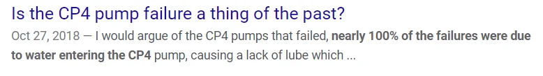

How about looking at other possible reasons - instead of 'it's lubrication!"
Jeep Gladiator What diesel additive is best to protect the CP4 pump 1683482515873

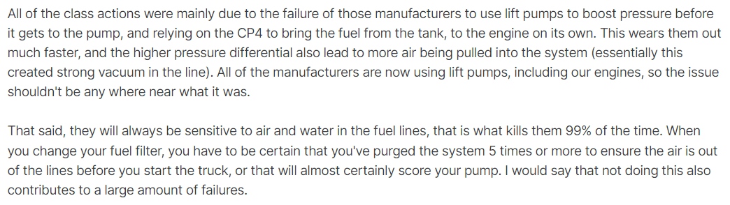

I go back to my post from earlier today where everyone is leaving out other possible reasons and concentrating on just one reason.
It's like cops finding their favorite suspect and concentrating only on that one while the real one escapes into China. Humans - they can only support one idea at a time, excluding even considering any others.
Maybe it's lube, but it's not sulfur and no one knows for sure the different rates of failure in various places.

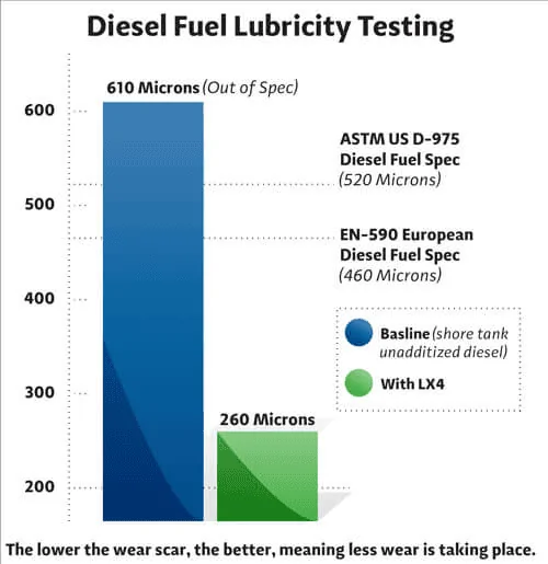

Found this chart for what it's worth.

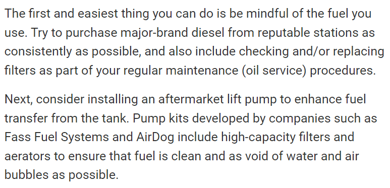

In an attempt to improve fuel efficiency, the CP4 injection pump replaced the CP3 pump to create a higher-pressure expulsion with less fuel volume consumed. With the lack of ability to supply the adequate fuel needed, thereby also reducing the amount of lubrication to the system, the CP4 forms air bubbles inside the injectors. When air is within the system, there is no fuel. Where there is no fuel there is no lubrication. Where there is no lubrication, there is instead metal friction against metal, causing accelerated wear and components to fail.
Bingo - many tech sites, not forums, not SELLERS and marketers of lube product who will push charts to get your money, they've found most of the issues are happening in systems where this little light pump is being forced to pull and supply the fuel, leading to potential (didn't say absolute) aeration of the fuel. It's doing all of the heavy lifting. That combined with other factors (ok, the lack of fuel lubrication??) air, water.
Some have shown that replacing filters and water separating devices being checked or drained has led to longer life for these pumps - those who do maintenance a lot more frequently tending to have fewer issues with these pumps.
Likely it's a stack-up of conditions -
Light pump doing more work, water, air, lack of fuel lubricity, the pump doing the whole job lifting and pushing, all combining.
There are a whole lot of people doing 100,000 miles on these pumps so it's possible that there's no one thing causing it - and what they are doing differently - top quality fuel, frequent filter changes and so on, are helping even with lack of lube.
