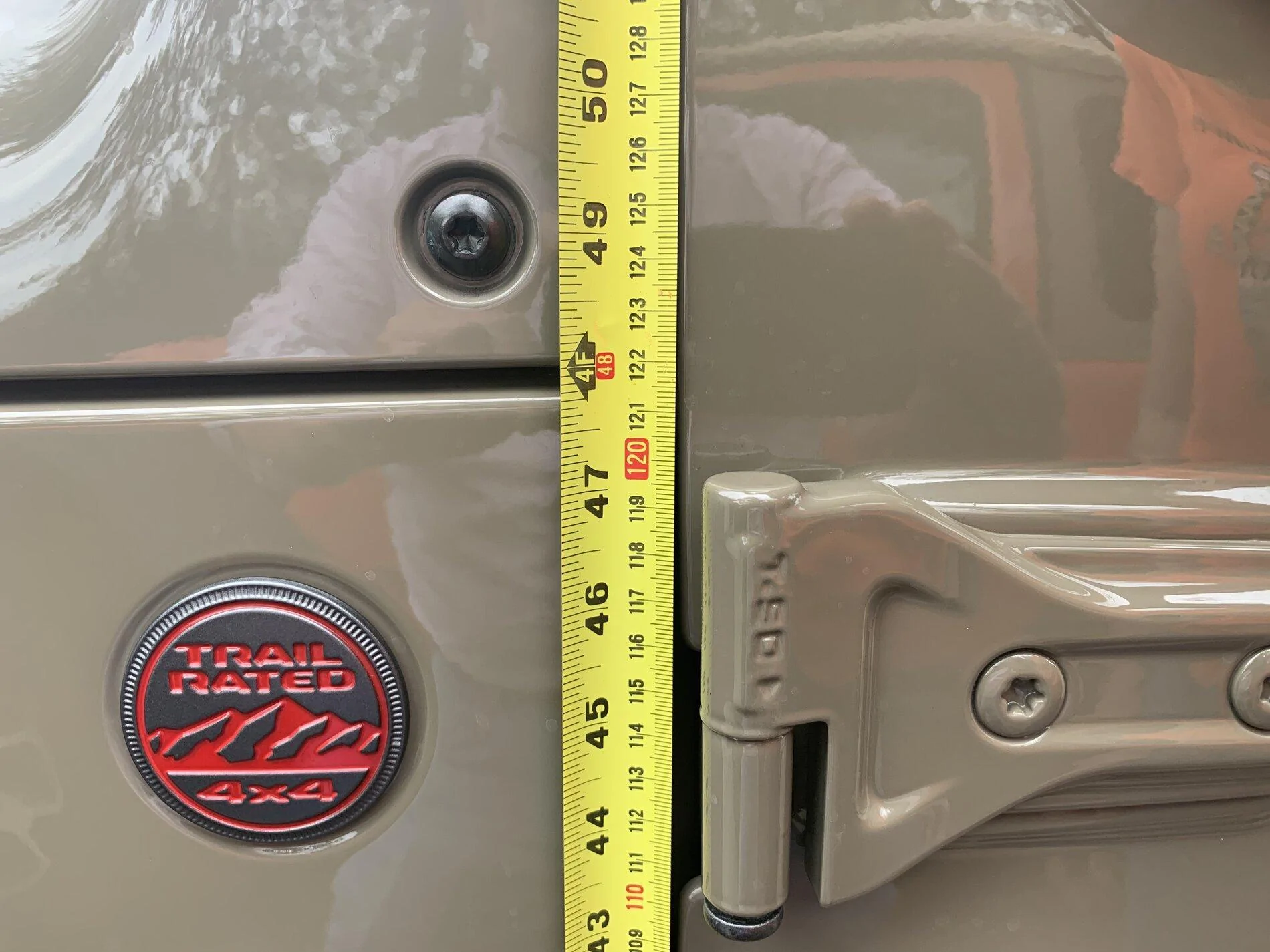

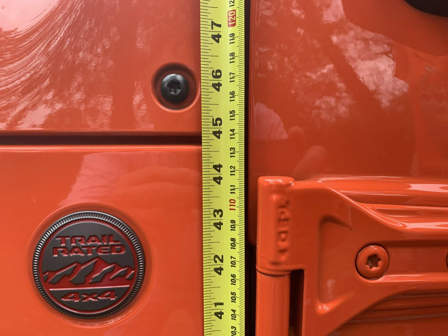

Do you gain a full 2” lift form the rubicon stock suspension?
You can see from the photos below I am approximately 3-1/4 inches taller than a stock Gladiator Rubicon measuring from fender seam to the ground.
I have 35’s vs the stock 33 tires so that’s about 1-inch there. Meaning that this kit gave me 2 plus inches of lift.
Jeep Gladiator AEV 2" Spacer Lift C81571F9-CE5C-4168-A854-6B43265C1105
Awesome, Thank you for taking the time to do that for me.

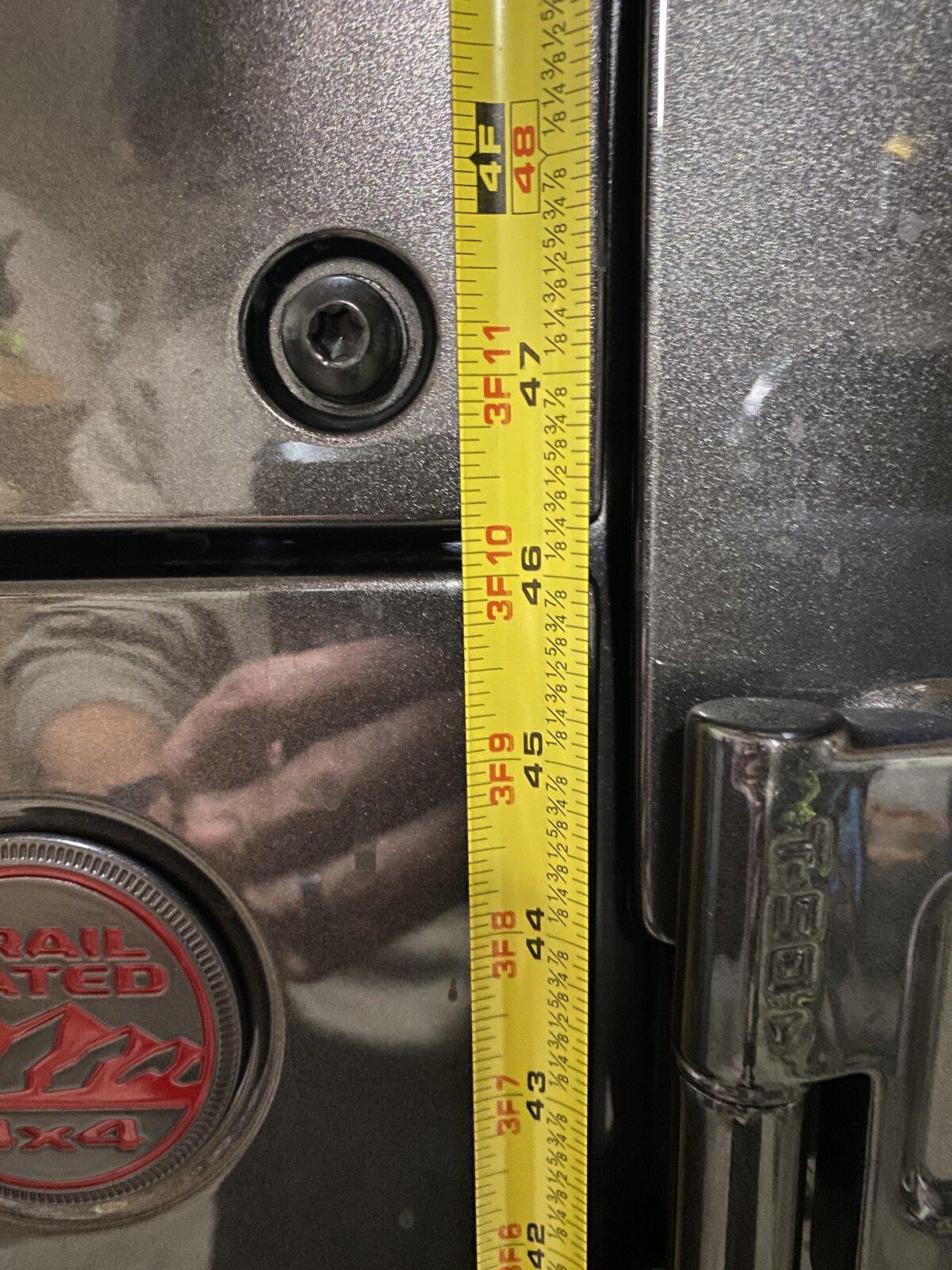

Thanks for posting that, I just measured my sport in the same spot, also 48” with 340 and 343 springs and 1.5” Daystar spacer and 35” tires. Good place to measure to.
I’m running 35s, stock rubicon suspension and the 1.5” daystar. I’m just over 46”. My eventual plan is a metal cloak 3.5” lift and 37s.

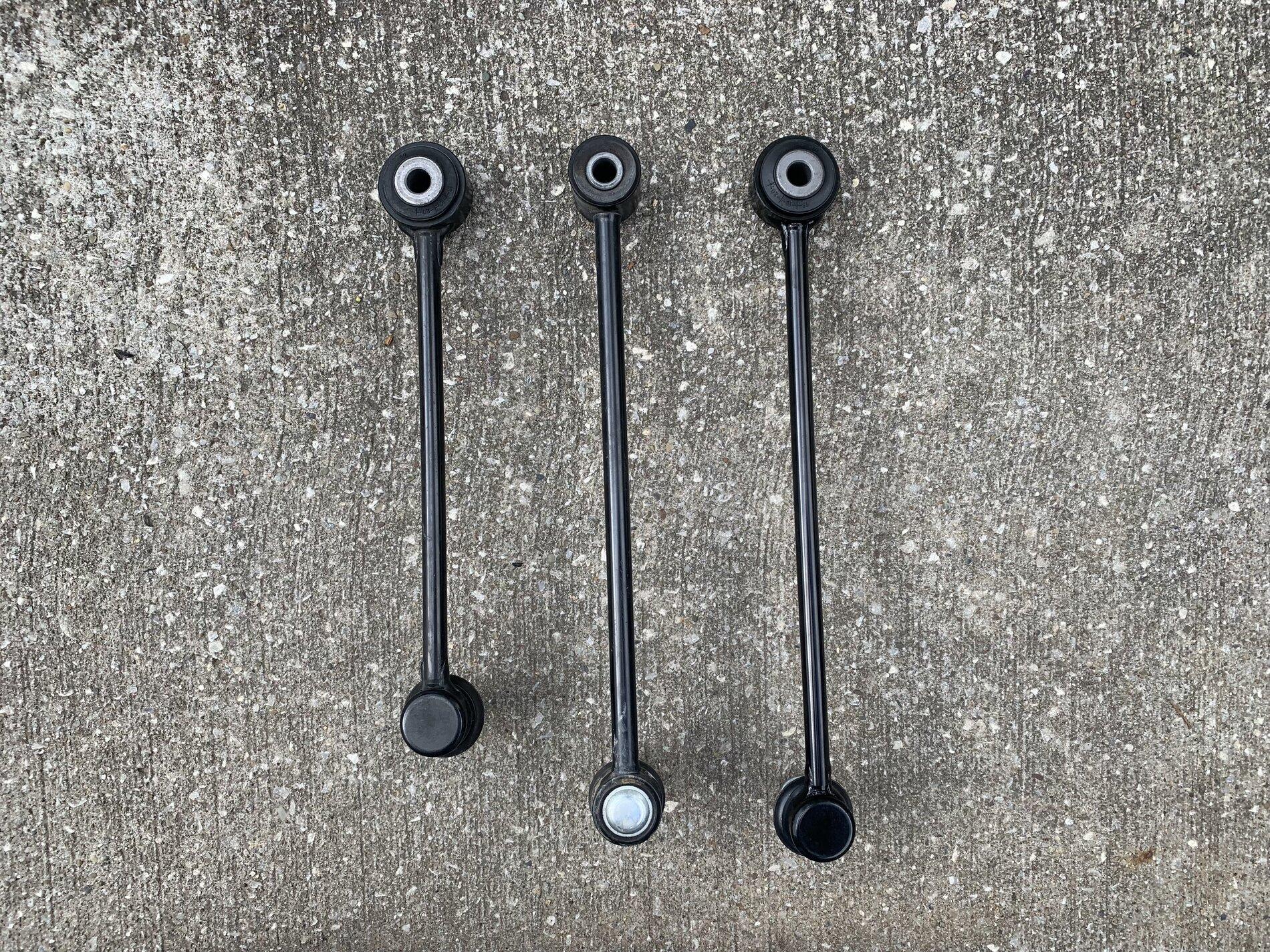

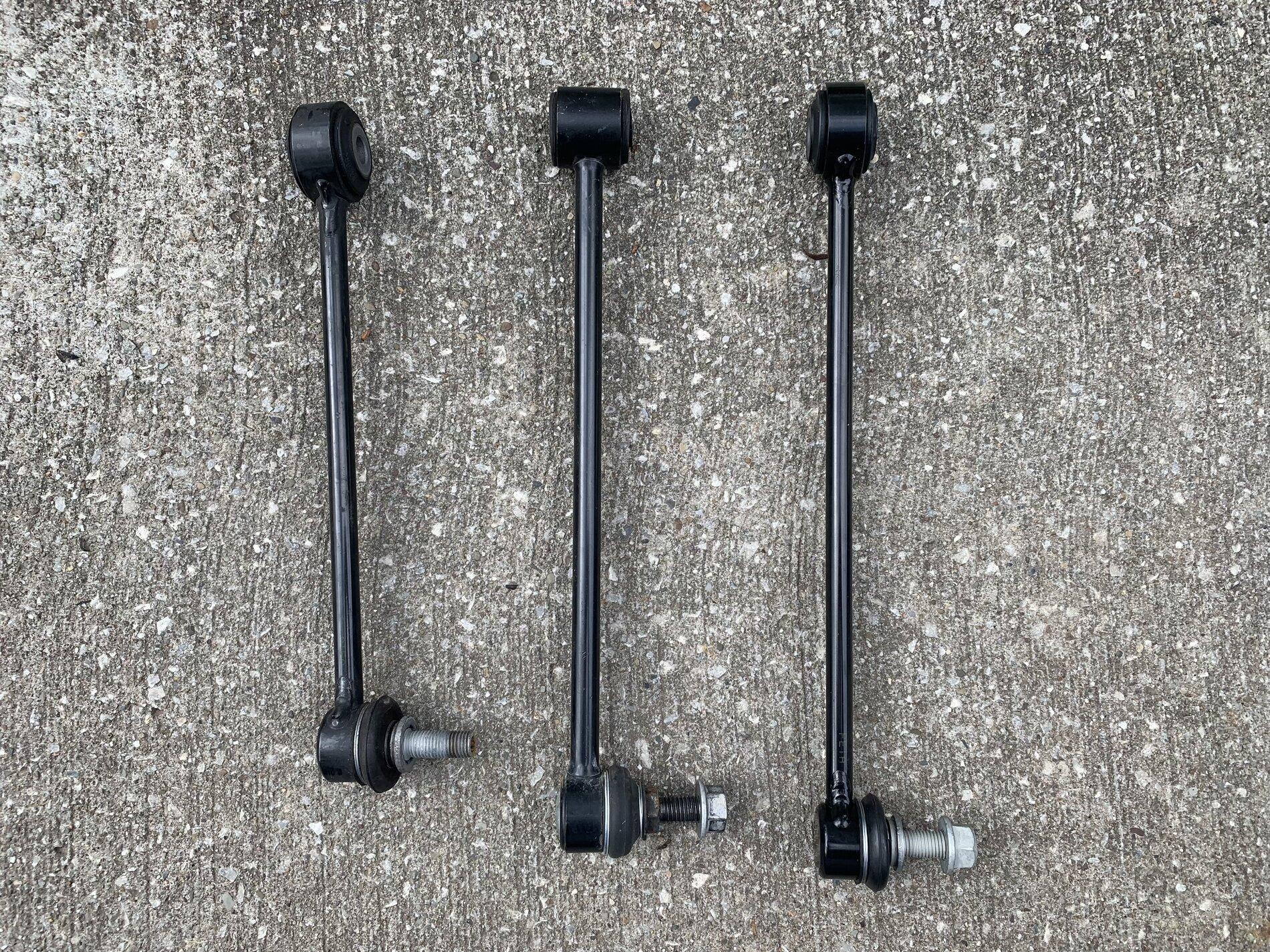

I was missing one of the rear sway bar nuts so I left the AEV sway bar links in place until a new pair came in. Today I installed the Rear Mopar Links.
From left to right is the stock rear link, the AEV link, and the Mopar lift kit link. As you can see the Mopar lift kit link is beefier on one end and slightly longer than the AEV link.
Both the Mopar and AEV lifts result in 2” of lift so you would assume they would be the same length.
When you consider the larger diameter shocks and stout sway bar links this lift kit continues to impress.
